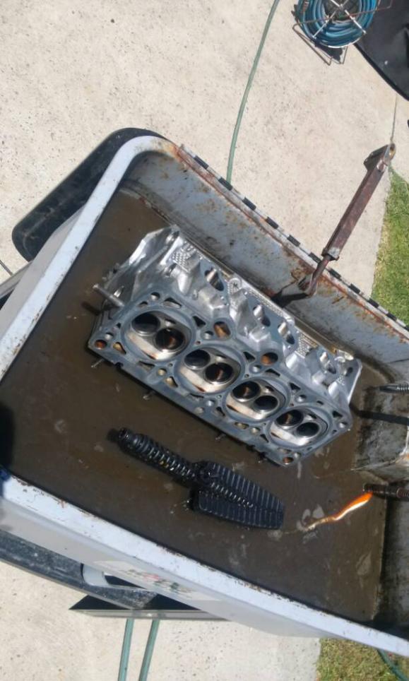

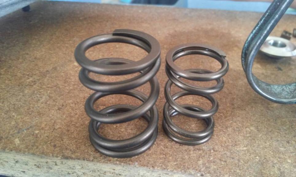

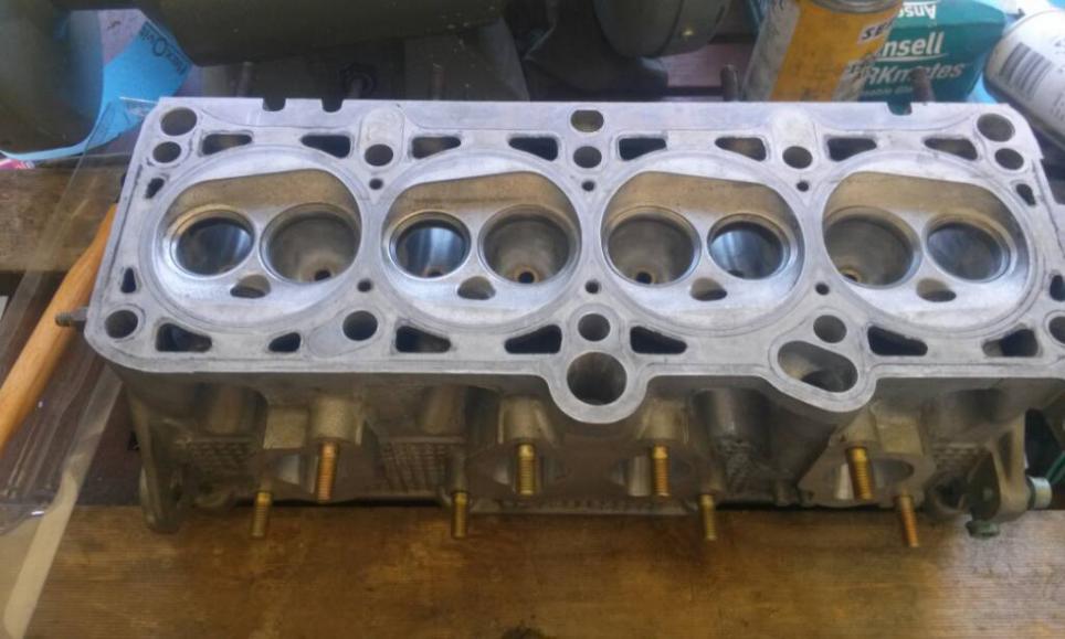

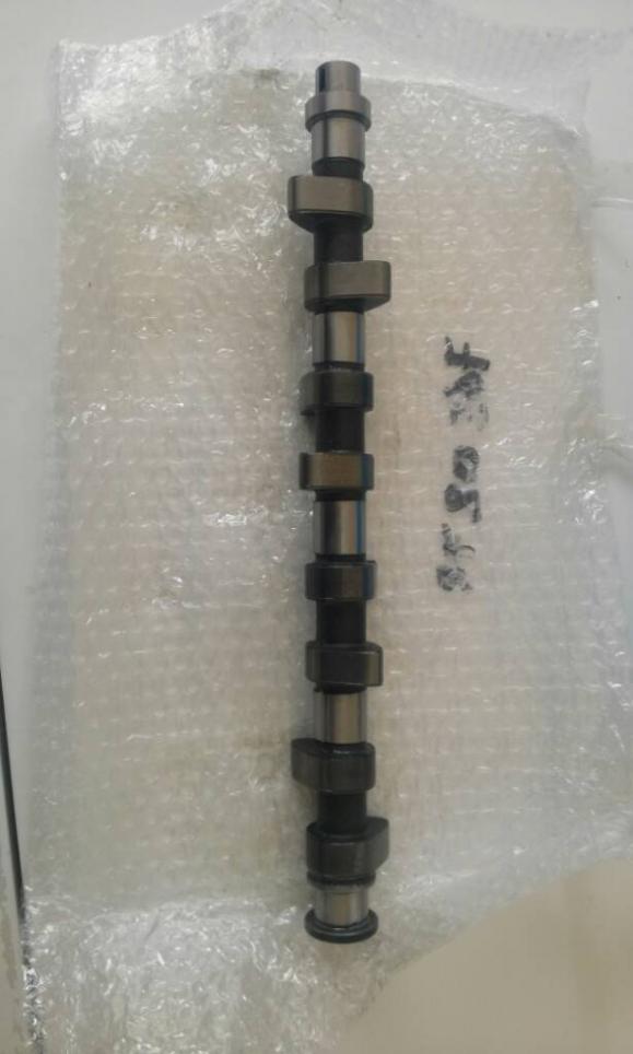

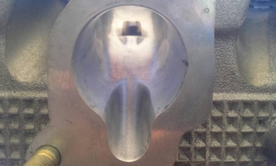

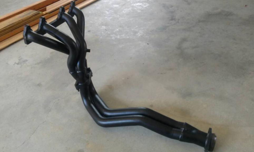

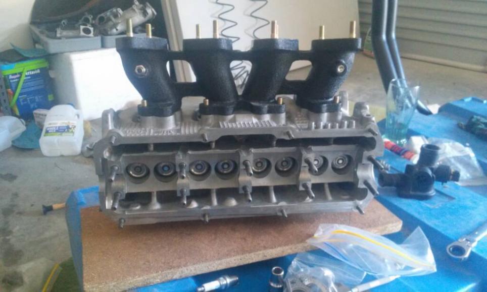

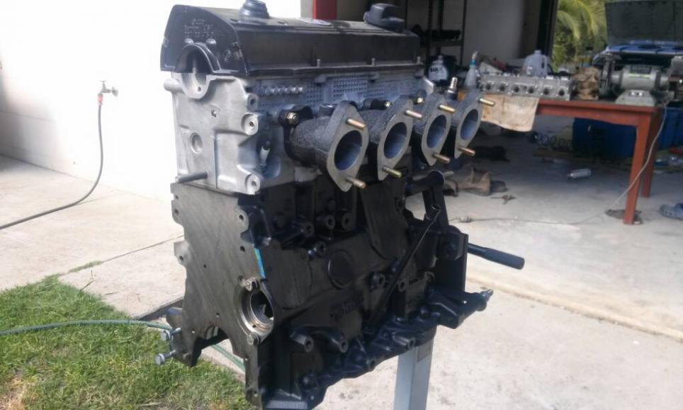

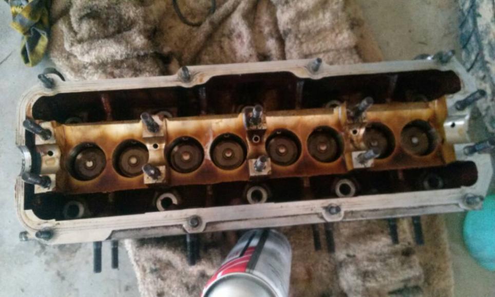

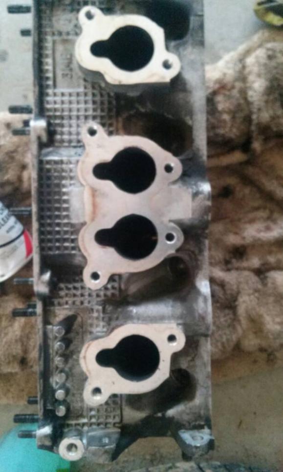

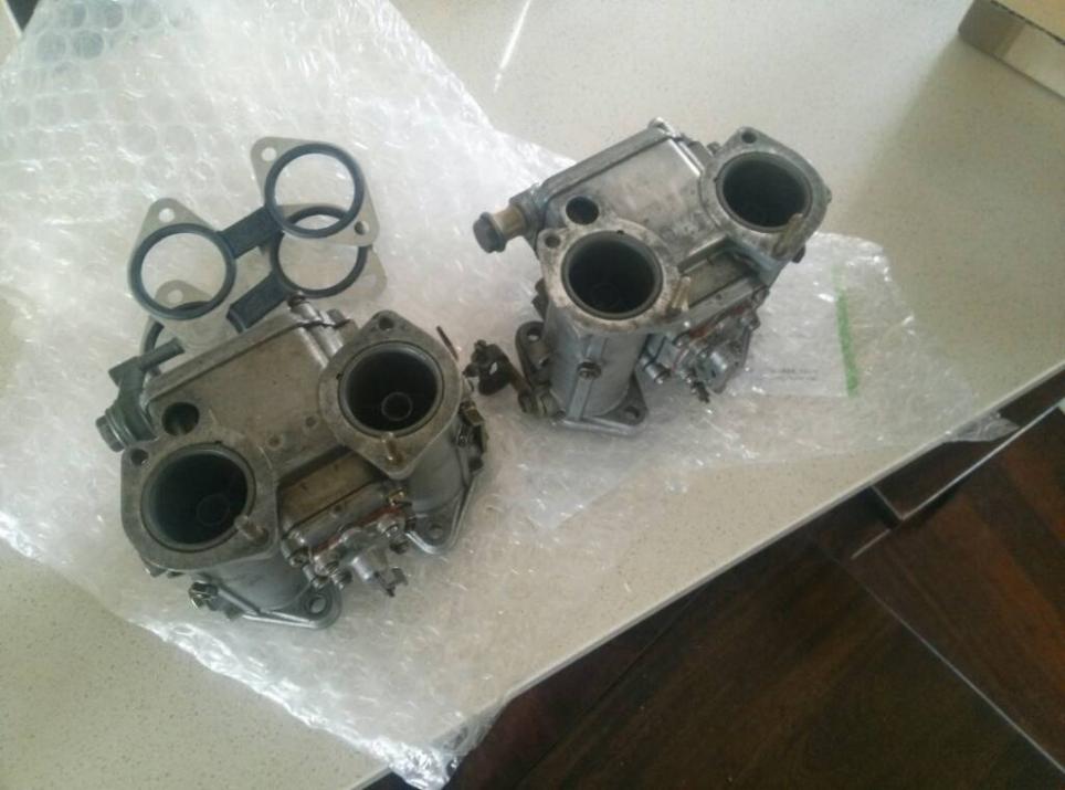

          It's time I let you in on a secret of mine. My little bunny is getting a new heart some time in the next couple of months. I stumbled upon a crossflow, external water pump block know as an AFT out of a 99 Cordoba late last year, and have slowly been putting parts together to get this thing ready. I'm almost ready for the big day, so I thought you should all informed of the journey so far.A little dirty. Time for a bathAnd a home botch port jobPartner her with a 280 hydro Cat Cam, and some Autotech HD valve springsAdd on a Rowland manifold (home painted)ExtractorsJust time to sort out the pair of Dellorto DHLA 40s going on it.Still have to organize distributor and associated ignition, alternator to fit under the carbs, offset radiator and a couple of other bits and bobs before the conversion can go ahead.
          This is an exciting time for my bunny...

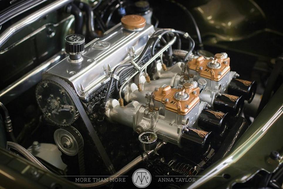

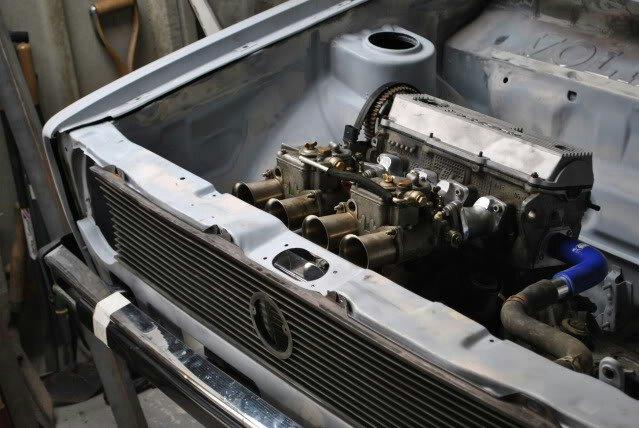

            So it will look like this when it's finished?

            Taken from here in case you haven't seen this one.
            http://www.clubgti.com/showthread.ph...45-carbs/page5
            Yours will be something special when it's done!
            Cheers
            Paul
            • #66
              [emoji15] Nice engine! I'd be stoked if it looked like that. Here is my main sources of inspiration though...

                Cheeky little mock up today with the freshly painted block
                77 Mk1 GLS 2 door - That sinking feeling
                76 Mk1 Swallowtail 2 door - Replace that BMW & 76 Sweetheart
                • #68
                  Does all the water and oil galleries line up from the head to block?
                  What head gasket you going to use?
                  • #69
                    Geeez! Loving how different this is! Wasn't aware of any crossflow 8v engines.
                    What's the displacement?
                    • #70
                      It's a 1.6 with the 81mm bore that all the 1.8s came with. So it's very simple to stroke out. I'm leaving it as a 1.6 however, due to short stroke, it will love to rev
                      It's a factory head for the block. No modification required. It's a shame how rare they are in Australia, but it does give me some ner ner value haha
