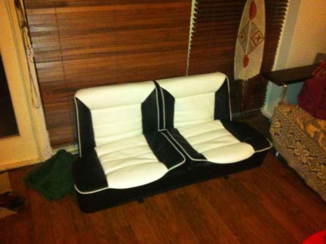

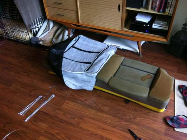

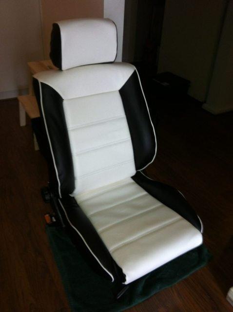

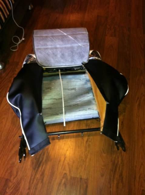

So the cars been sitting idle for a few months as I couldn't afford the ridiculous price of a new starter motor in this country but I picked one up (new for £35) in uk got back Friday and chucked that in straight away.
Following that got right on to fittings new interior:
Looking good, just a bit worried about keeping the white clean?!
