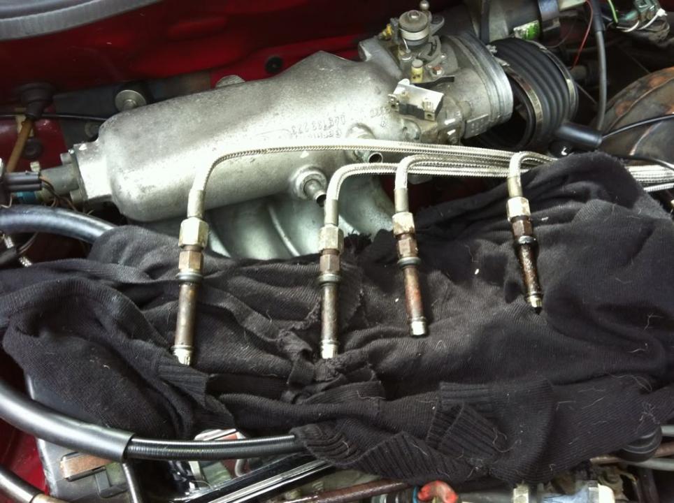

I use a long large screwdriver and lever against the rocker cover. The flat end of the screwdriver needs to be positioned under the fuel line nut if you can get it. Otherwise go between the nut and the ferrule at the end of the braid.
Apply firm consistant pressure downward towards the front of the car on the screwdriver, use your other hand under the injector to stop the driver pushing the injector towards the inlet manifold. they are a bugger with old dry seals but they will come. Careful you dont stab yourself with the screw driver as well... maybe I should do a video ??

I had a mechanic friend look at it during the week to see if he could get them out, he said he'd never struck one this hard and I was on my own for this one! So I'm not expecting much luck.
