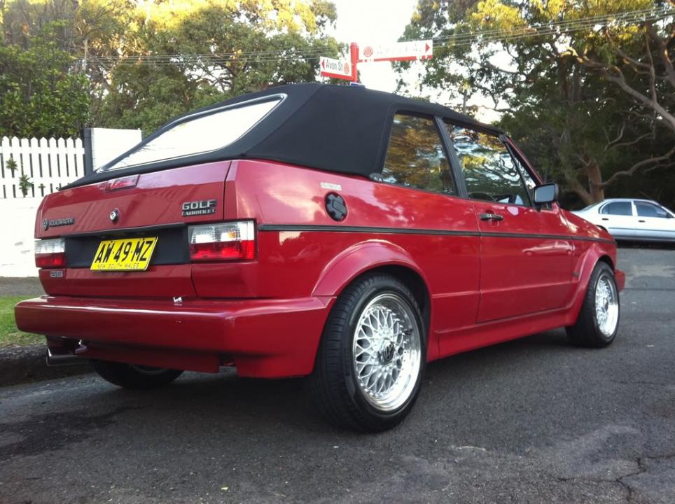

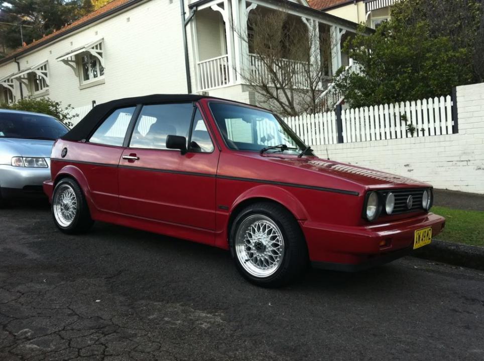

Hi everyone, so I thought I’d finally start a thread for my Mk1 Cabriolet. Some of you may know me from club meets and previous posts.
I’ve got some issues at the moment and I’m hoping there’s someone out there can help me find the solution to my current Mk1 woes.
Ok, brief history of “Felix” my red Mk1 Cabriolet. (1990 1.8ltr, K-Jet). Called Felix after my brother who was born in Osnabrück in the same year it left the Karmann factory.
I’ve had it for a few years now and it my daily drive, i've also driven across most of East & South Australia in it.
Work done to Date:
- Cylinder Head Ported
- Techtonics Tunning 266 Cam
- Heavy Duty Springs
- Jetex 2” exhaust with Straightline Performance Extractors
- New Mohair Roof
- Some chrome parts - hoping to do more
Planned for the next couple of months:
- Rear disc brake upgrade (ship with all my parts arrived today and they're waiting to be picked up from Mascot)
- Re-trimmed interior (planned to be completed after christmas)
And a few pics:
[IMG]<a href="http://s772.photobucket.com/albums/yy6/eddieppe/?action=view&current=7914eee7.jpg" target="_blank"><img src="http://i772.photobucket.com/albums/yy6/eddieppe/7914eee7.jpg" border="0" alt="Photobucket"></a>[/IMG]
[IMG]<a href="http://s772.photobucket.com/albums/yy6/eddieppe/?action=view&current=d2bf9113.jpg" target="_blank"><img src="http://i772.photobucket.com/albums/yy6/eddieppe/d2bf9113.jpg" border="0" alt="Photobucket"></a>[/IMg]
