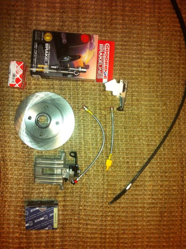

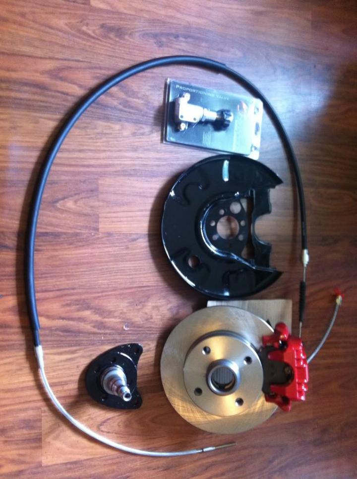

    Now it's time to get excited about the rear disc conversion.Sadly it will have to wait till after Christmas but here's a sneak peak: 👍

      You baller, new calipers! haha.
      Have fun fitting them, it is not a hard job, you should be able to do it in a couple hours with time to spare for a beer...
      Did you import this stuff or get it local?

          Yep all new stuff, no messing around with other peoples seconds. I got it all in UK when I was over earlier in the year then put it all in a sea freight box back over here.

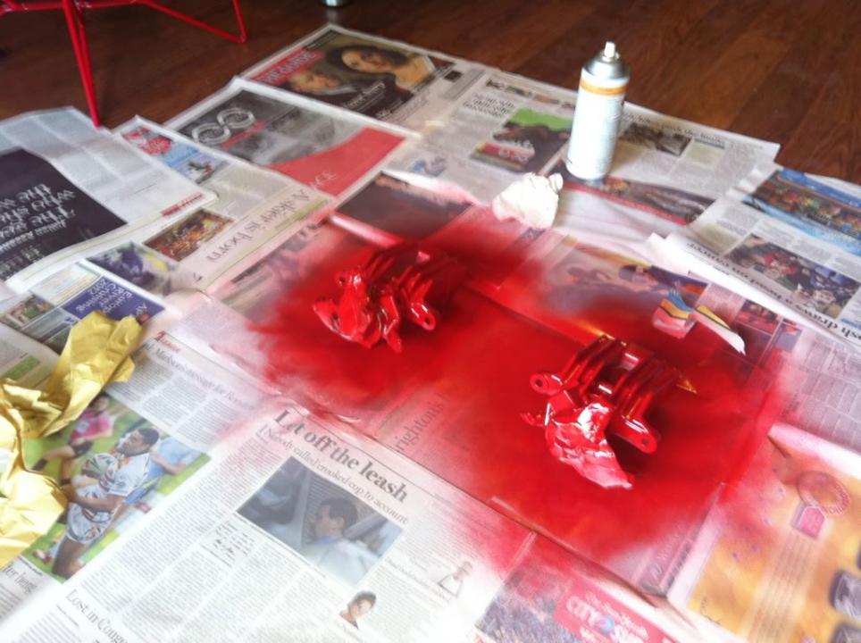

          Got to spray the calipers red first to get them looking sexy!
            Extra 25kw right there !!

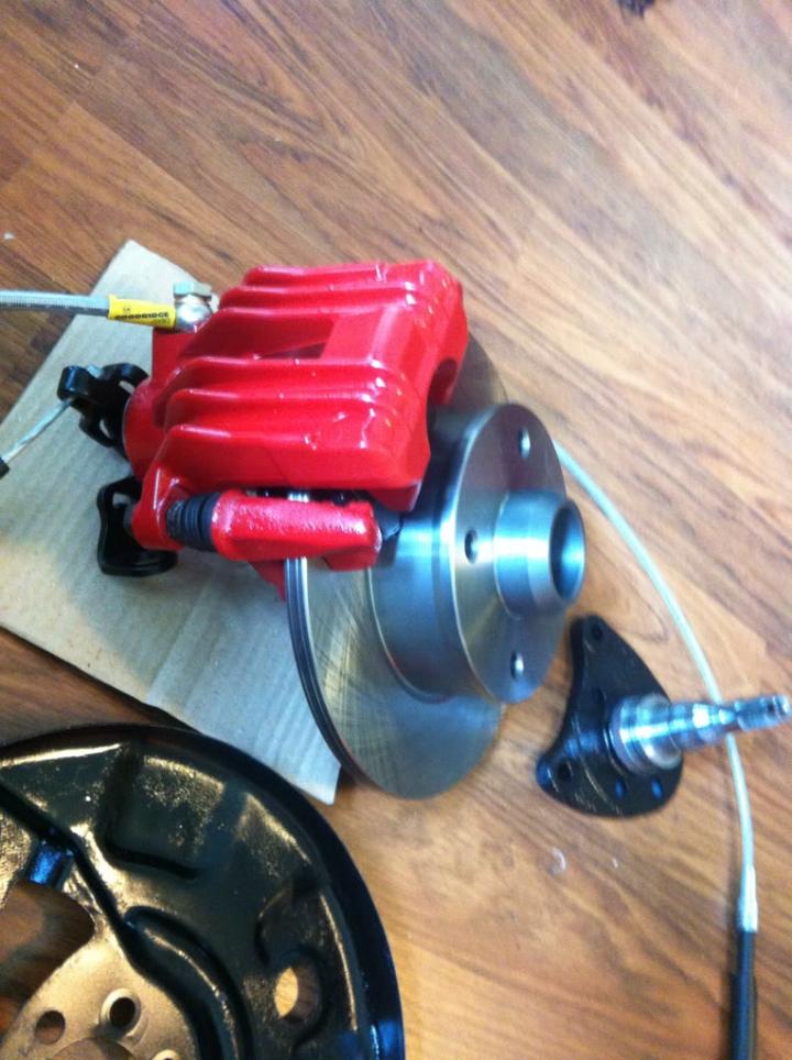

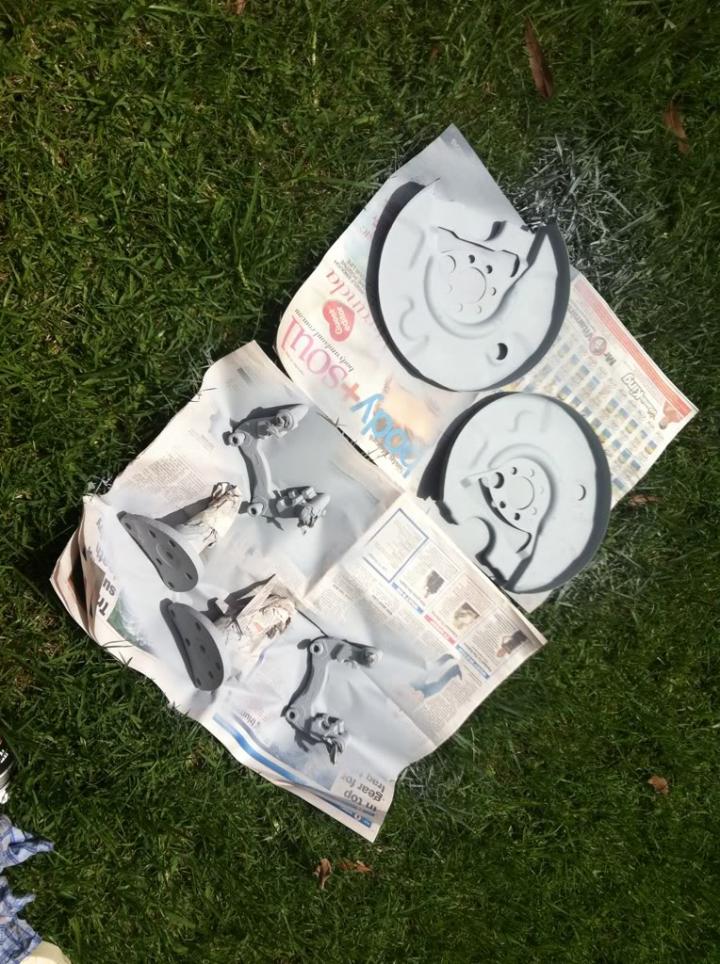

                A bit of cleaning and re-spraying and the brakes are ready to go in, hopefully next weekend!

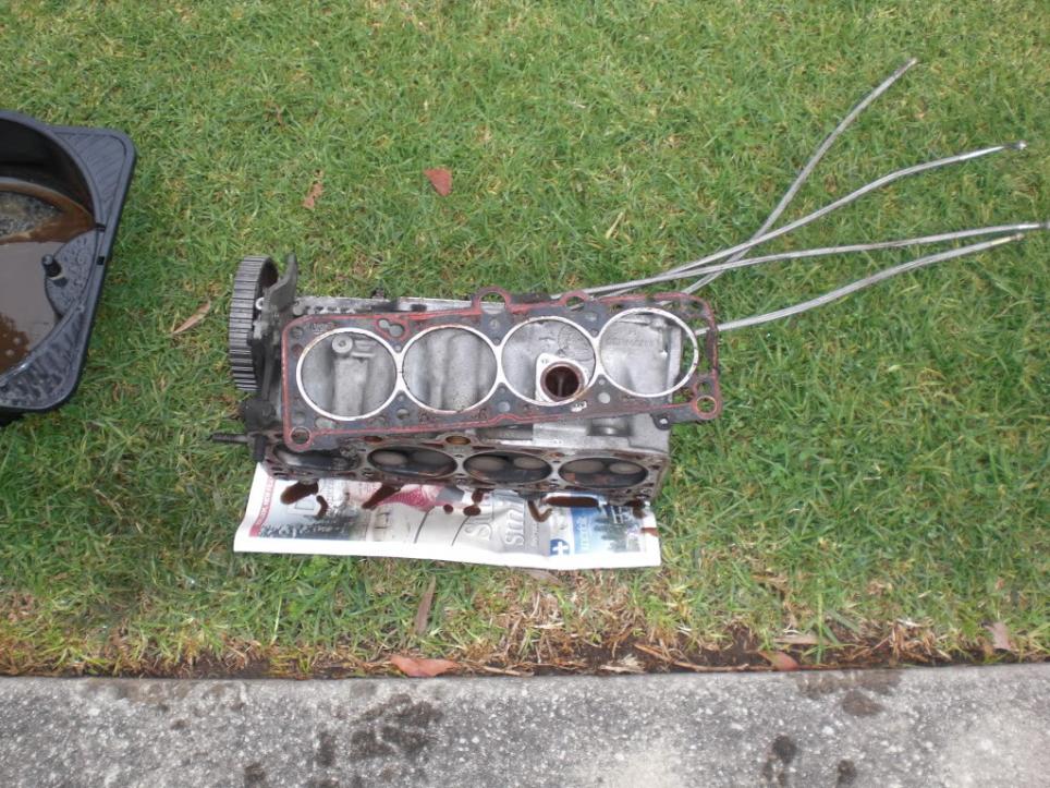

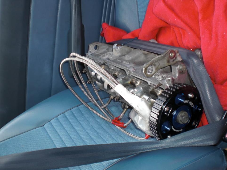

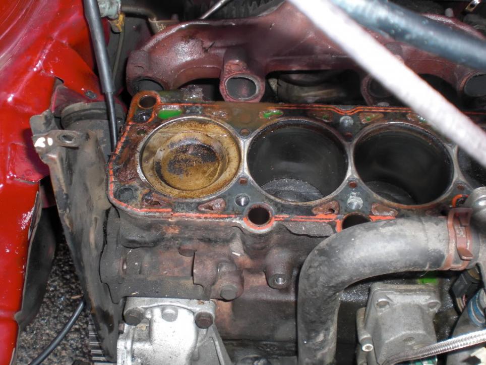

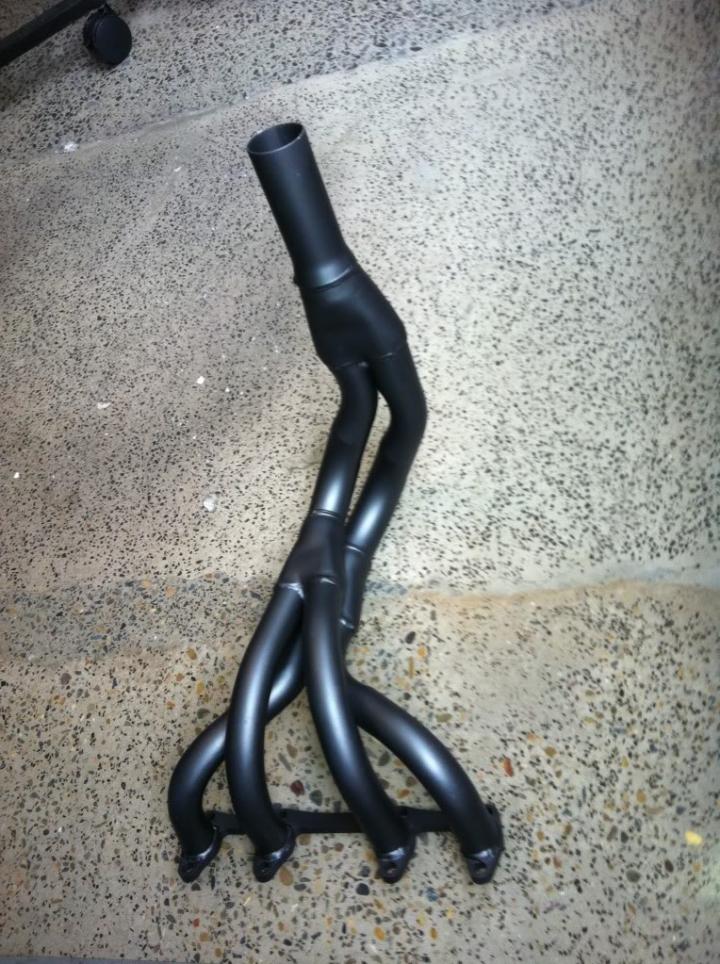

                    Here some history pics of previous work carried out:
                    Blown head gasket;
                    Head strapped in the passengers seat returning from being ported:
                    The extractors that cause me so much grief:

                      He guys I got started working on the brakes yesterday I was planning on running a single bias proportioning valve from the master cylinder but there are two separate hard lines. I assume therefore i would have to run two bias prop valves and keep the lines separate?
                      • #41
                        yes you should because the system is supposed to be diagonally split on a mk1.

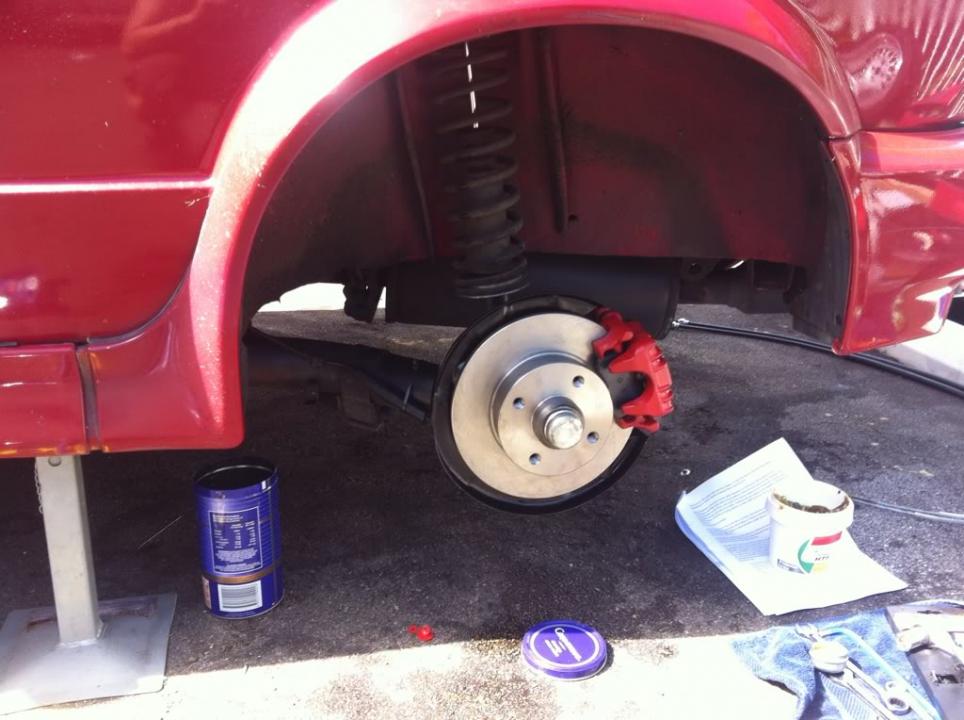

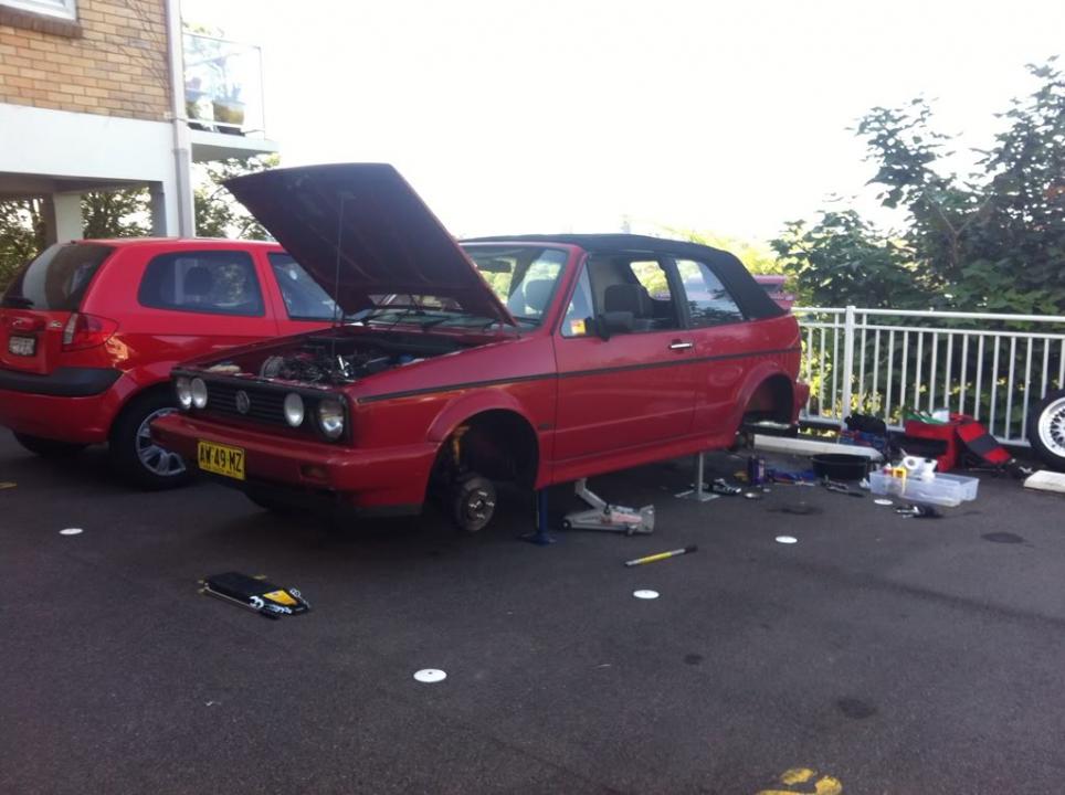

                                So after a while off the radar for various reasons I won't go into. I've finally managed to get round to installing the rear brakes with one little issue.
                                Here's Some pics of todays efforts

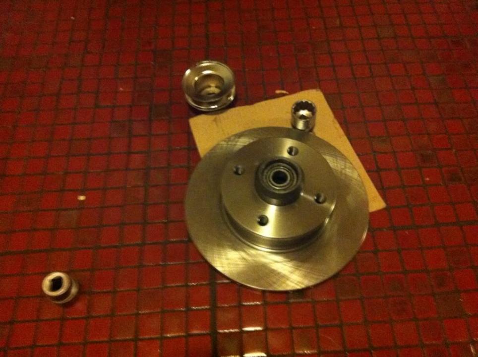

                                Push the bearings in:
                                A beautiful day to work on the car:

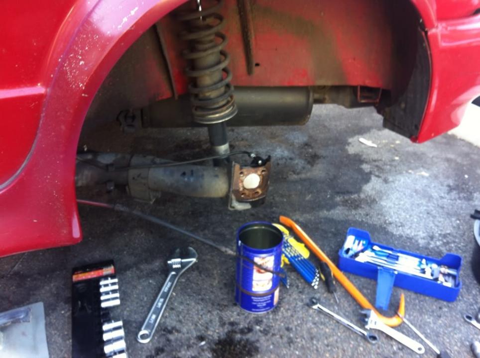

                                Out with the old;

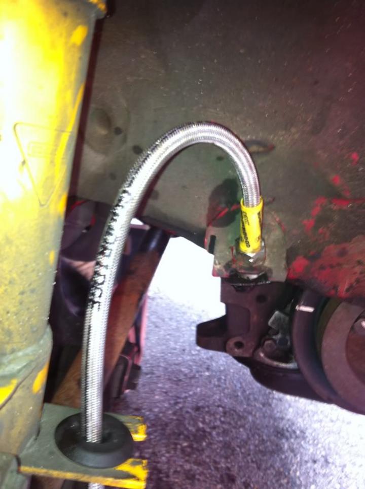

                                In with the new:
                                Then I broke one of the solid rear brake lines.... Ops... long story but just wandering where the best place to pick one up?

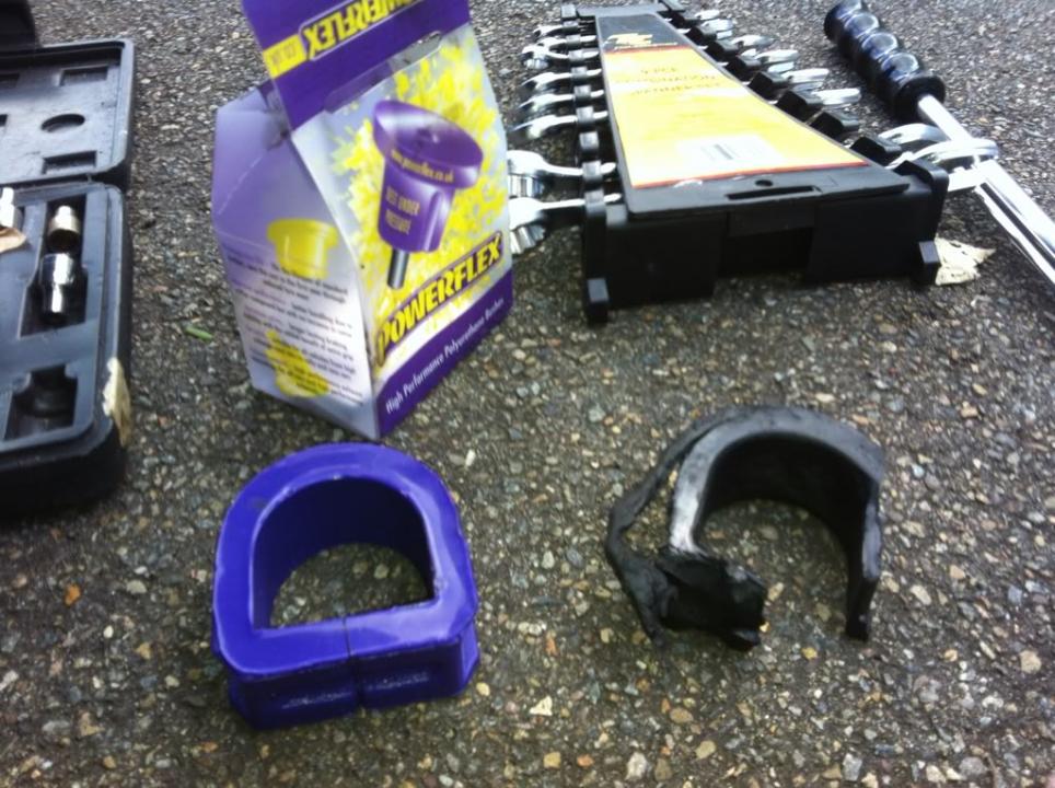

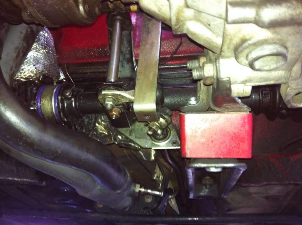

                                After doing all i could to the brakes I moved onto the next task of replacing the steering bushing with powerflex poly ones:
