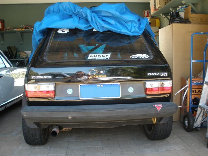

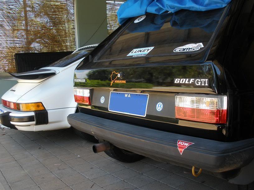

                    decided to fit some of the stash of parts i have lying around so the golf gets new tail lights and LED globes all round

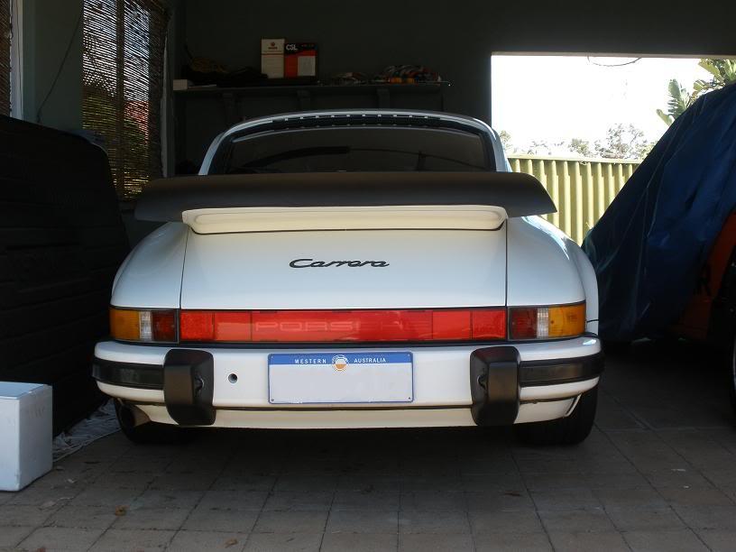

                    and for the hell of it you can't really ignore a peice of tail like this, the mistress that cnsumes the rest of my time away from the missus
                    next fit up the BIXENON headlights for light like the mk1 has never had before
