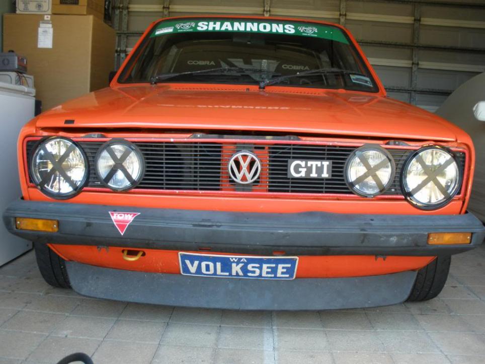

    Well the time has come for a bit of a performance increase for the rally golf, going to start slowly leaking info and pics as i build up the parts to give her a shed load more power, for now this will do to keep you interested.

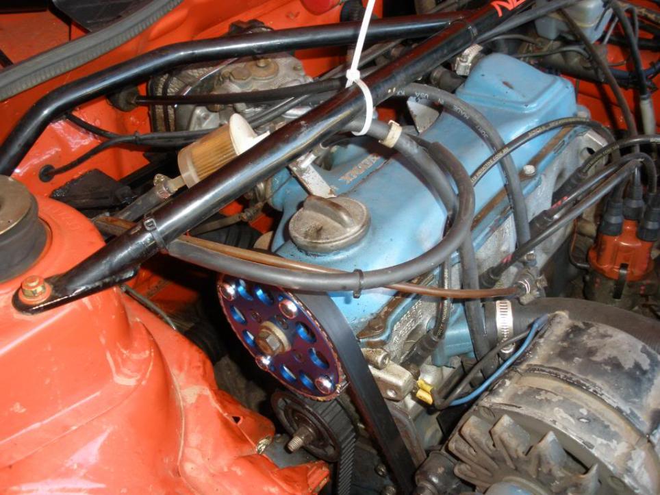

    The old girl as she was
    a must have after doing 20 laps of the famous green hell earlier this year
    The old power plant, 1.8 8V goodness worked almost as hard as it could over a 10 year life!, cracked it open last weekend and everything was still as new inside and you could easily see the hone swirls still on the cylinders, just had to replace a slightly burnt valve (have a worked heron head to go on to keep as a spare motor)

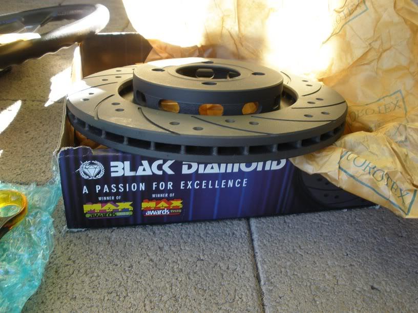

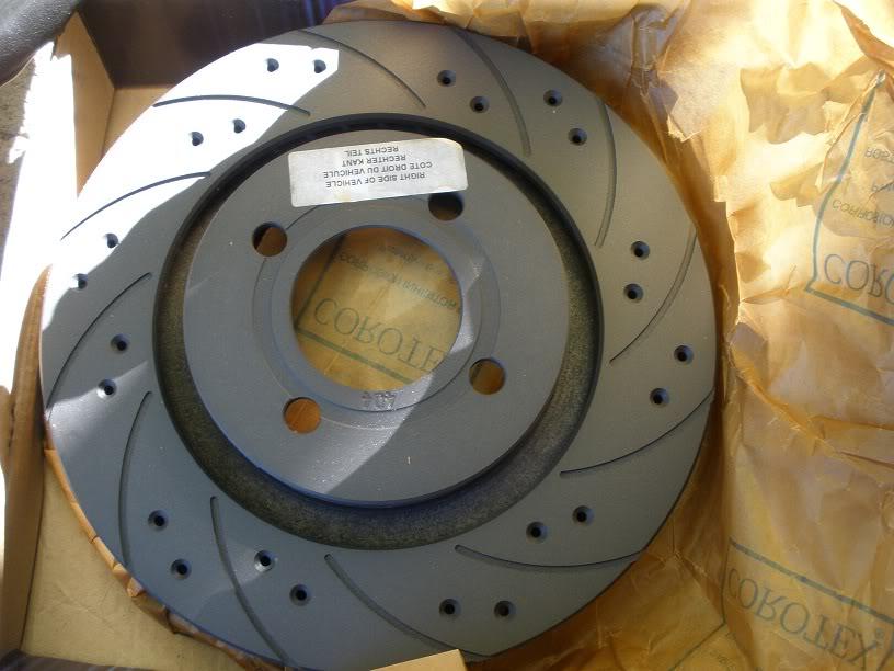

    Some better brakes than the current VR6 units
    just a little bit more stopping power to come

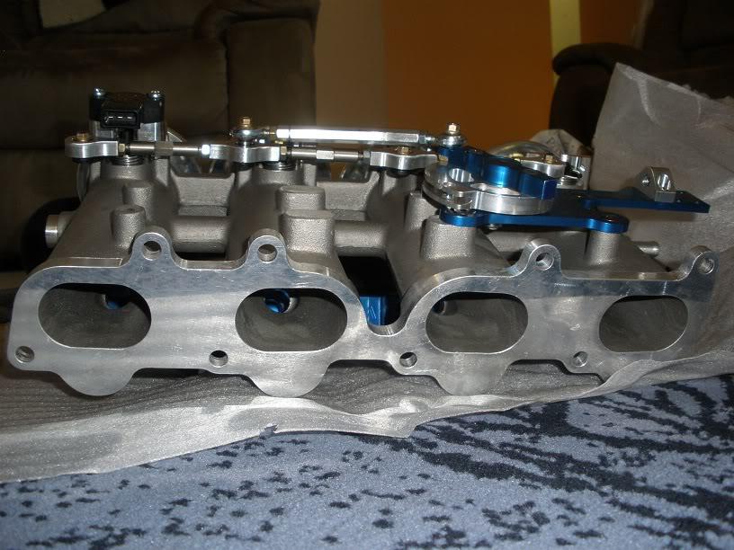

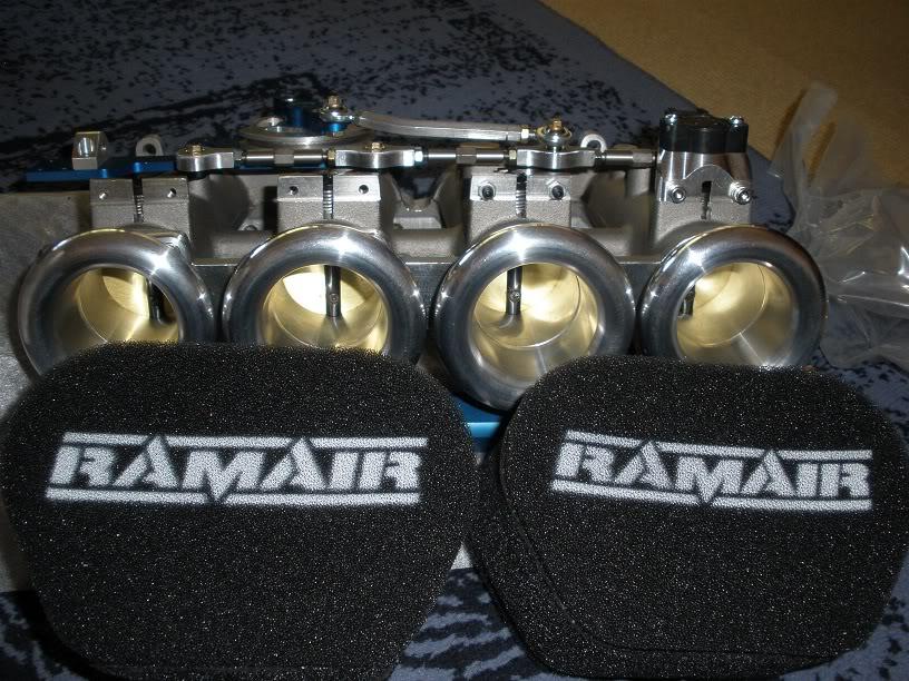

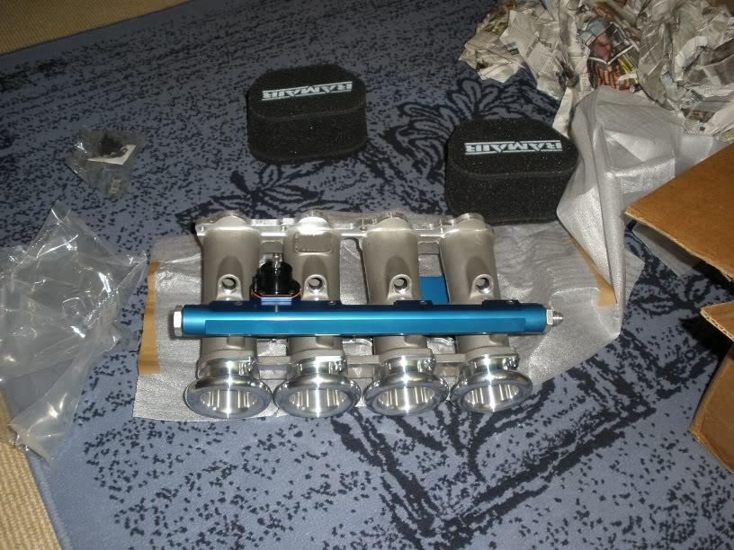

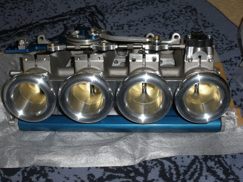

    Have almost finished building and modifying these to ensure the most fuel possible is converted to power, this took ages to build and was surprisingly cost effective to make. Those that know will recognise certain clues to the engine that they will be bolted too

        actually not that expensive, i bought the main manifold section and made all the rest so relatively speaking, cheap

          Very nice. ITB's on an 8v
          What brain will you use?
            ITB's on an 8v
            Look a bit closer .................................................. .................................................. .....
              Should I say 16v...
                  heh heh heh, don't give the game away too soon Grant. the head is almost finished so will be getting stuck into that soon

                      Are you using adaptors to bolt the Girling 60 calipers up or have you changed the hubs?
                      Pete
                      7? MK1 Caddy
                      79 B1 Passat Dasher Project
                      12 Amarok
                        this is where it gets interesting, using mk1 hubs that have been modified but i've setup a jig to modify others to suit mk2 and mk3 calipers, not very hard andrelatively cheap to do. Will look at making them available to members of the forum shortly
