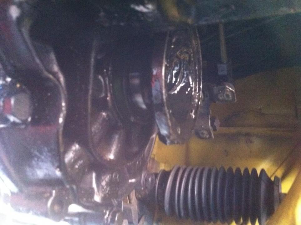

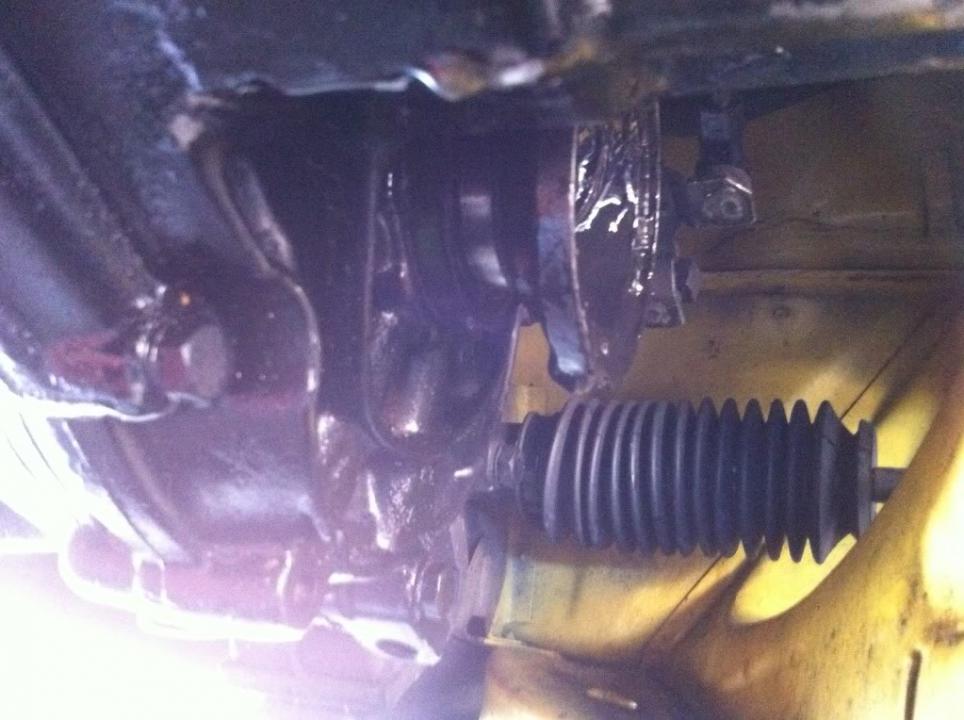

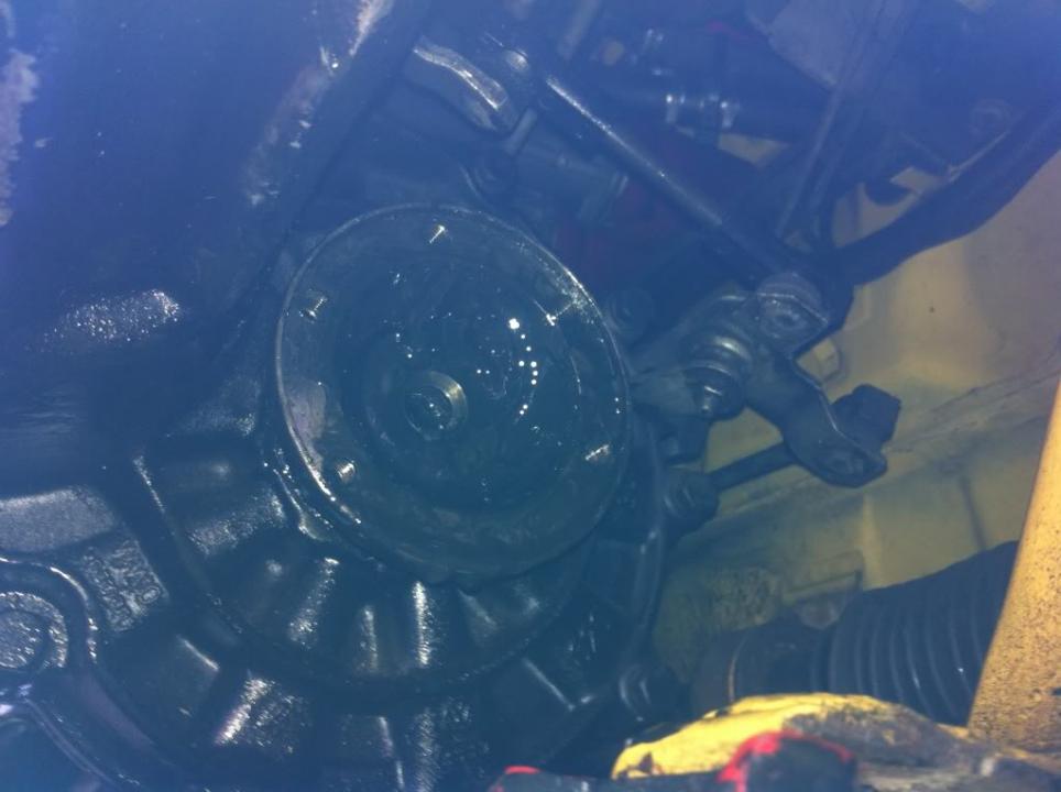

                        • so this is where i'm at this afternoon...noticed the passenger side drive shaft had some play and on closer inspection realised the flange was coming away from the diff...when i removed the inner cv joint the centre flange allen key was completely loose, which was the reason for the play and oil leak from round the flange.
                          now it's a matter of getting the flange back in against the spring load in the diff and tighting the allen key. any advice as to how best over come the spring loaded pressure? also, would it be worth while using some lock tight on the centre allen key? advice appreciated! thanks!...
                          • Thread locker is a good idea. I'd use the medium (usually blue) in case you need to remove it again. Red's a bit much.
                            Not sure on how easy it is with the mk1 but on an mk6 the easiest way is to use a prybar against the block to push the axle in then get the bolt started by hand. Once the bolt has gone in a few threads then I usually use a 3/8 impact gun to do it up the rest of the way. If you don't like tightening it with an impact gun (or don't have access to one) you can put a couple of the axle bolts into the axle and hold it from spinning with a pry bay while doing up the bolt with a torque wrench.
                            This is the way Steve showed me how to do it.

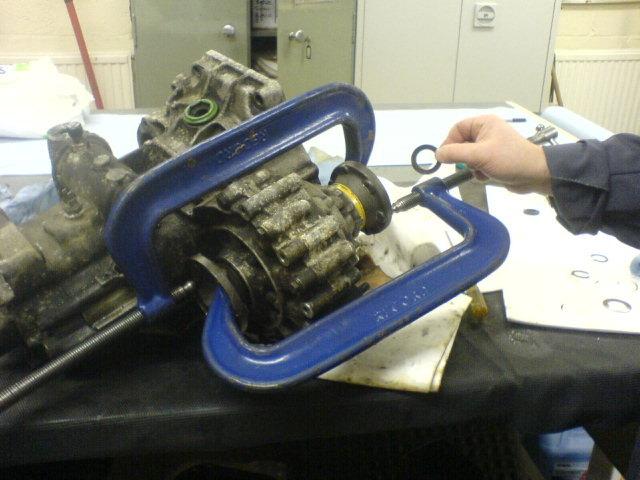

                            • Must be a 4 speed? The 5 speed ones are retained with a circlip.
                              I've seen a press used to seat the flanges but that only works if the box is out of the car.
                              Here's another approach. (Image is from 020 Flange )
                              7? MK1 Caddy
                              79 B1 Passat Dasher Project
                              12 Amarok
                              • If you use Loctite, any of the 200-300 range will be fine. Don't go higher than that or you'll never get them undone.
