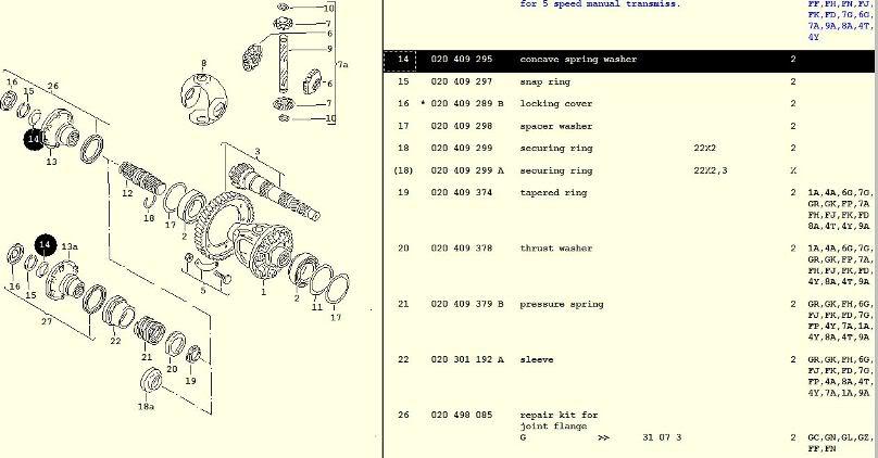

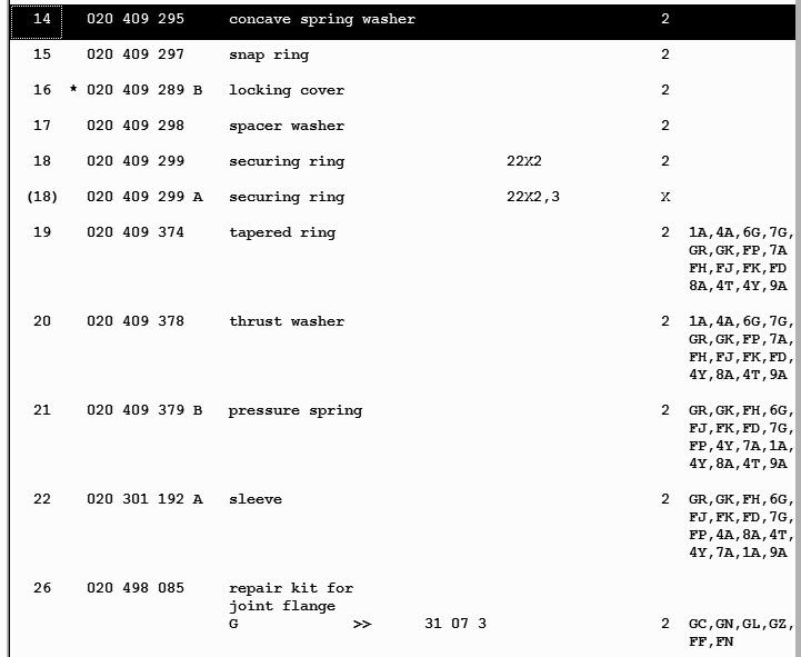

      pete, with the concave washer, i'm having trouble finding it from a dealer (or anywhere for that matter)...can i use an aftermarket washer? oe will this change the load that should be placed on the circlip?
      by chance, is there another part number to the washer, because it seems to come up as a seal in the dealership parts systems....
      cheers.

          • I found this place by Google'ing the part number Diagram 27 VW Rabbit, Jetta, GLI, Golf, GTI, R32 / Differential
            Looks like 020 409 295 is the one to ask for.

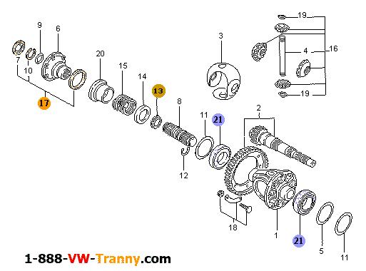

            • I know its probably a bit late, but the PO obviously fitted a Pelolok kit from Peloquin diffs. I have fitted this kit myself and it is pretty good for the price. However, it appears the PO didn't put the circlip back in as they should have (and a new one is even supplied in the kit!!)
              Peloquin Transaxles
              • she's back on the road...thanks to all for the help! definately learnt a lot doing the job and so far after a good run all is still in place and the box no longer drips oil. now time for a blaaaht

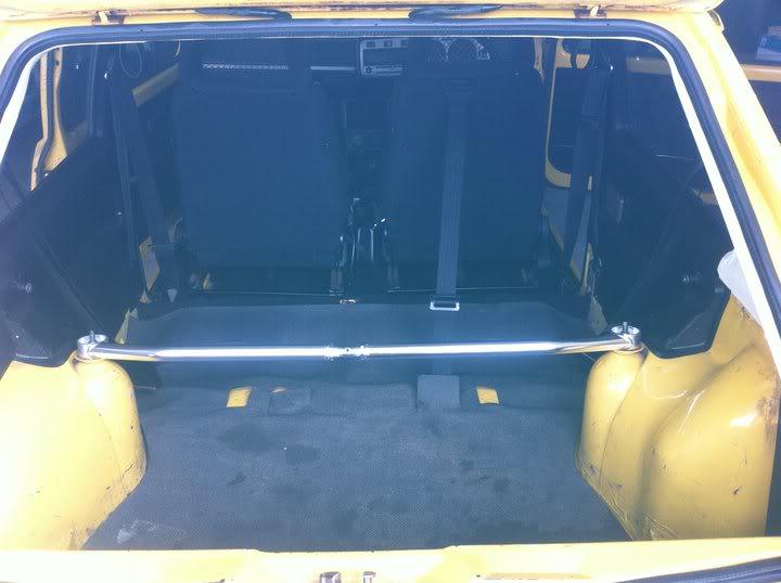

                      • there is something about driving around with a harness, two seats and a empty rear cabin...the car pulls so much harder with the extra weight...i think when i get a full time job (end of the year) i will strip the interior, get two sparco race seats, two momo harnesses, a cams approved 1/2 cage, massive front brake upgrade, semi-slicks all roung and put in the worked 2L i have lying about and have a dope weekender/track car! hmmmmmmmmmmmmmmmmmmmm
