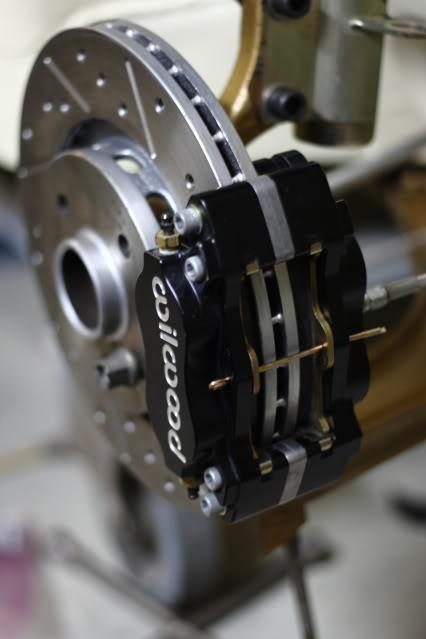

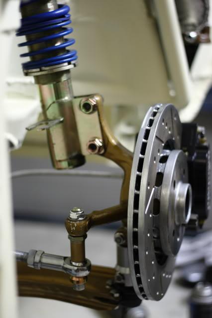

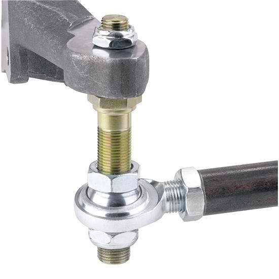

Just a little heads up on using a corrado bearing housing, it will allow you to take that extremely long steering joint bolt out of the picture, ( huge bending load being so long ) and bring the bolt length back to manageable loading limits. Also has a larger wheel bearing ( last longer with the low offset wheel specs)
VW Performance - Autotech Sport Tuning: Corrado Steering Knuckle, Spindle right
