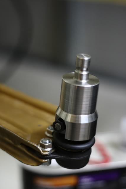

    The tie rod extender mounts to the hub with a taper so it is solid on the perpendicular plan to the hub, acting as a peg, the rose joint gives the movement needed for in and out ( steering)and up and down(suspension) but only by swiveling.
    Hope that helps.

    • FYI, it does put a lot more force on the bolt being that long (load-fulcrum-effort deal). But plenty of people seem to do it (and get them engineered like it) so it must be ok.. I guess.

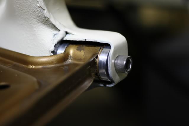

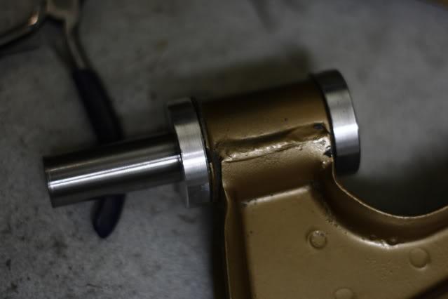

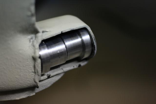

                        just wondering with those steel bushes, you don't require some flex in those components when cornering hard or going over bumps to reduce the load on control arm joints/chassis welds etc?
                        • Thanks
                          Just got the wheels out in the light of day, and as I am doing with everything reassess and tweak.but I was happy with the centers , but thing change.
                          Alloy bushes, with a steel sleeve( not pictured) am unsure of the result but less roll is less roll, proof shall be in the pudding as they say,I know one thing it's gonna be one super tight ride.

                            • I would have used Lubron I reckon. But that's just a thought.
                              • did toy with that we have some self lubricating polymer to boot.
