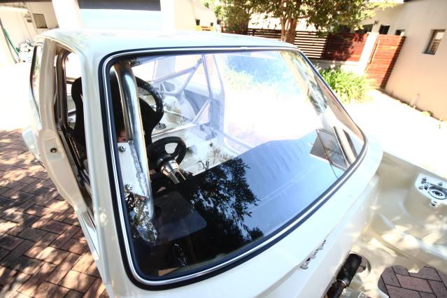

            • front glass in
              man what a pain of a job , serious

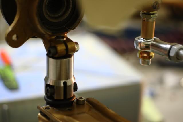

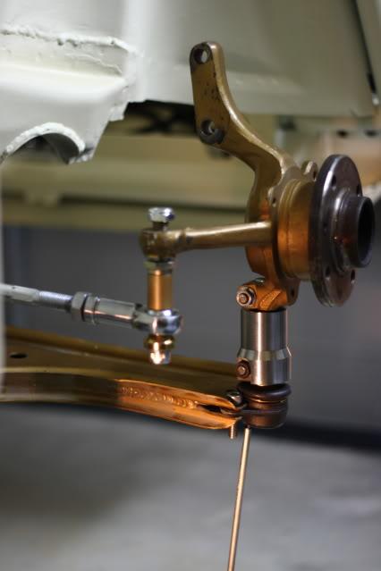

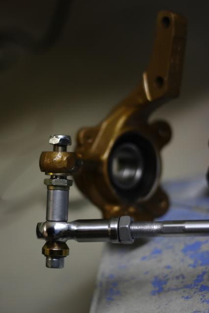

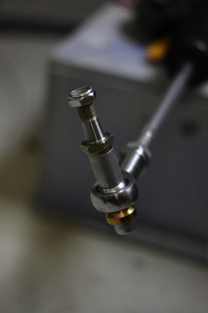

                      • with a little advice from preeny finished these off.
                        Originally posted by Preen59
                        • looks pretty,
                          Be any flex in the steering the way you extended it? Trying to wrap my head around it, but i can picture is it moving left and right, Though im sure you have done your home work, so who am i to second guess you LOL
                          Keep it up
                          <space for rent>
                          • The tie rod extender mounts to the hub with a taper so it is solid on the perpendicular plan to the hub, acting as a peg, the rose joint gives the movement needed for in and out ( steering)and up and down(suspension) but only by swiveling.
                            Hope that helps.
