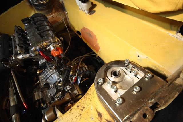

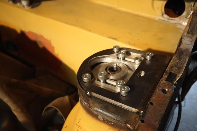

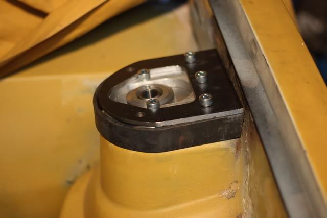

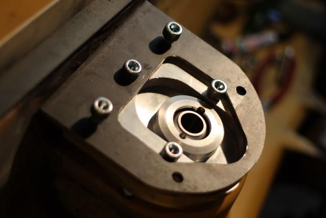

wasnt happy with the top mounts adjustment method so i have used the bearing mount and am building some of my own, and it gives me a good excuse to raise the towers a little.just need to slot some holes for adjustment

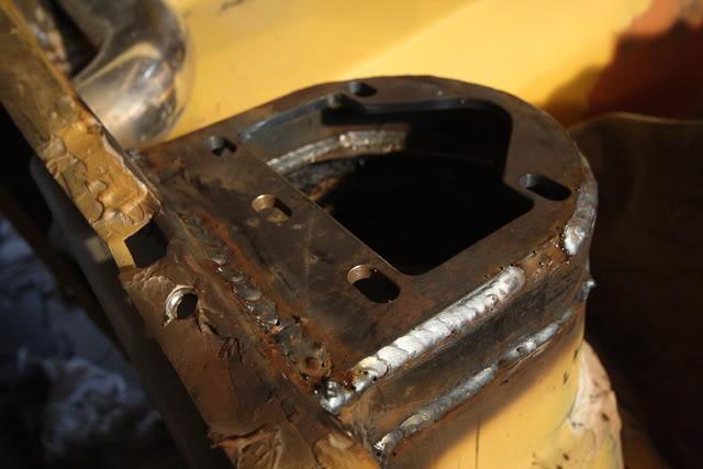

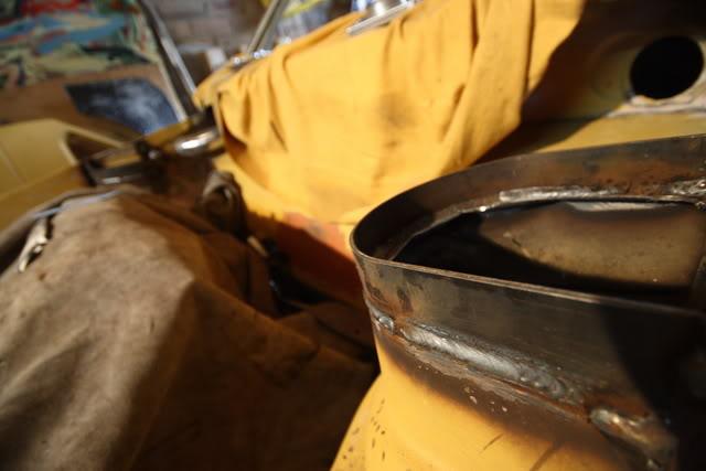

Looks good, Alex. Very neat. Good welds too, considering its a bastard of a spot.
a little more challenging as the engine was still in , it is amazing how well the cheapo ebay welder goes on full tilt, although i did trip the thermal several times, it runs remarkable smooth and steady
i did run two passes on some areas as the first weld rooted really nicely.
is that the one with switches for current setting and properly adjustable wire speed? they all seem to go for ~$100 on ebay?

yer i just hit it with a grinder,i would say up to 8 to 10mm easily it does pack a decent punch.just watch the gas as mine leeks like nothing and i have had problems with the feed and trigger switch but the gains far far outway the cost
