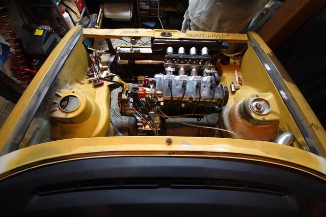

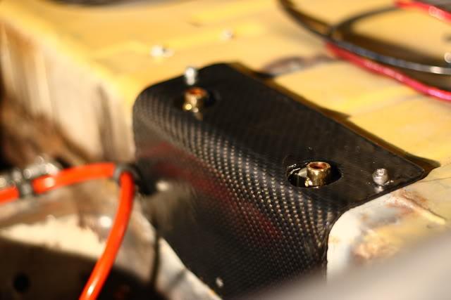

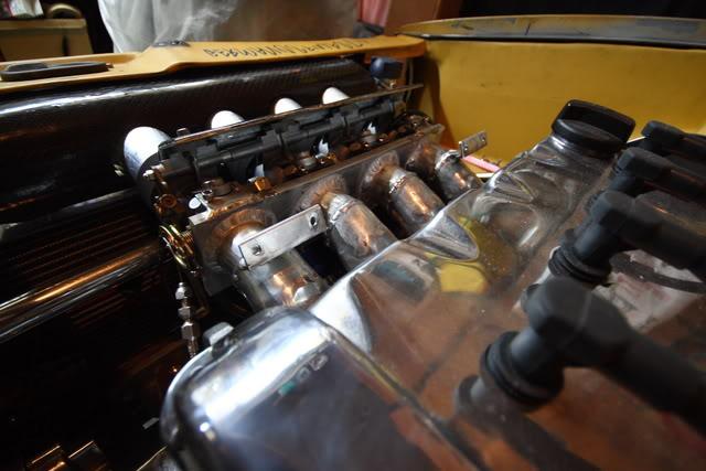

its all wired up, i redesigned the manifold for the throttle bodies so they connect in a better way than silicone pipes, they basically locate in a recess and seal via o rings .attached the carbon inlet and routed the rest of the lines.and painted bits n pieces
am really happy with the motor, just gotta get it out and do the diff and cams and clutch and so on and then finish the body work

Be careful with that - I found out the hard way that Carbon fibre is conductive! (and smells terrible when it burnsOriginally posted by alex g View Posti spy with my little eye a dry cell
