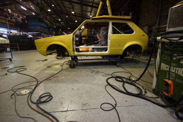

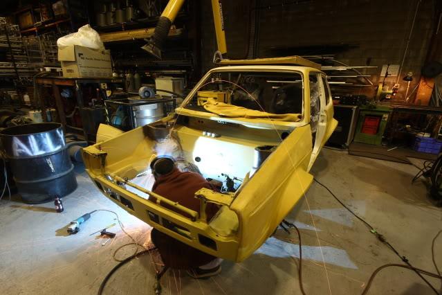

    and to another new home, and time has come to get painting ,well prepping to paint first
    nice to see you finally have some real space that isnt your driveway!
    • yer it's really getting there now, it makes things so much easier having #1 space #2 good tools(ie welder and compressor) and #3 proper access to the underside(ie fork lift)

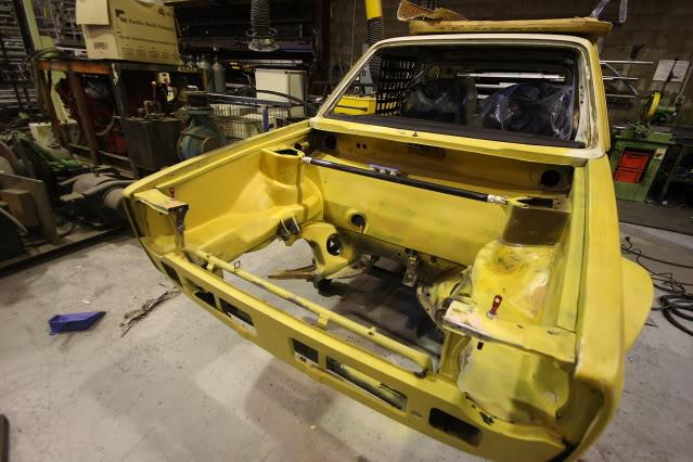

        • Great work alex!
          also, what is the yellow colour on the car? is it primer or epoxy paint?
          cheers
          Golf GTI 1980
          Golf GLS 1979
          • just a hi-fill primer

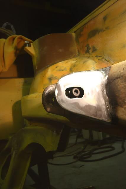

              • another shot from the other day just loved the arch on the splatter

                  • Nice work as always Alex.
                    Care to send me some specs on your frame you made up to sit the shell on? need to make one up and yours looks good
                    • made it on site under the car,was a mission, basically joined 2 H frames together(1 for the front ,which sits on the front mounts and one for the rear , which bolts up to the trailing arm mounts) the front wheels are straight and heavy rating (so fitting of engine is possible)and swivel rear wheels to take up the slack and aid steering

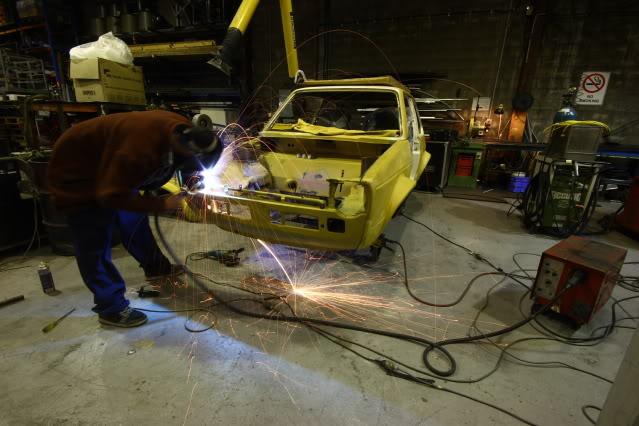

                        • have been kicking goals

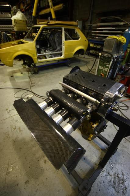

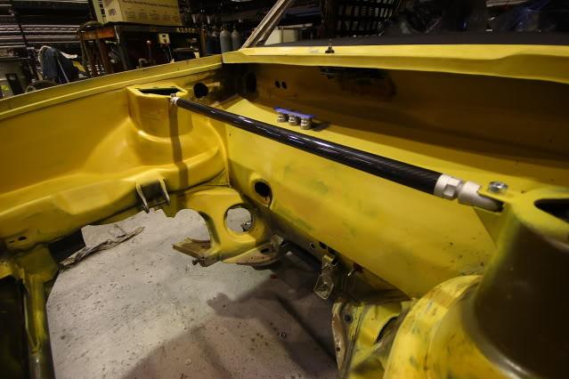

                          • Ooooofffff!!
                            Wow, that last pic speaks volumes about your attention to detail, Alex. One mahoosive airscoop wrapped in carbon fibre no less and hooked up to the cross bar between the headlight enclosures (if I'm not mistaken) makes for a pretty sexy looking engine bay! I've seen a few Mk1 engine bays and this will be truly one of a kind. Can't wait to see what your grill's going to look like too. Amazing, patient work there.
