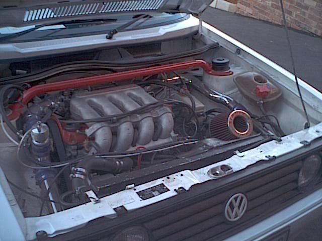

                          Not sure if this is any help but a Barina radiator fits nicely under the slam panel.
