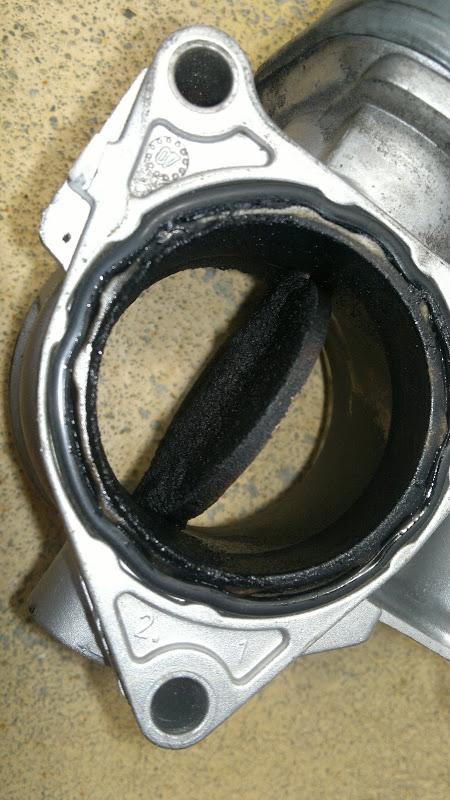

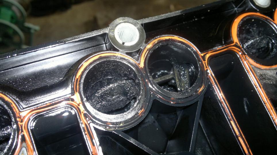

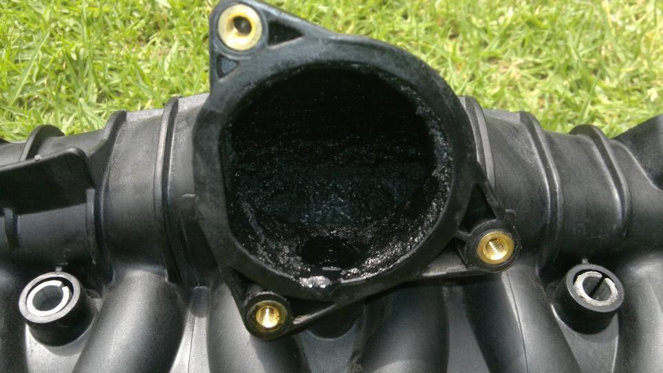

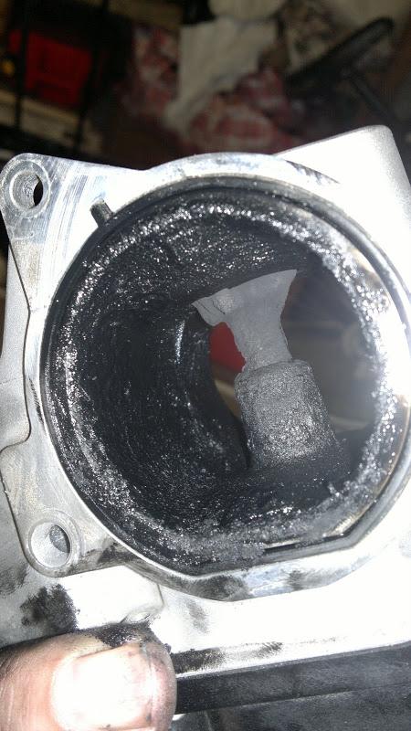

                    and it's all off!
                    I actually used a T27 torx bit and it worked like a charm.
                    My valves are pretty clean I thought. Will post pre and post pics later today
                    ---------- Post added 16-11-2011 at 12:16 PM ---------- Previous post was 13-11-2011 at 02:21 PM ----------
                    Here's my findings.
                    The intake flap was nowhere near as bad as I thought but the EGR valve could have been worse. Because I couldn't soak stuff overnight I didn't get them back to shiny/smooth but removed all of the dry caked on soot. As for the inlet manifold I got most of it out and most it off the tumble flaps. Pretty good for 120,000km
                    I did notice two of the pieces which guide the tumble flap rail and popped out. Pushed em back in easy enough...
                    I also fitted the EGR gasket with the smaller hole.
                    The cars isn't faster but it's boosting stronger. Even on Monday, when it was well over 30 degrees, it boosted like it would at 20 degrees.
                    Greg, would it be the EGR gasket is now burning proportionally more oxygen and it going better?
