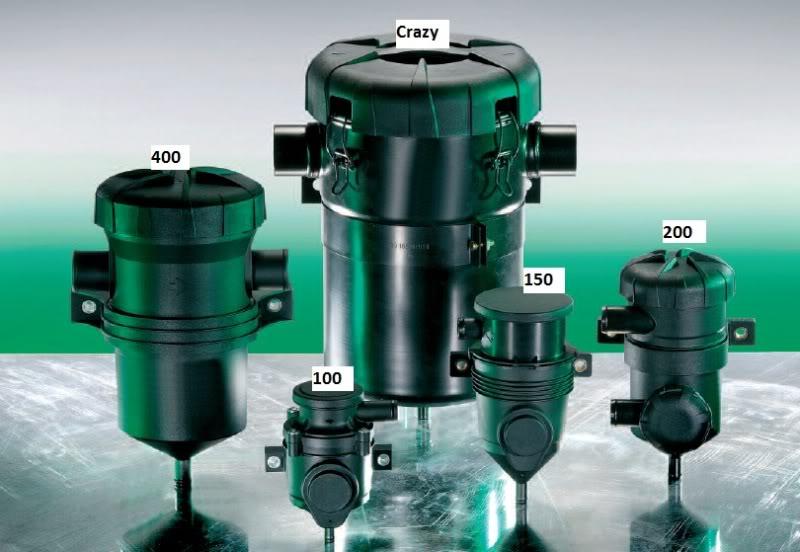

          On the Provent front I've now sourced rolls of silicon hose, and am even trying some black silicon vacuum line hose too! I've a nice cheap drain tap, and I'm at the stage of being able to fab brackets to suit.
          The main problem remains, where to mount it in the TDI with the stock airbox, it's a physically big unit.
          I am picking up the smaller Provent 150 tomorrow, good for 150kw, and a lot smaller in size. A must for the Polo boys, may be the go for the stock airbox TDI crew too.

              The Provent200 is a better choice and right capacity for 2.0L TDI

              Wrecking RS OCTAVIA 2 Link
              • #37
                Not if it won't easily fit Miro! Will see when I pick it up.
                    Isn't the Provent number indicative of the max kW output for the engine that it should be fitted to? The non-GT/GTD versions of the 2.0l TDi's (both PD and CR) only put out 103kW as stock and probably won't go above 130kW when remapped unless heavily modified.
                    Some headroom is always nice, though
                    Resident grumpy old fart
                    • #40
                      It's more that the 200 has the lowest restriction of the two, and you want to minimise restriction in any PCV system. In light of that, if you have space, overkill is the answer!
