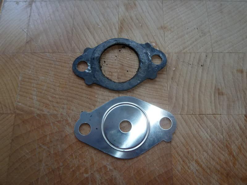

          Yeah I got told that on the weekend, to get a reducer.
          This is what I have found.
          Part Number:028131547B
          Below is the original Gasket (Top) and New Gasket (Bottom)
          So will this reduce extend the length of time for the car to warm up?
          Also will it raise my EGT? (I'm still a touch noob even after reading all your posts)
          Last edited by benough; 20-09-2011, 10:31 AM. Reason: actually did some research after posting ;-)
          • #65
            those are questions that i would be keen to know the answer to as well.
            i've been really babying it recently - changing gears @ 2,000rpm, trying to maximise fuel economy etc. extending warmup time probably wouldnt matter to me as im not really thrashing it anyway - when i do, that takes place in the hills, which take 45mins to get to anyway, so plenty of time to warm up.
            just one additional question for the gurus - if you install this part, will it mess around with the computer / sensors / throw codes / affect the car's driveability? i'd presume that it WOULD increase EGT's as more oxygen = hotter... (that wasnt really a question, was it? )
            • #66
              A total block of EGR will throw the engine light CEL ( I live with it currently ) but it is a warning only and doesn't mess with the normal running of the car. The hole allows enough to prevent the CEL, may have to upsize it a little if the CEL shows up. Just drive it normally for warmup, and even with no EGR and a lot of cold air coming in, I have not really noticed longer warmup times.
              Also I've been anxiously watching my EGT's since deleting the EGR inlet, and even with mothballs, I'm not noticing any unusual temps - at all!
              I expected higher EGT's with no EGR, but it's simply not happening with normal driving! If you put in a plate with a hole, you will very likely not even notice a change. The benefit is a lot less soot going into the inlet, and that's a huge plus on my books, so I can recommend the hole EGR plate to everyone. Anyone with a hopped up/track/drag TDI should be running an EGT gauge anyway, or at least driving around for a few days monitoring EGT's on VagCom. I'm keen to find a way to delete the CEL, and when I do I'll be sure to let all the oiler crew know!

                          • #73
                            My reducing gasket has finally come in. I got the manifold gasket as well as the o-rings for the EGR.
                            I'm going to have a crack over the LWE.
