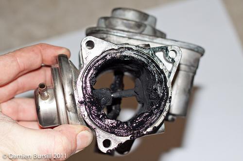

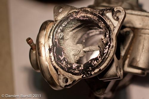

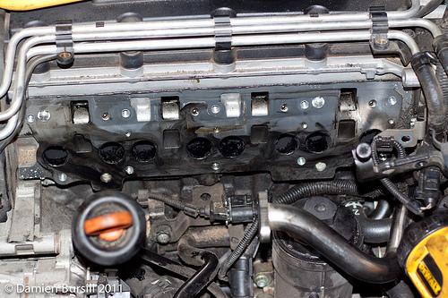

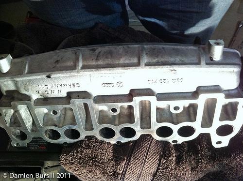

                          Hi i have a 2005 103kW 2.0TDI which has done 206,000km. I cleaned the EGR inlet and manifold yesterday which took around 2.5 hrs to do. It was not as clogged up as i thought it was going to be. The manifold was fairly dirty and had a lot of soot and crap in it.
                          Just remember the bolt in the opening of the manifold, I would never know it was there as it was covered up with soot. Thanks to this forum for letting me know.
                          It was a filthy job cleaning the soot and crap out of it!

                              The fact is that EGR buildup can cause serious problems, and people should be aware of it. The kind of regular driving cycles that the engine experiences, the oil used and a few other factors affect EGR build up, but just because yours wasnt too bad after 100,000km doesnt mean thats the case for everyone.
                              I've personally seen and cleaned egr deposits up to 5mm thick, and i've seen them caked onto inlet valve stems so thick that it was just a nice tapered cone shape from the valve guide to the back of the head of the valve. when large deposits are loosened they could certainly be caught between the valve seat and valve, causing piston/valve contact and loss of compression.
                              The other thing to note is that you have only cleaned the uppermost part of the system - the inlet manifold is still clogged as before. And trust me, the inlet manifold is a lot harder to clean than the throttle body.
