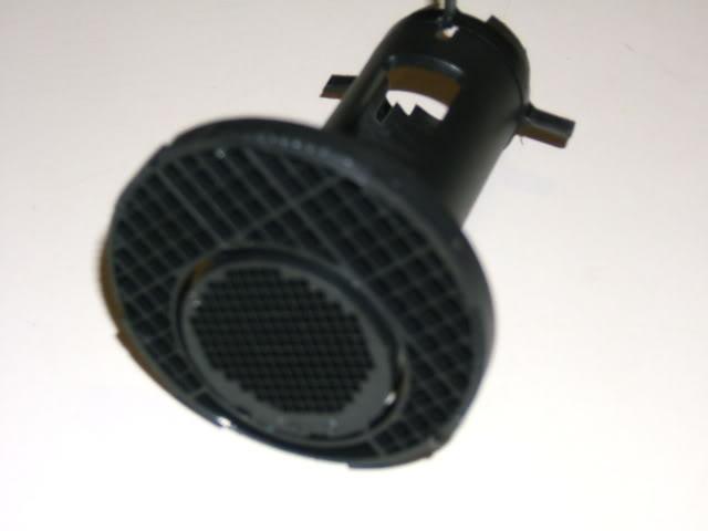

What you can do now is ditch the MAF grid, as it is there to smooth out airflow over the MAF sensor after the 90 degree bend out of the stock lid, and it seems reasonably restrictive. See my first tinker thread. Modshack reckon it's 22% restrictive.
