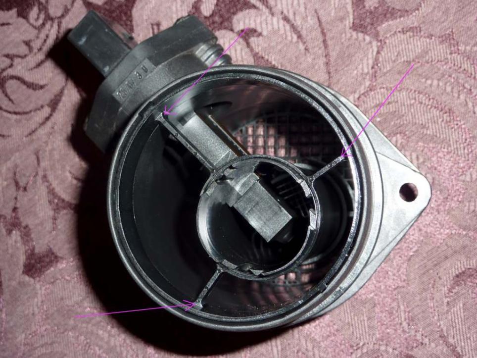

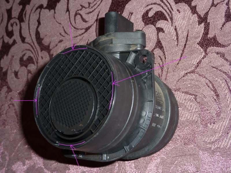

                Ok I did it and the car runs fine. Its brought a little bit more induction noise again and maybe a little bit more power - like I said before this might just be a placebo effect as without any dyno figures or 0-100 times tested its difficult to say but its a simple no cost mod so I guess it couldn't hurt. Anyone looking to do it here's a little DIY -
                Stock MAF unit below -
                To remove the grid you need to first unscrew the plug up the top - unfortunately the screw heads are a weird star pattern so I didn't have the right tool and just used some plyers and a very strong grip to unscrew them. Once this is one you need to break off the four tabs that I've indicated in the photo. They are actually melted/glued into the MAF surrounding.
                Turn the unit around - here's the back
                The three little arms I've indicated are part of the outer rear ring that slides into the MAF and hold that smaller cylinder in the middle. There appears to be some way you can remove the arms and outer ring from the small cylinder but I spent a while trying to figure it out and couldn't - ended up just using tin snips and cutting the three little arms.

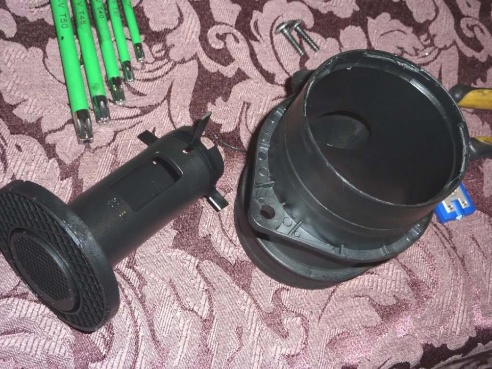

                After that the grid and the central tube slides right out and then the outer ring with the cut tabs slides out the other side leaving you with this -
                Then it just a matter of putting the plug back in, screwing it on and re-install evey thing again.
