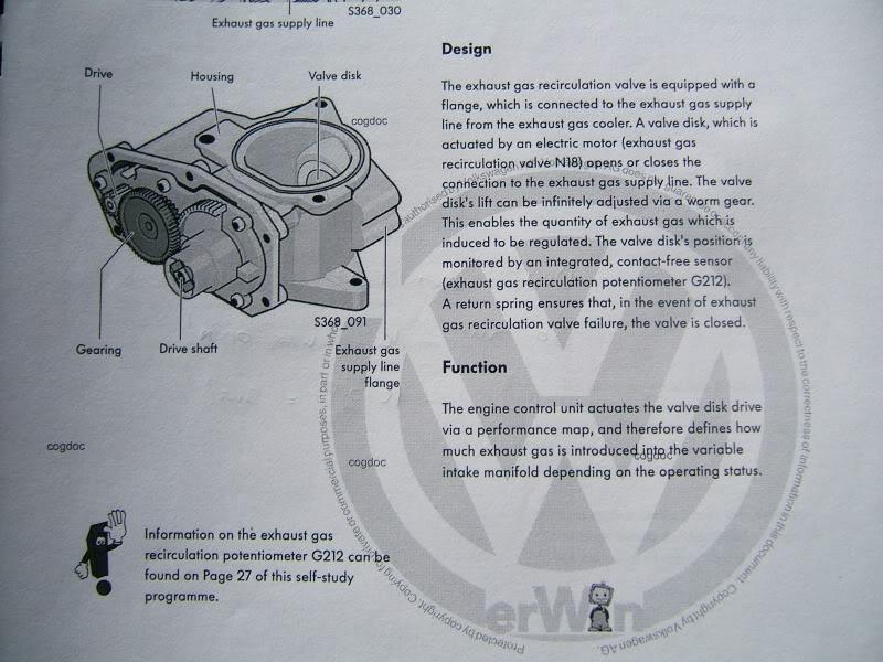

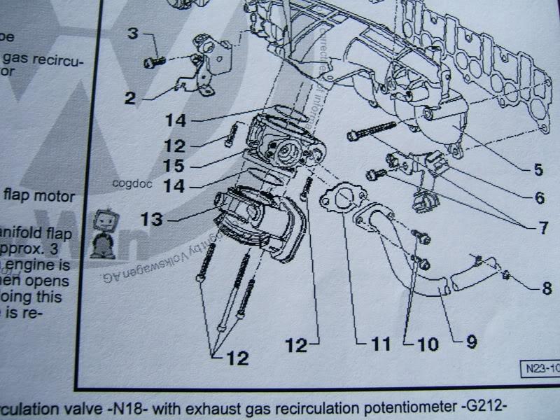

                                Here's the info from my 125kw self study module pulled from Erwin. To my knowledge the only difference to the 103kw is the exhaust gas cooler is bigger on the 125kw, part of the thermal handling upgrades I was mentioning.
