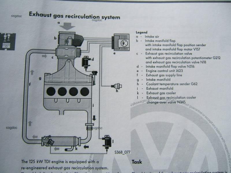

          • Intake pipe
            Greg you mentioned that you might look into the EGR system over xmas...are you going to pull off the intake manifold? (in my diagram they call it the intake pipe...number 5 on your picture). I am just wondering if it would be possible to unbolt the intake manifold, egr intake pipe etc and the big rubber air feed pipe at the bottom and lift the whole manifold+egr valve+flap motor out in one go? The gasket for the intake manifold looks expensive! Where do you get your gaskets and O-rings from in Brisbane?

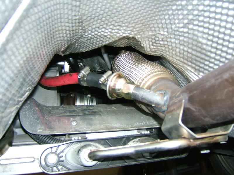

                        • Moroso has been in and running fine for several weeks now, it enters after the last sensor for the DPF, but on the caddy you'll be able to get it up higher as you don't have as many sensors to worry about. Higher equals hotter equals more oil vapours burnt. If it doesn't enter before a sensor, then there's no way it can upset the ECU. The ECU / lambda probe is only measuring EGR anyway, no way it measures the amount of oil vapour. I'm hoping my forthcoming CC tune can edit the EGR sensors out, as that's getting hobbled as well. When the car is driving and I'm getting exhaust temps of a few hundred degrees I figure it's burning off pretty well, only seems to be an obvious problem on idle, but only from a bit of an oil fume smell, absolutely no different to anyone else running a total loss to atmosphere catchcan. Nowhere near as bad as the times I've tried running a gas engine with total loss crankcase venting, that much oil smell does make you a bit sick, and I've never perservered with it till the TDI.
                          When the new DPF less dump pipe arrives, I'll be talking to JBS and CC to work out just how high I can put the moroso, given a lot of the sensors will then become defunct. It's definately going back in, but as high as possible.
