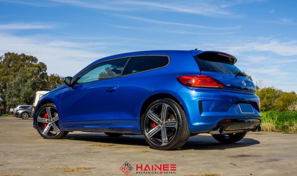

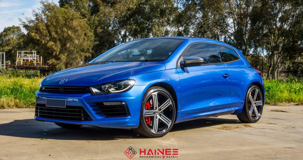

                      • Just had the Scirocco major service completed at Haines Mechanical & Detail. Car has done just under 45,000km so not technically due for another 15,000km but given the car is tuned I like to be ahead of the scheduled maintenance interval.
                        Included engine oil & filter using Liqui Moly 5W-30, DSG fluid and filter, cabin filter, fuel filter, brake fluid replacement plus replaced the HPFP cam follower (for good measure) and changed the lower control arms back to stock.
                        My wife is going to be running this car as her daily driver for the next couple of years and wanted the steering back to stock as the Superpro ALK does make for a heavier feel.
                        Service even came with a complimentary wash and photo shoot....

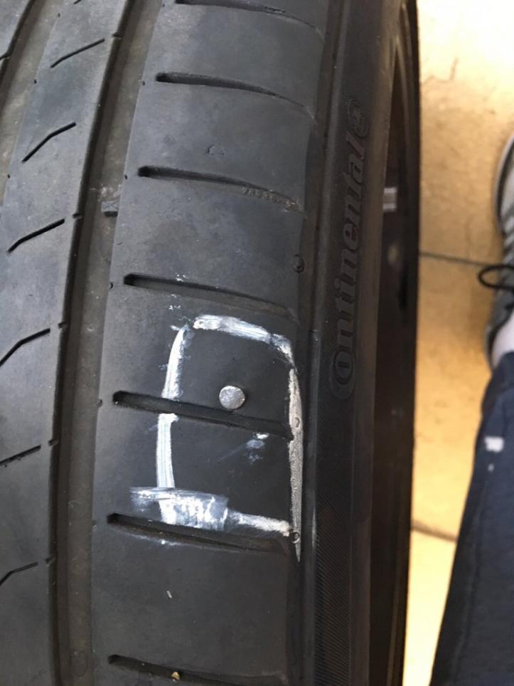

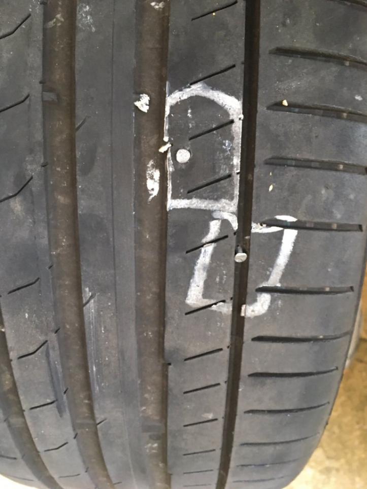

                        • Wife is driving the Scirocco and in the last 2 months she’s managed to get 2 flat tyres.
                          The latest attempt has a collection of 3 nails:
                          And the kicker is that 2 of the punctures are too close to patch and now need to replace 2 tyres... [emoji21]

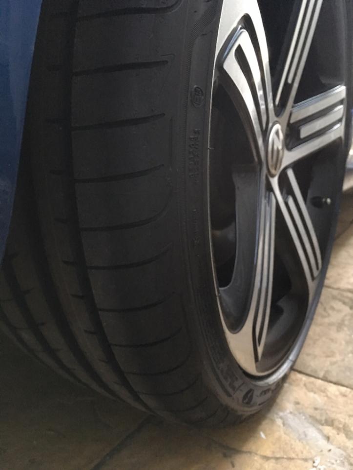

                          • 2 new Goodyear F1 Asymmetric 3 tyres fitted up to the rears. As it happened the drivers rear also had a nail through it [emoji24][emoji24][emoji24]

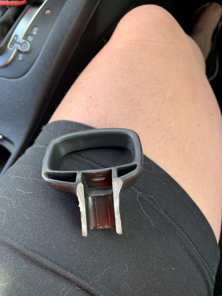

                            • Had the handle for the seat rail fail today. VW is saying it’s not covered under warranty...
                              - Tigger73's 125TSI Build
                              • Tigger73's Scirocco R
                                Well the dealership wanted me to buy the part through spare parts but VW Customer Care has come to the party and going to replace the handle as a 1-off.
