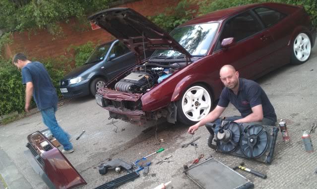

        After I fixed the sump(wait did I tell you about the sump?Kinda smashed that braking from 140+)then the radiator decided it didnt like not being handled without velvet gloves during the front end off paint so splitting its end cap where the clip from the front panel fits was its way off showing dissaproval. Painter has issues still with his boss so the rear halfs still not done. My splits are taking longer than I wanted and im fed up missing e-bay deal adaptors that would suit them to a tee. The exhausts rear hanger gave up the ghost after one too many scuffs and has decided to go seek more gainful employement elsewhere.

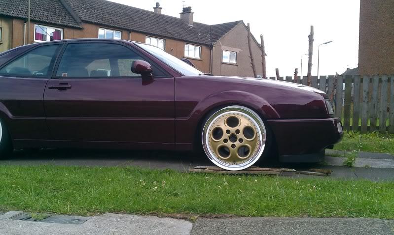

        15/6/11

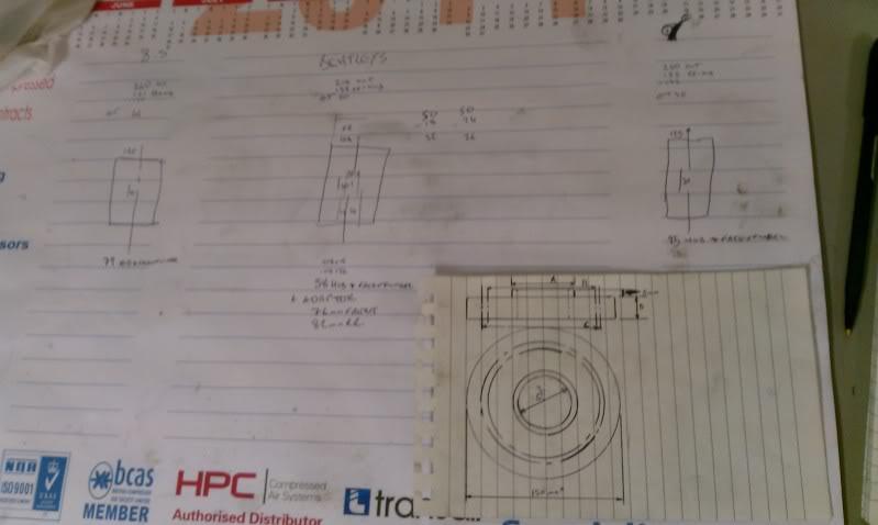

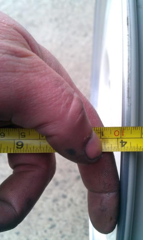

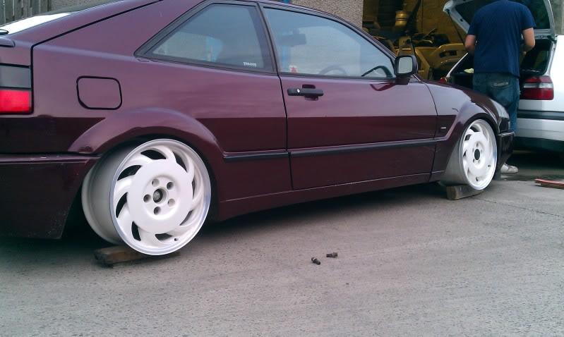

        working out the new adaptors for the dials

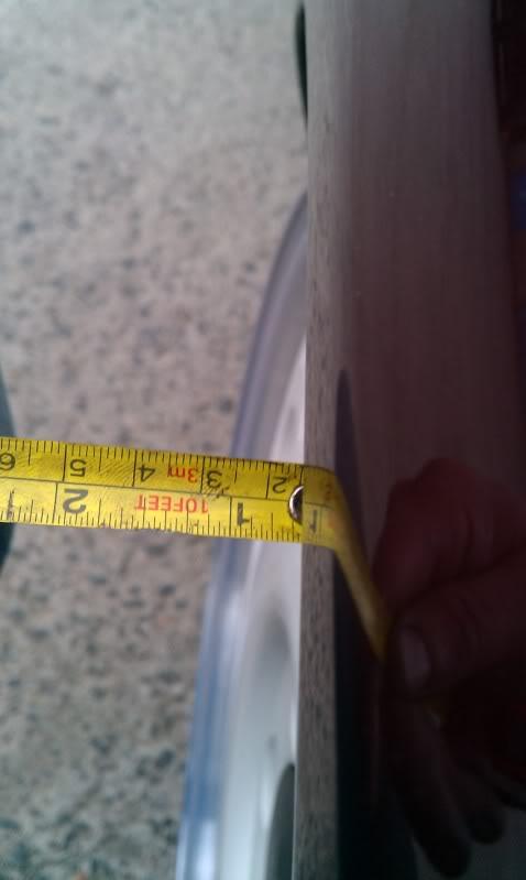

        All good in theory but I wanted to be sure so tried a friends 8.5s on to measure up properly for adaptors
        front 8.5x17 et 38(after adaptor)early 16v fenders,rolled but not pulled
        rear 8.5x17 et32(after adaptor)

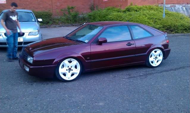

        how they sit

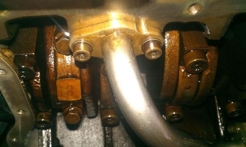

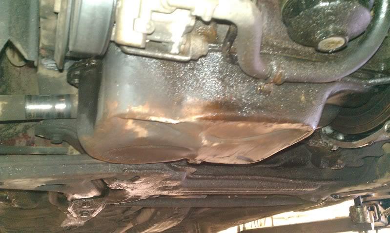

          ran over a motorway cone base in the roadworks on my commute to work last tuesday

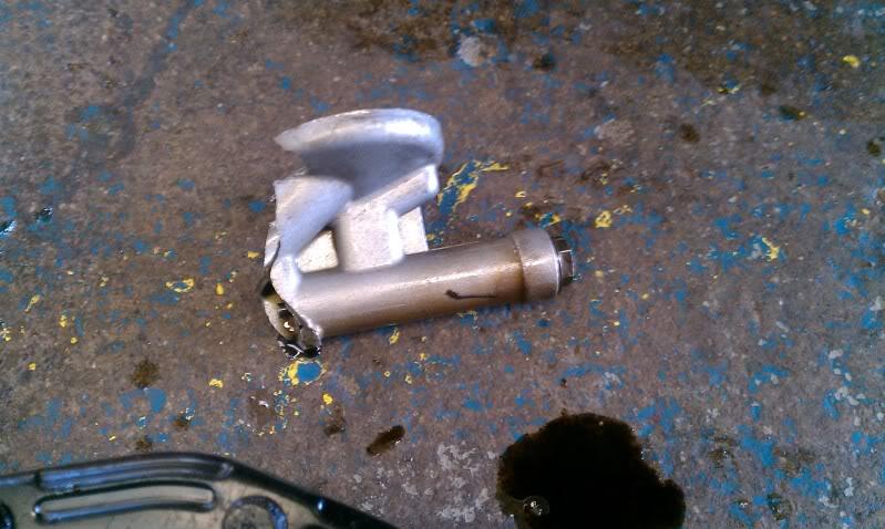

          Wasnt burst or leaking but the oil light came on at idle and the oil pressure went off at anything over 2500rpm so figured the sump was humped up tight on the oil pump strainer again. Babied it back and forth from falkirk to glasgow(70 mile round trip)to earn coin to fix it thinking it wasnt burst so whats the worst that could happen.....

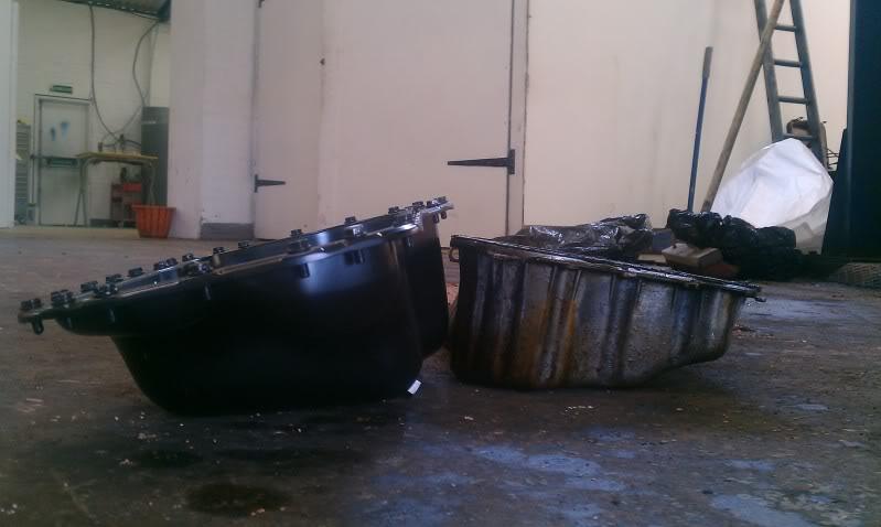

          bought new metal sump from my mate LeeMurray - 'manback' who is a service advisor for a VW dealership

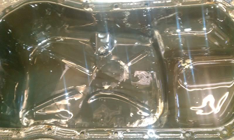

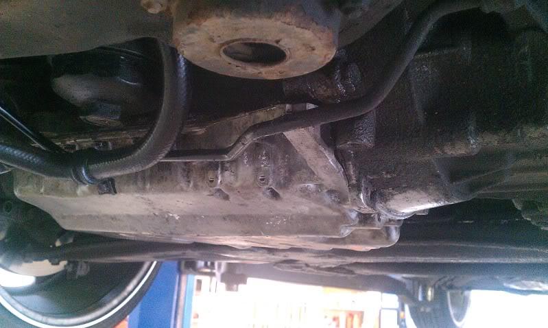

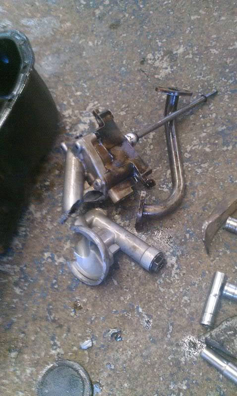

          removed the old sump circle is where the strainer had been embedded
          to this result,was actually hanging together by a thread but as soon as I tried to remove it with the sump off it fell to bits

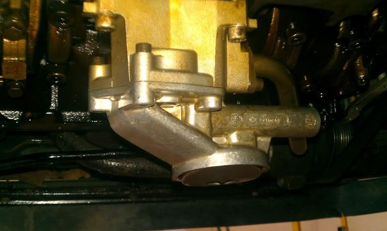

          new pump and pick up was 150gbp which tbh was beyond me but another friend Euan Bennet came to the rescue although it meant a 140 mile round trip to pick up the parts
          almost new mk5 .:R sump,pump and pick up and the day from hell later....Was leaving bennets house in my sisters car that I had as a loaner to go get the sump when I got a call that my mother had been in a bad three car smash and was in hospital,left(in a hurry)and naturally got stopped by police doing 74 on a 60 freeway while en route to the hospital.....to further find out I had an expired licence dating back 8!!! years to a previous driving ban where I incorrectly filled out paperwork after the fact and my licence had subsequently expired.....so they impounded my sisters car and were going to leave me at a cab rank 40 miles from home and 65miles from the hospital....luckily I knew a guy from the recovery company and they dropped me at a train station albeit still 30 miles from home. Never got home till almost midnight but my mom had by this time been x-rayed,found to have no broken bones and released so went to bed....
          • #65
            8am start this morning...new metal VR compared to 'new' mk5 .:R sump
            reinserted the OG pump drive and bolted up the new .:R pump
            4 allen head bolts in all,refitted with a dribble of loctite and nipped up
            sump on
            the start of more clearance.........new engine mounts to follow soon as possible,the og mounts are notorious for sag seemingly worst cases found in high mileage VR golfs and corrados
            for now itll do

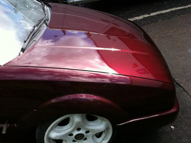

            kinda up to date now,cars going away for the final paint for definate on monnday night and he expects to have it till the end off the week so more pics then

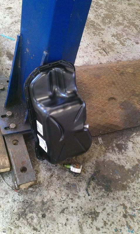

                    Slight complication,painter had a nightmare journey back from a show he was at at the weekend and asked for a days grace to sort himself out(he also has a corrado lol)and then I broke the new sump the morning it was supposed to go away
                    Its currently lying outside my flat with its nose in the air waiting on another mk5 sump which is on back order for some reason

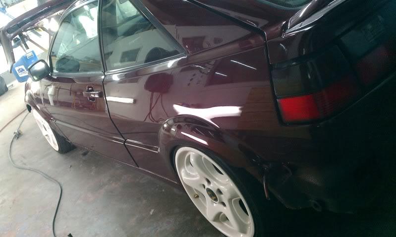

                        recent work...
                        was a very busy week......
                        moar work got did
                        ****ety****shearedbolt caused a mare of a time
                        seems head gasket was probable cause for og radiator fail
                        stuffss been done otherwise including the local kids taking a sharp object along the passenger side off the freshly painted car,the fuel feed line springing leaks from either end thatve cost me a half tank of gas and any and every little thing igniting my nipples

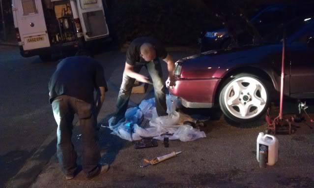

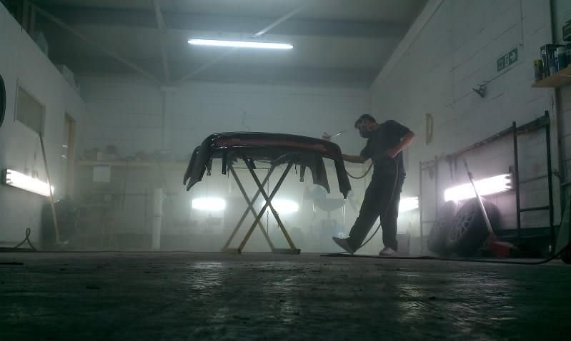

                        Originally posted by vardo
                        ill add my pics from the 3 am shift last night

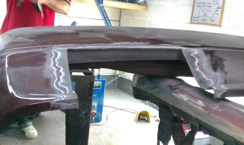

                        ghetto repair to splitter yo
                        dangerous Daz
                        exhaust delete in place

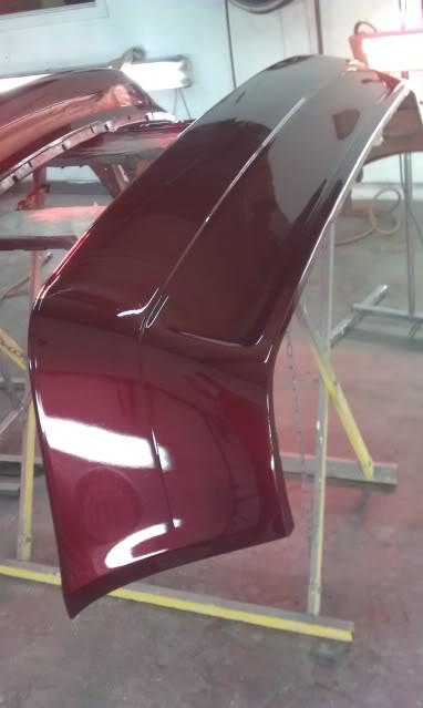

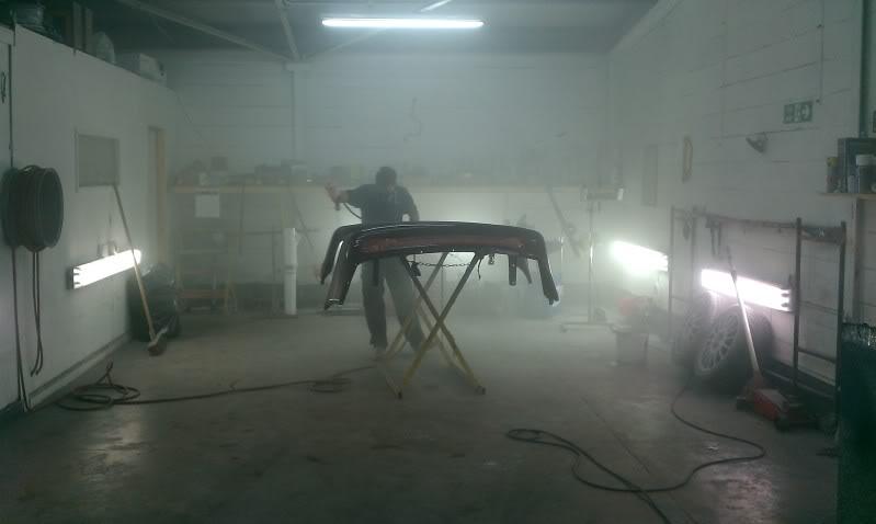

                        basecoat
                        laquered oot its nut

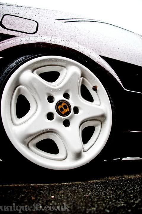

                          wheel

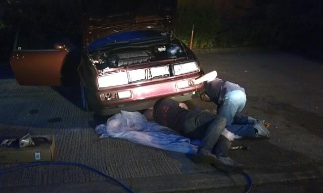

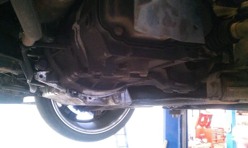

                            then corrado decided to drop its engine on the ground............
                            drivers side bumper bolts came loose by some combination of errors and fell out basically so that side of the cross member was only being held up by an m6 bolt or whatever the **** it is with a 13mm head which also eventually came out depositing the sump literally on the ground.
                            Id just got the day off for tomorrow sanctioned and was heading from work to the nearest jetwash when the poo literally went down
                            Stephen(my brother)came to the rescue,left the pictures and brung down the trolley jack.Banged a widow maker under the sill.Lifted it up enough to get the trolley jack under the front on the cross member,ghettoed the cross member back on and should possibly be back on track for still taking mine tomorrow now

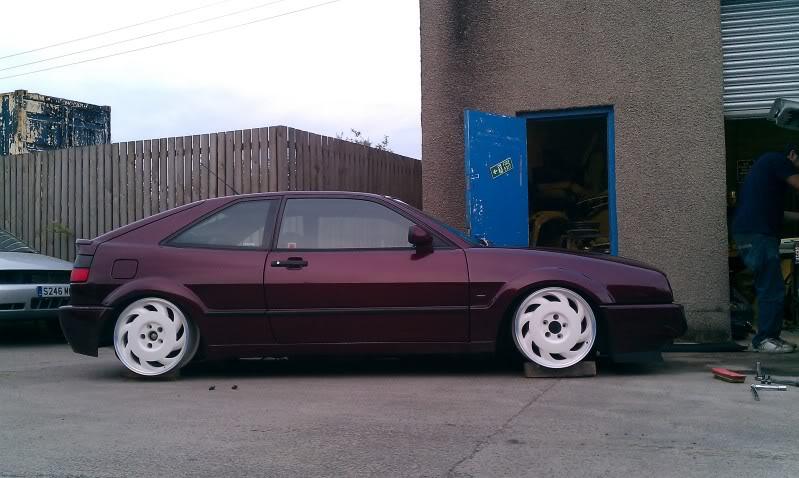

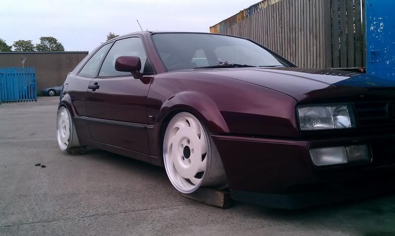

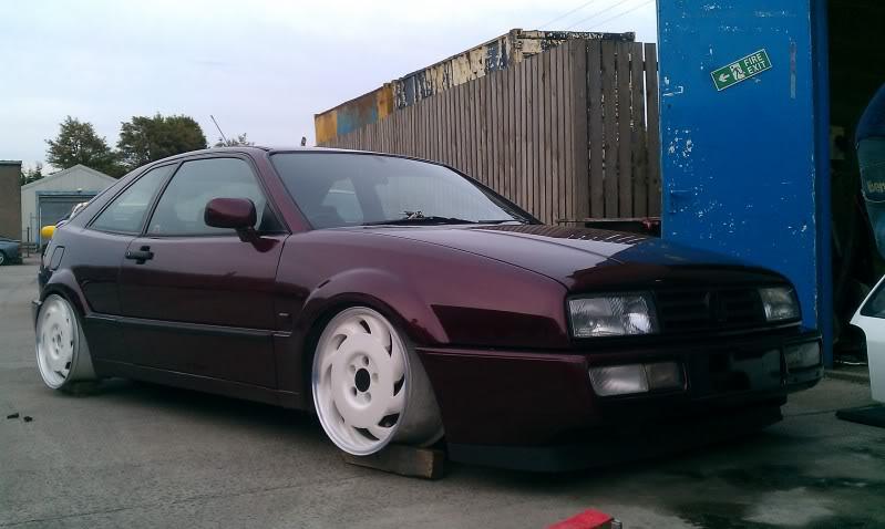

                            my pics from the last couple of days....

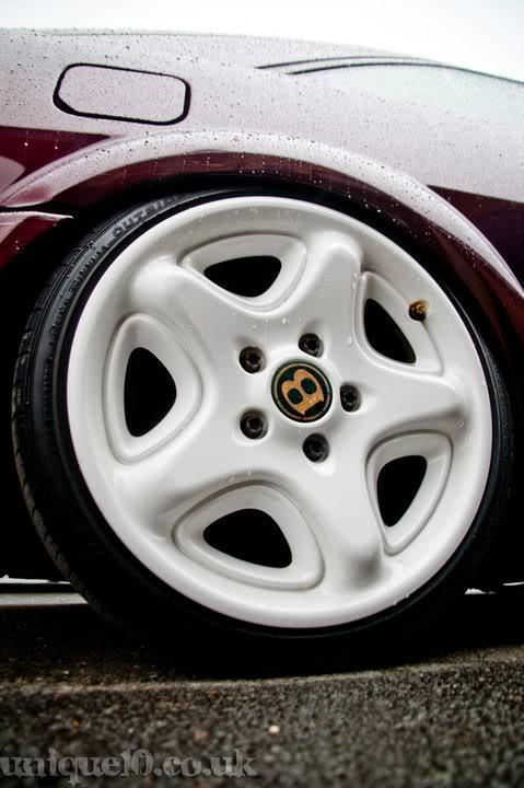

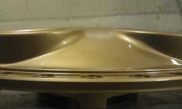

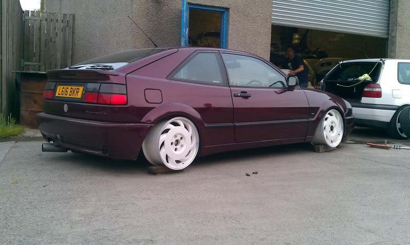

                            got the centres back from ed(good friend)painting them on tuesday night iirc. Built the wheels on thursday,tried them up alongside the car

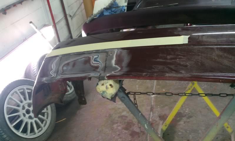

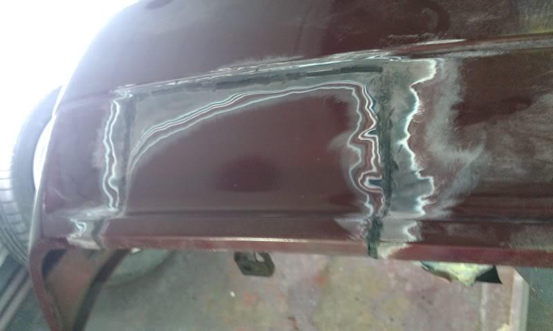

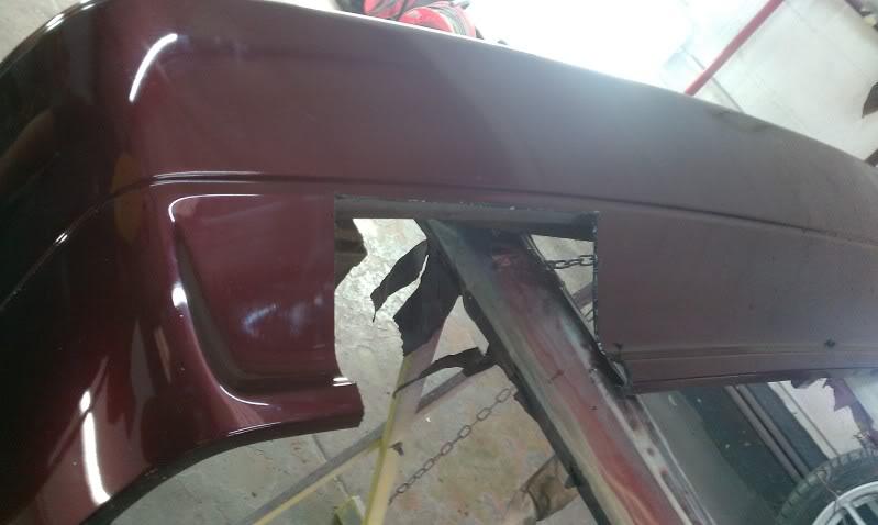

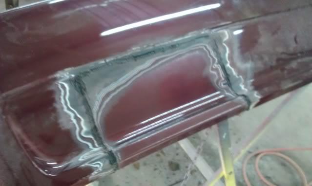

                            onto bodywork.......cut out exhaust section
                            cut area prepped
                            shaped to fit and stu welded it in

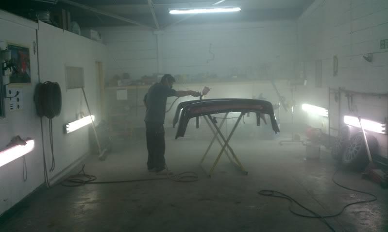

                            then it got a smashing

                              more piktorz

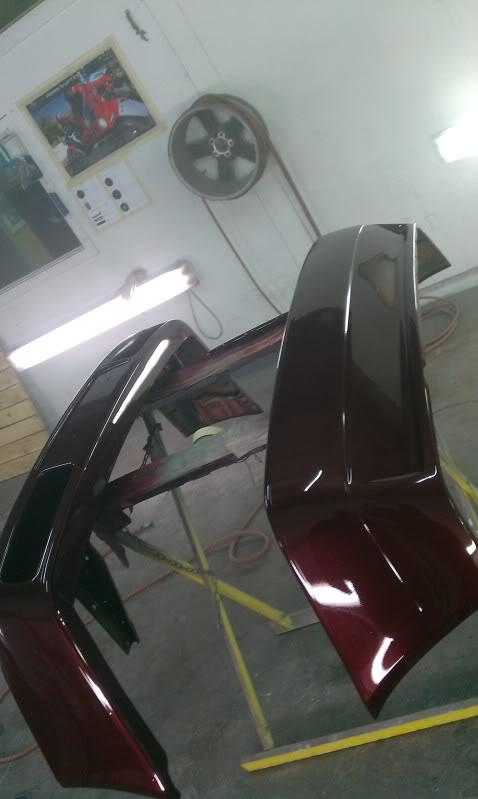

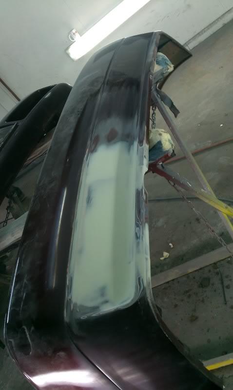

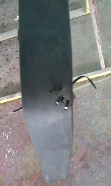

                              Originally posted by dubbed_up_daz

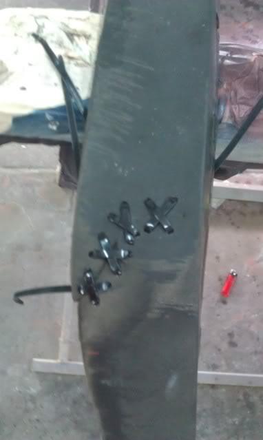

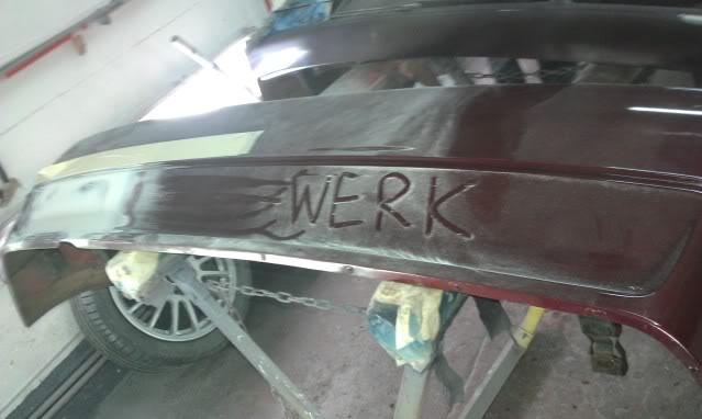

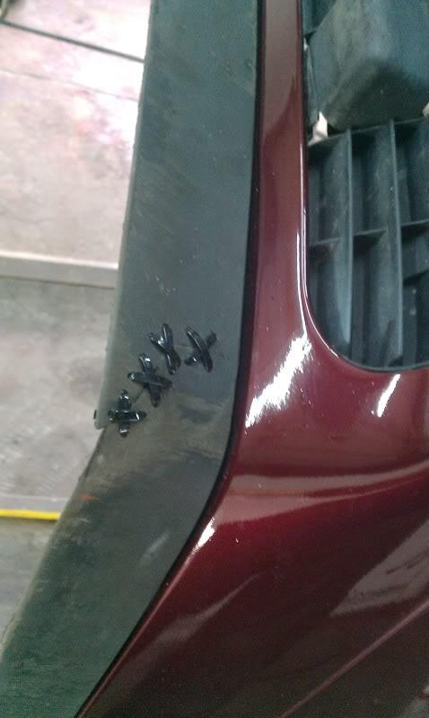

                              stu buffed out the cyntrags 'key' mark....probably a kid with his first 'my little needle.........'

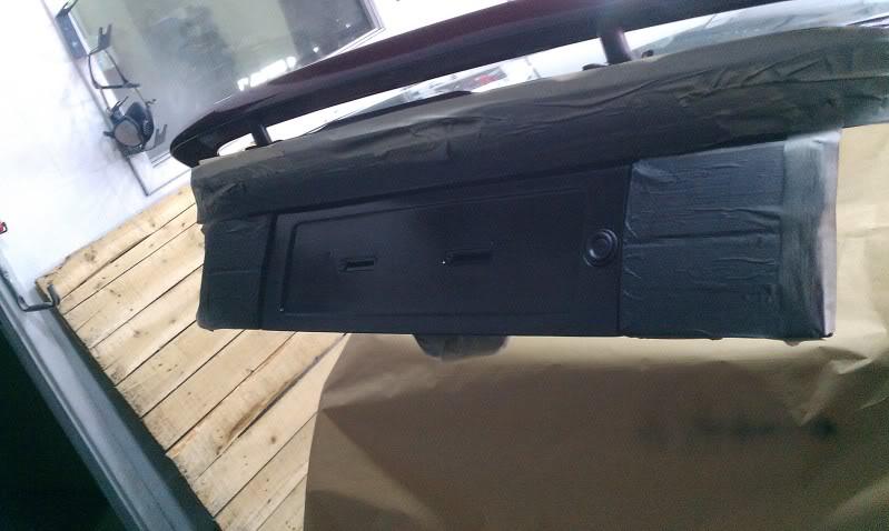

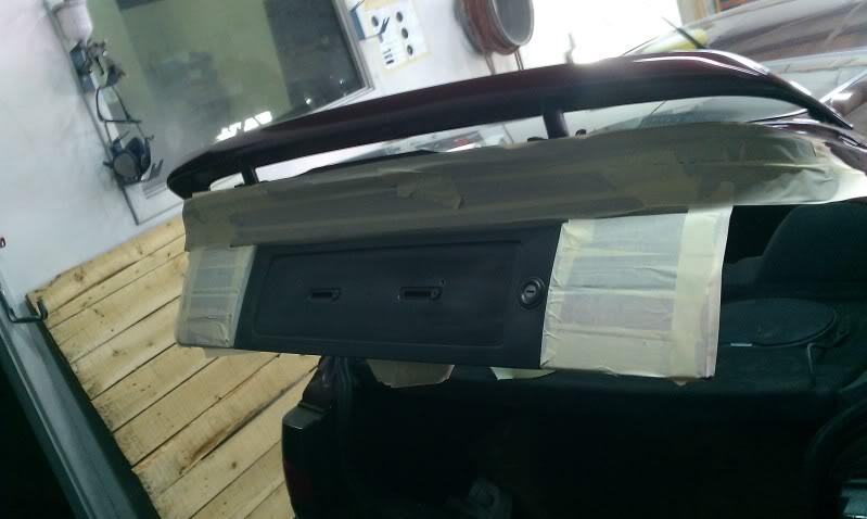

                              rear plinth washed down with gunwash stuff then scotchied and masked
                              dustied
                              ghetto de-lock yo

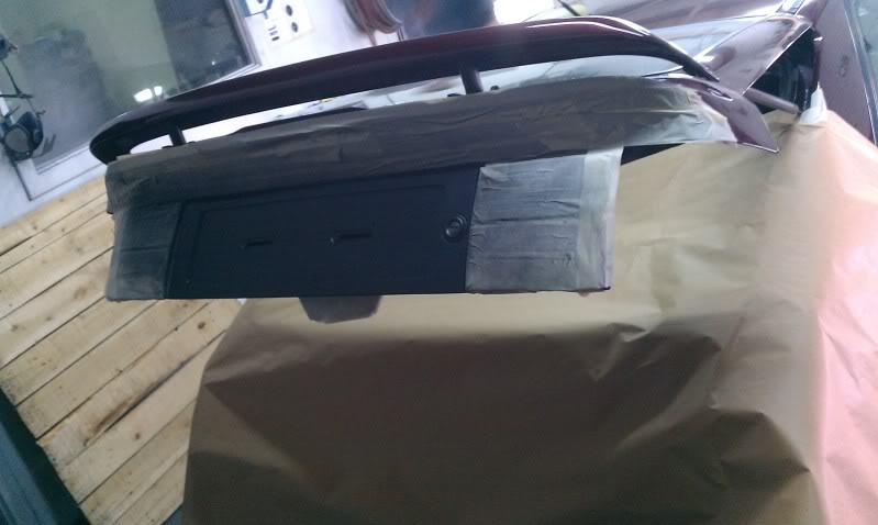

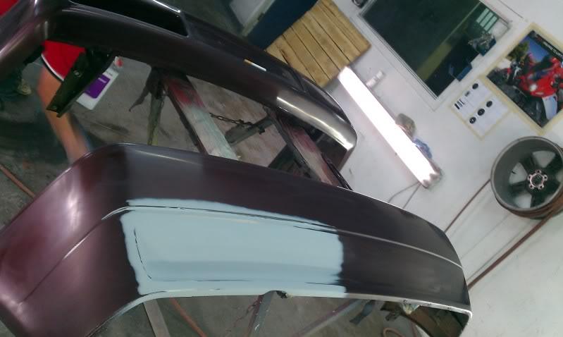

                              bumper got masked for cataloy work
                              cat'ed,rubbed down then some slinky smooth cataloy **** poured on cured and rubbed down

                                last of the pictures .......

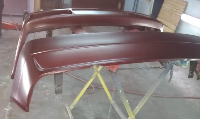

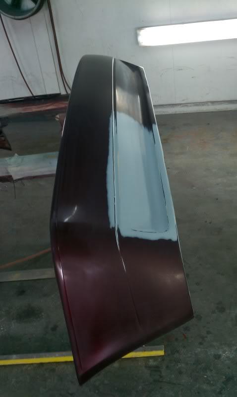

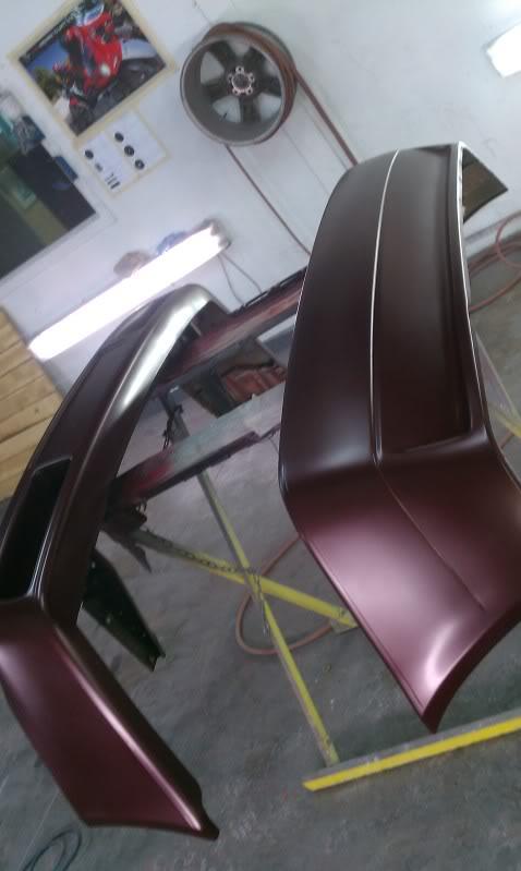

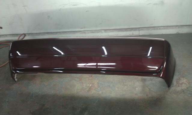

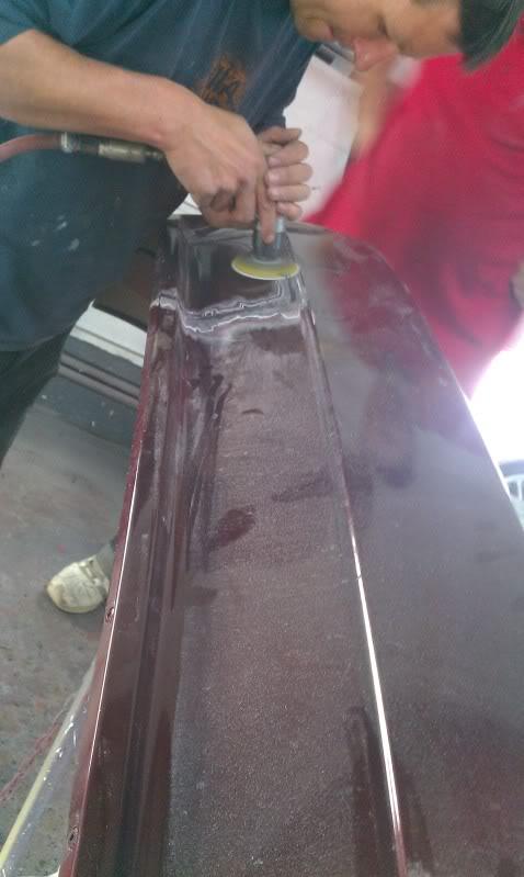

                                high builded
                                profiled and re builded
                                base
                                stu at work like a lil leprechaun on crack
                                after a lot of clear
                                in stitches........
