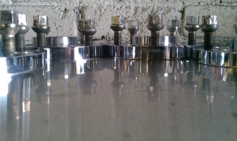

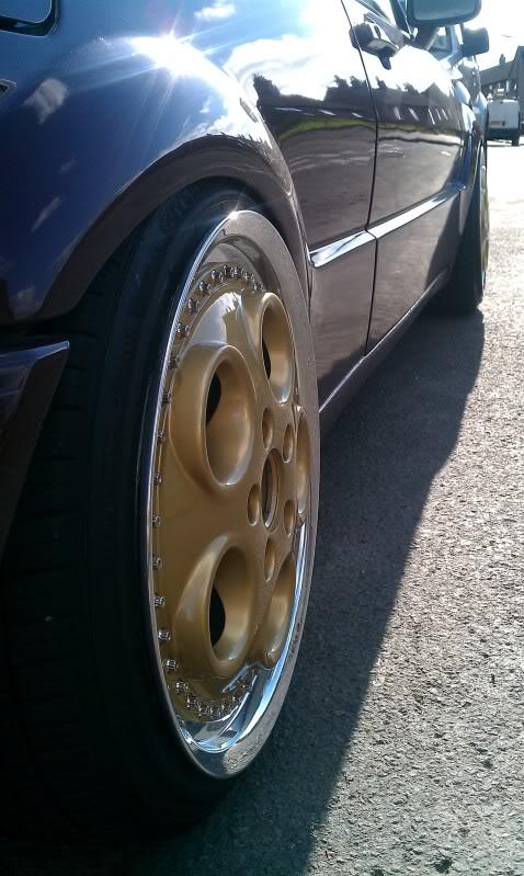

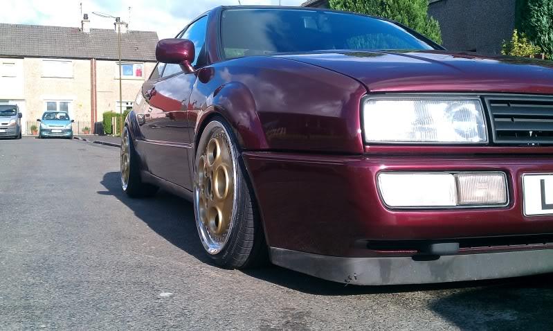

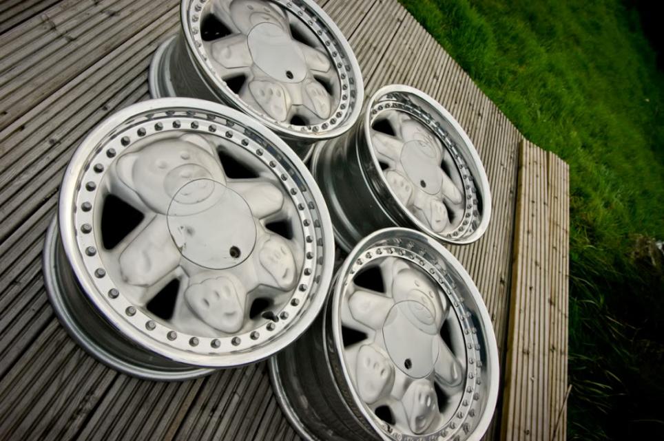

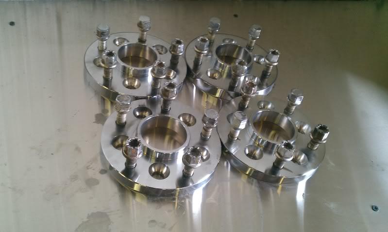

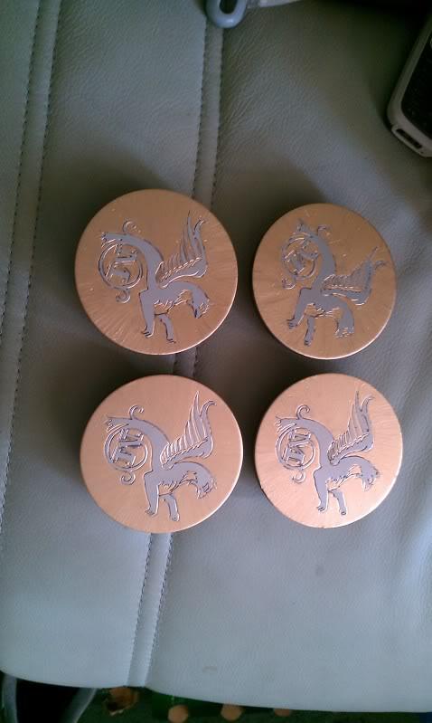

        • New,new adaptors arrived. Polished and chromed them this time
          basically just took the outer machining lines off
          finally on but a whole host of new issues
          had to raise it from the bentleys as these have slight poke but had very little time so just cleaned up the coils and span them up so got a lot of fine tuning to do

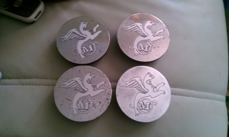

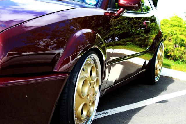

          • gave the badges a scuff to clean them up a bit
            first coat of enamel(none of the second coat,finished them @2 this morning)

              • they were lol,the enamel headache was worth it though :p

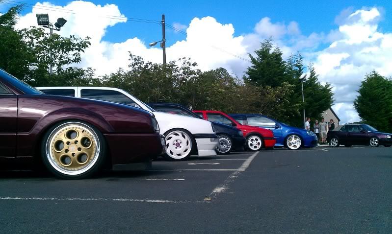

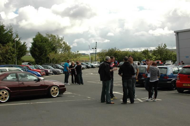

                couple pics from a show this weekend
                My phone cam pics....me and the crew
                and a few pics ive stole from the show
                • love it man, although i think i may prefer the bentley's personally. but it does definitely look good!!!

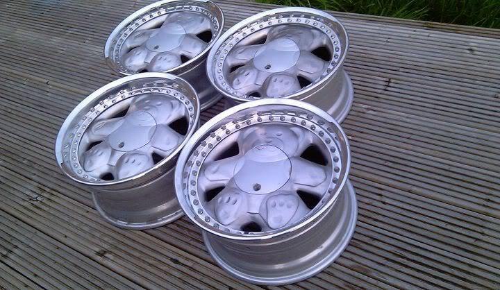

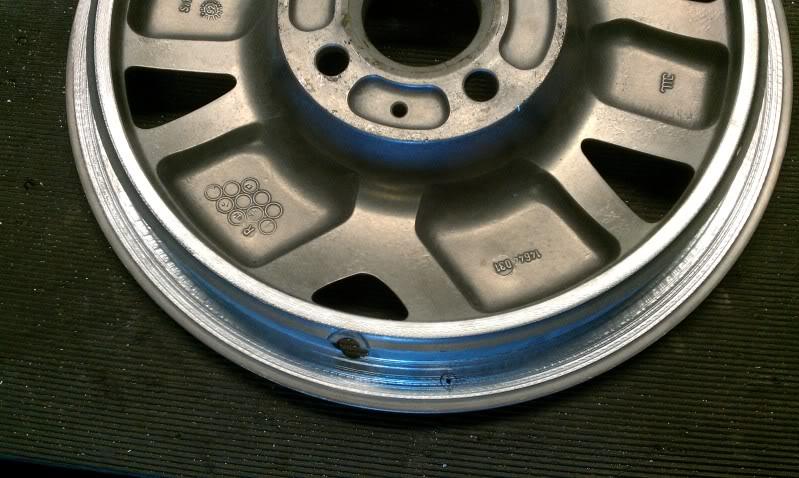

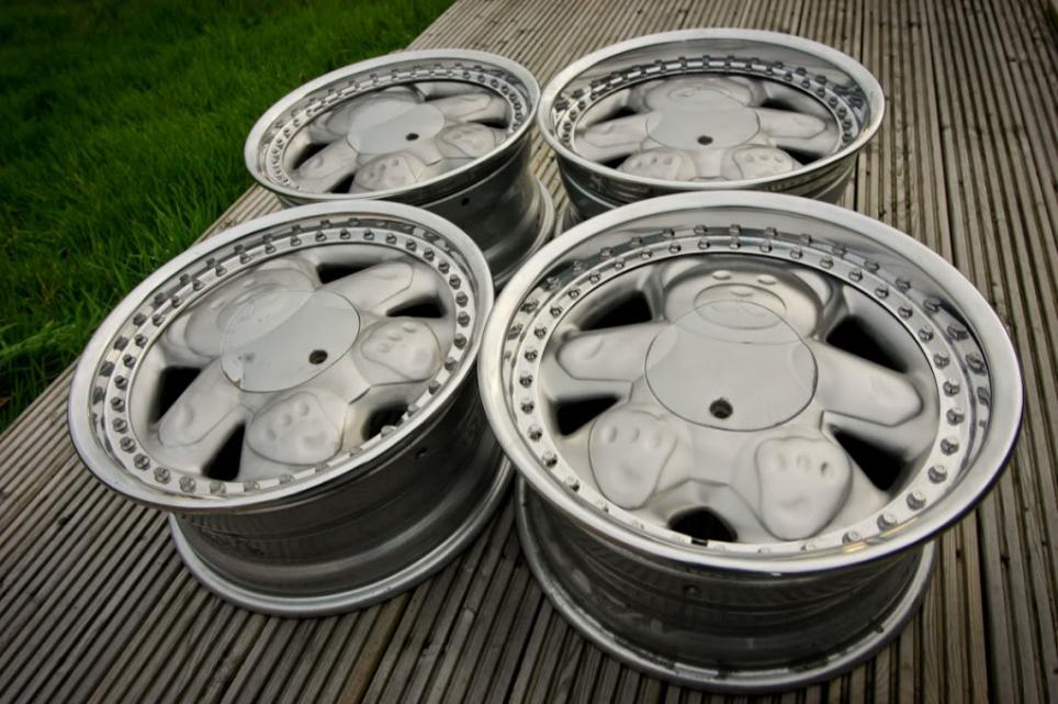

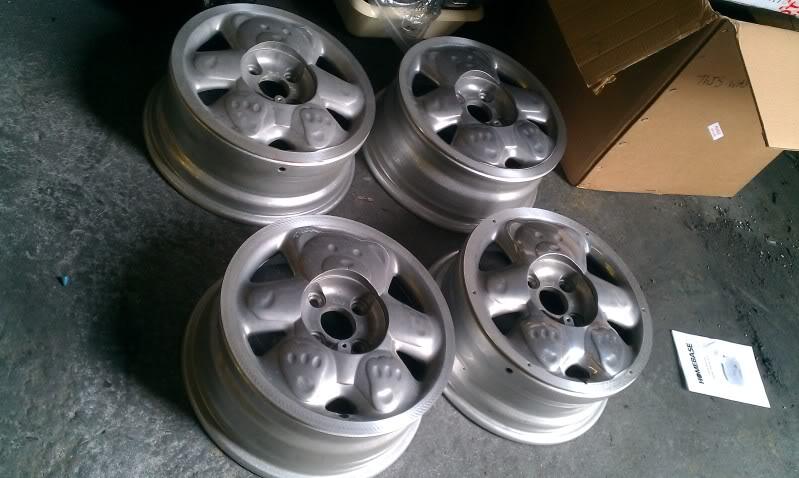

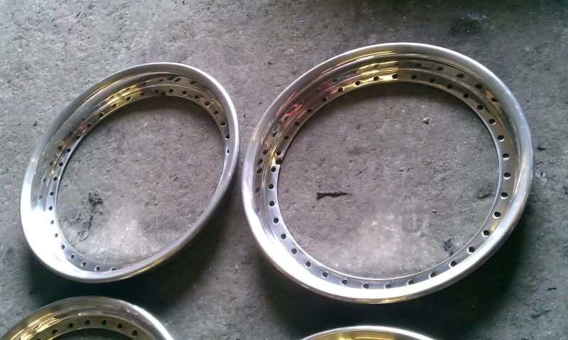

                            semi update,all barrels machined down to fit. Every mm I stole from the barrels meant more meat on the actual centres which I preferred
                            lips hopefully machined down and bevelled tomorrow

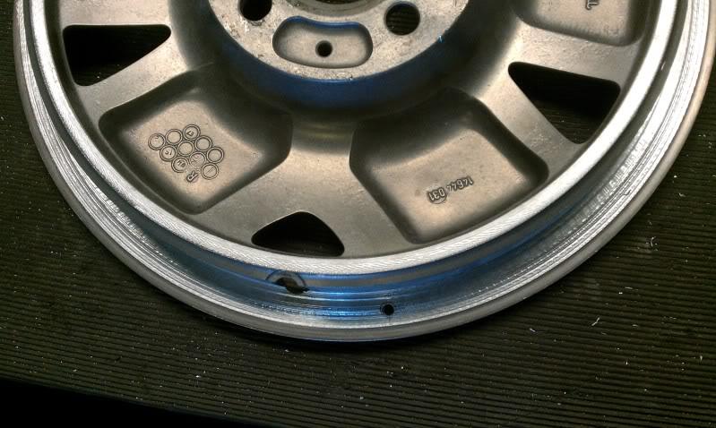

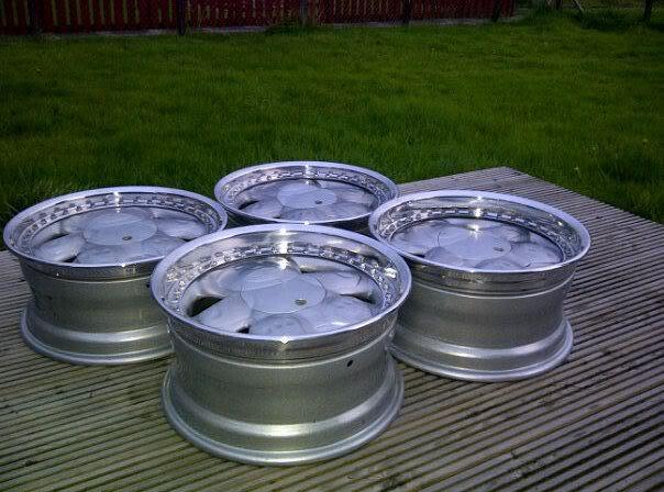

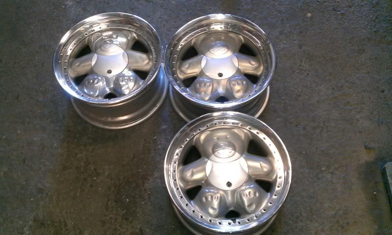

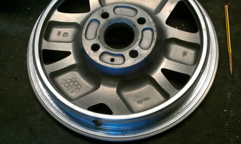

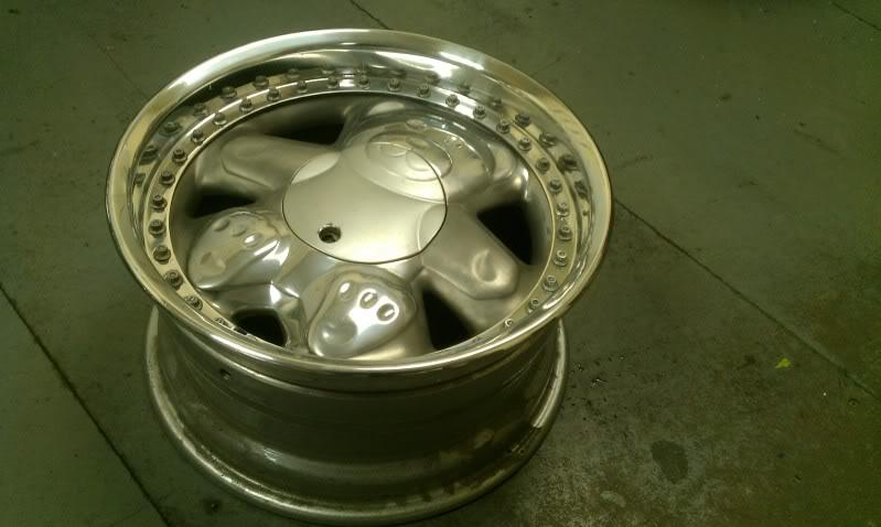

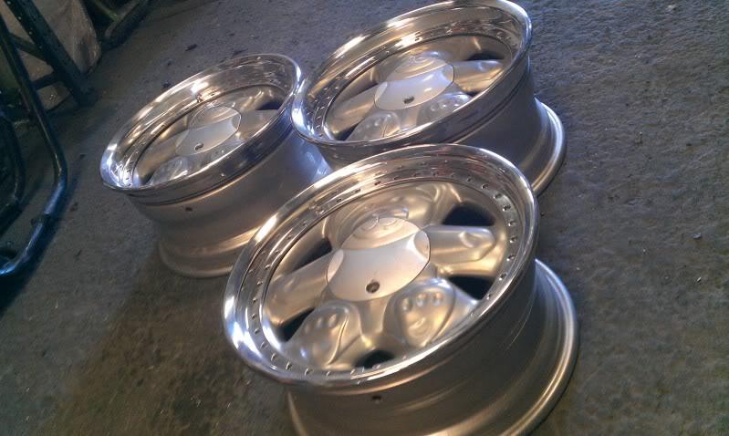

                            soooo...this was back in may

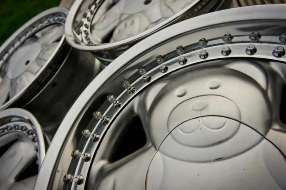

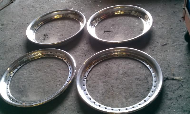

                            sooooo.....still waiting on my sis to get bolts and nuts but been doting about on the lips. Kinda said already about how bad the donor lips were due to the old face mounted set up but they really were tremendously ****. Hacked a good skim off on the linishing table on the bolt platform the sateen'd them to death on the bolt face and the lip then DA'd them to get them semi-non-tramlined-to-hyphenated-fhhuck,the re-sateened them lightly to take out the linishing and DA marks with three differently shaped mops and a coarse first stage menzernac 'grey'(thin skinny 3 section 1/4" one for the tight 90' onto the flat lip,1/2" section to reduce that gouge and do the bolt face and a 2" section for the flat lip and the roll over section),went back over with four coarse tight stitched coarse flat and shaped mops(1 - 1/2" sect for the 90',2 - 2" section for the flat lip and bolt face,3 - shaped mop for the roll over,4 - 3" section for angled work on the flat lip to spread the pores and reduce dragging,then a 3" loose mop with again some first stage menzerna 'grey' to get to this....
                            basically almost ready to start a proper polish on,the four lips so far now have @ 28hours prep alone but this was purely down to their bad starting condition
                            ps - decided to break up my 7" carvings I had for my mk1 to donate two lips to make the bear splits 7" and 7.5"s as opposed to the planned 7" all round with the 6.5" carving lips. Thought seeing as my jetta will never ever be finished and these are turning out to be her birthday presents for the rest of her life I may as well make them staggered to boot
                            then october 31st....

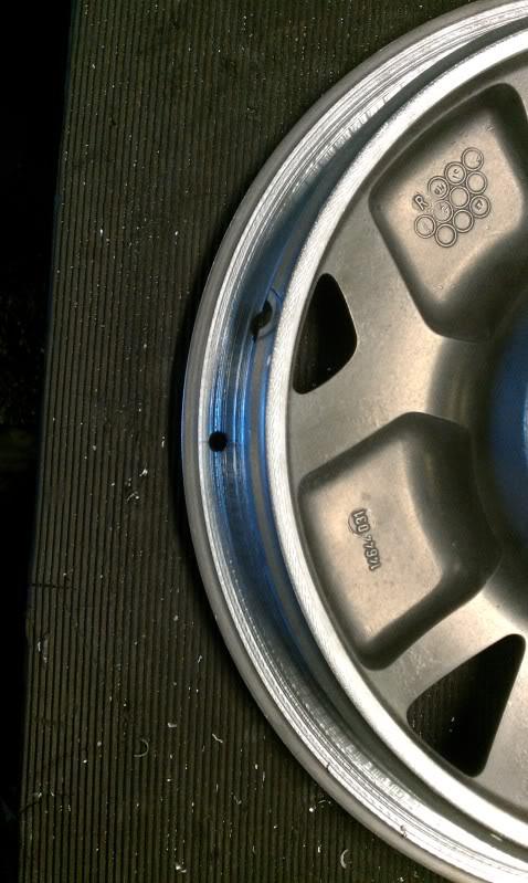

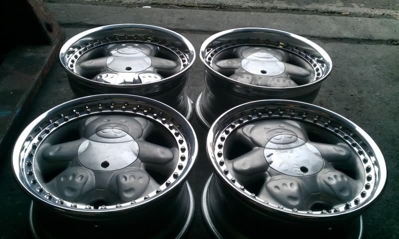

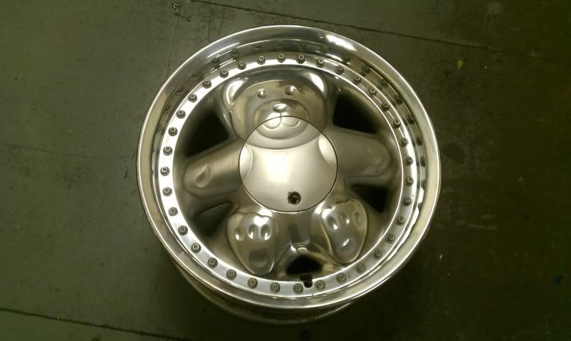

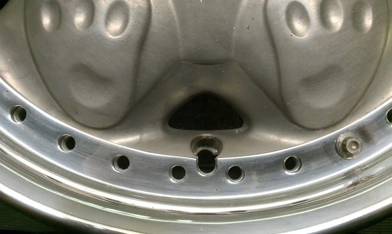

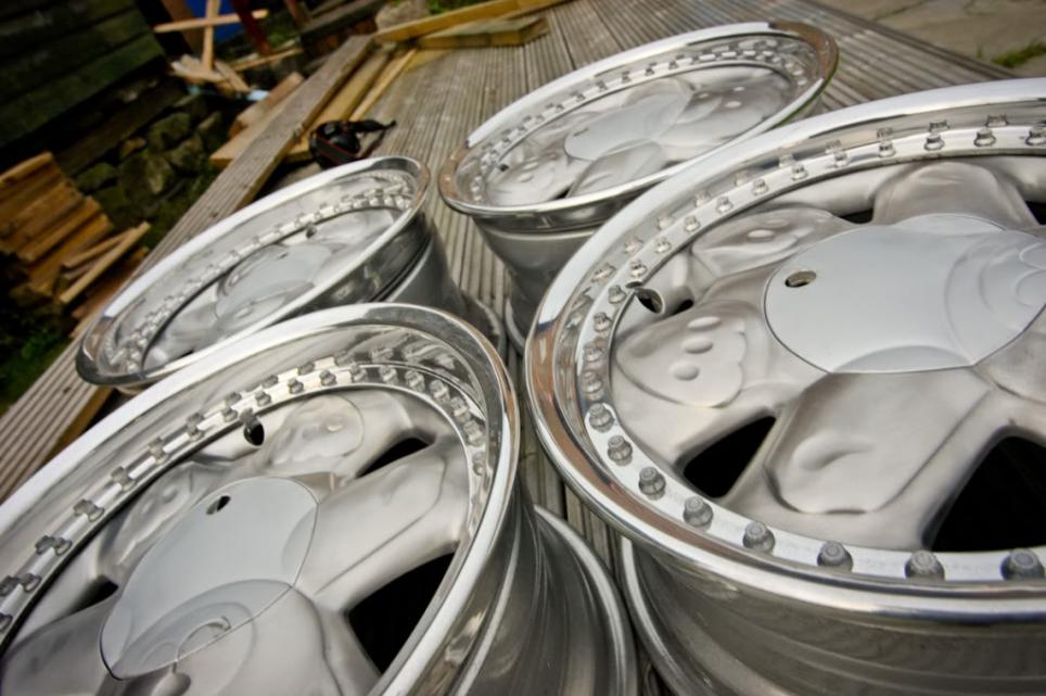

                            Spent today drilling this up...
                            absolute ballache,basically I have to..........
                            loosely build the wheel,centre the lip,tighten,mark hole,dissasemble,pilot drill,reassemble,check hole is central,dissasemble,drill out to take an M7,repeat from start..........
                            35 times :sad2: got one out the road today then noticed the two narrower wheels once the first bolt is tightened you cant get any of the remaining nuts on due to the shape of the tyre bowl so going to have to remachine the other two off the wider set of barrels as well :/

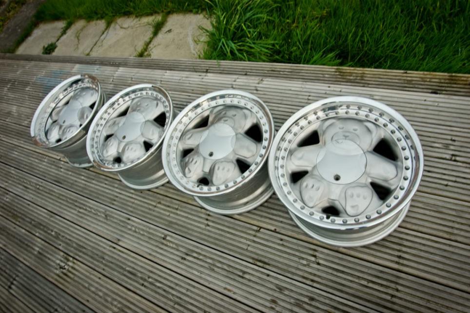

                            • nov 01
                              start of the second wheel...........
                              centre face down on bench and barrel fitted,line up the barrels valve with the valve hole from the teddy 'centre',mark hole on the nearest spoke of the bears reverse with heavily modified pencil
                              drill with 2mm drill bit
                              'build' wheel,centralise lip,check drilled hole with location of barrel/lip hole,dissasemble johnny 5
                              drill out hole to 3.5mm
                              'build' wheel,centralise lip,check drilled hole with location of barrel/lip hole,drill out to 5.5mm
                              'build' wheel,centralise lip,check drilled hole with location of barrel/lip hole,drill out to 7.5mm
                              repeat on opposite side then repeat round circumference...........
                              mostly done
                              getting there.................

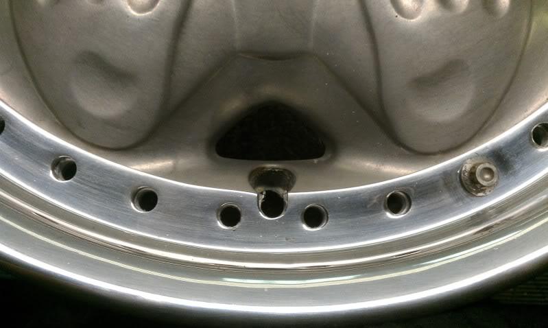

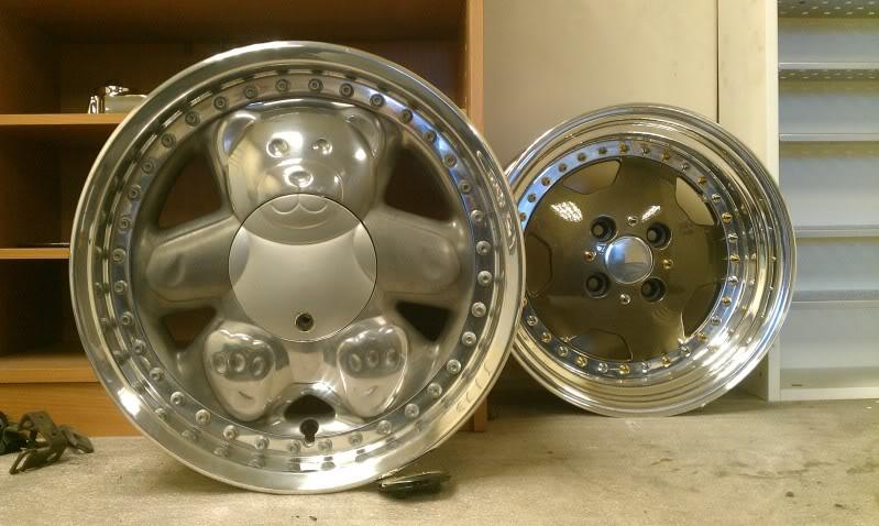

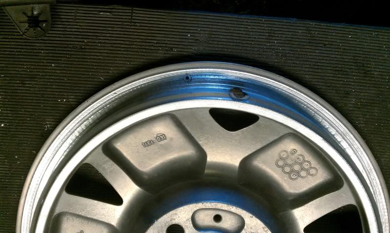

                              • opening up the valve hole

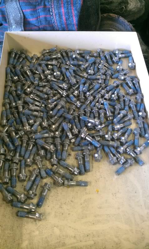

                                started polishing up the studs
                                but had to stop because scott was heading home and mikes lost the plot....got about a wheel and a halfs worth of bolts started though
