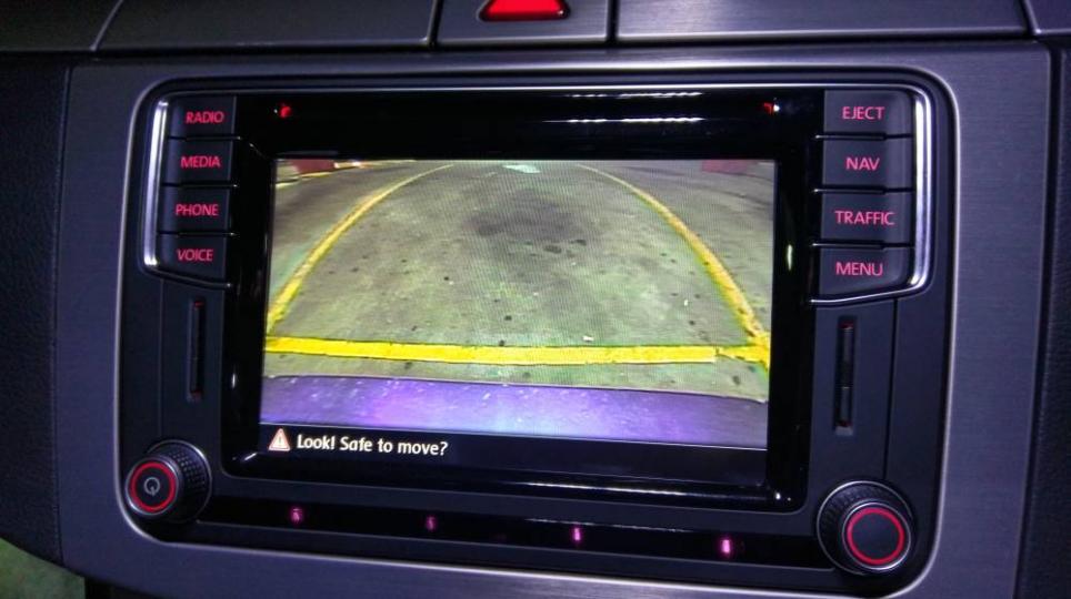

    Rear View Camera
    I had the highline camera 3C0907441 (bending guidelines).
    New MIB compatible highline controller is 7N0907441B.
    This camera module requires parametization in order to correctly display the image at the right angle. The only offline parametization available is for a CC which results in the camera looking down at too sharp an angle.
    What is required is parametization from a Tiguan which is only available with ODIS online. Then calibration data must be loaded to the module either via directly dumping the EEPROM contents or running the calibration procedure in ODIS.
    The existing camera itself in the tailgate does not require replacement.

    Alternatively you could use an RGBS to composite video converter, and you'd also need to swap the pins of the camera connector at the head unit end to match the MIB.
    If you don't already have a camera, you can now just use any aftermarket composite camera. Make sure you use a digital delay timer to keep the camera powered for at least 10 seconds after disengaging reverse.

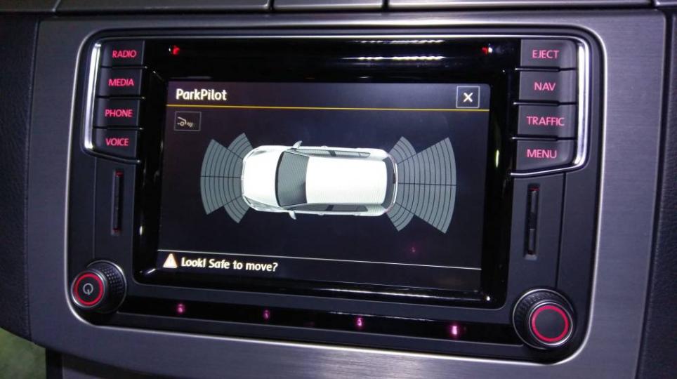

    Park Distance Controller
    Original module 3C8919475 HW07 SW007.
    This works fine for PDC display on its own however it won't allow the reverse camera image with the PDC overlay on the left hand side.
    This needs to be replaced with a newer 5K0 919 475 E. This also requires an adapter wiring harness as the connectors changed.
    I initially had a problem with the new PDC in that it wasn't beeping as early as it should. It would correctly detect obstacles and show them on the screen but wouldn't engage the audible alerts early enough.
    This was fixed by loading the 1k8 Jetta parameters (variant 2) using VCP
