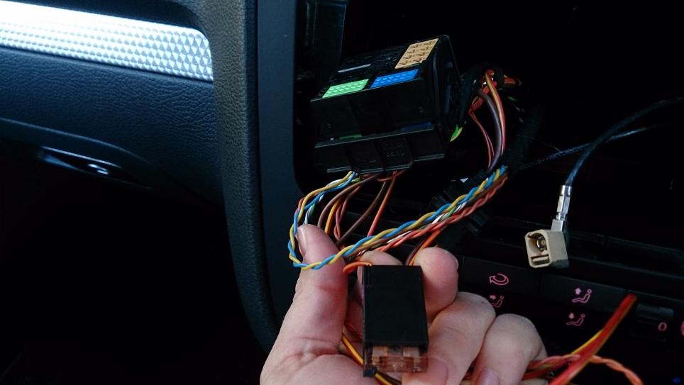

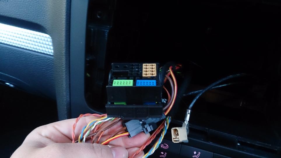

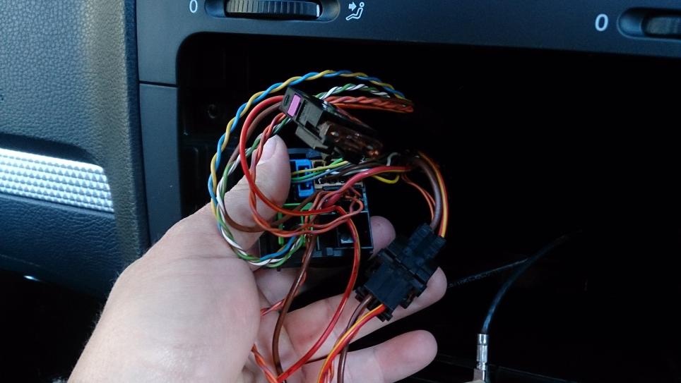

              Noticed though when removing my headunit there are two connections splined off the main harness? Any thoughts on what these are? Maybe it's a video in motion hack or canbus hack?
              Also I don't need the Nokia bluetooth module anymore?

              • No idea what those are but you won't need any other bluetooth now. It's all internal in the unit including mic. Also, if you wanna hide the USB cable you can dremmel or drill the edge of the stereo unit just under the aux plug about 5mm into the plastic to track the cable under the dash etc. A 1.2m cable will JUST make it to the centre console between the seat in a Golf 5/6. I put this one in a Tiguan and drilled a hole into the front centre console while the stereo was out. You can see the cable in the space in front of the gear shifter.

                • That's a clean way to hide the usb loom, cheers. Yeah stuffed if I know what those two connections are I know the previous unit did have video in motion and my battery never drained perhaps it's either?
                  Not colour coded correctly
