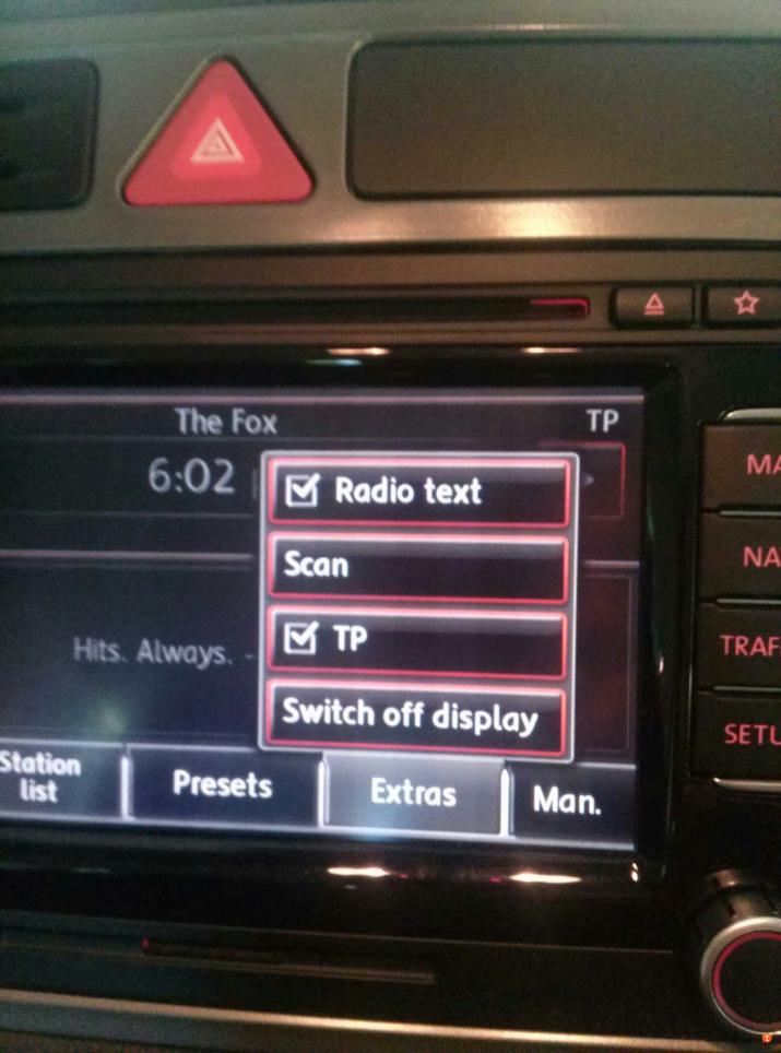

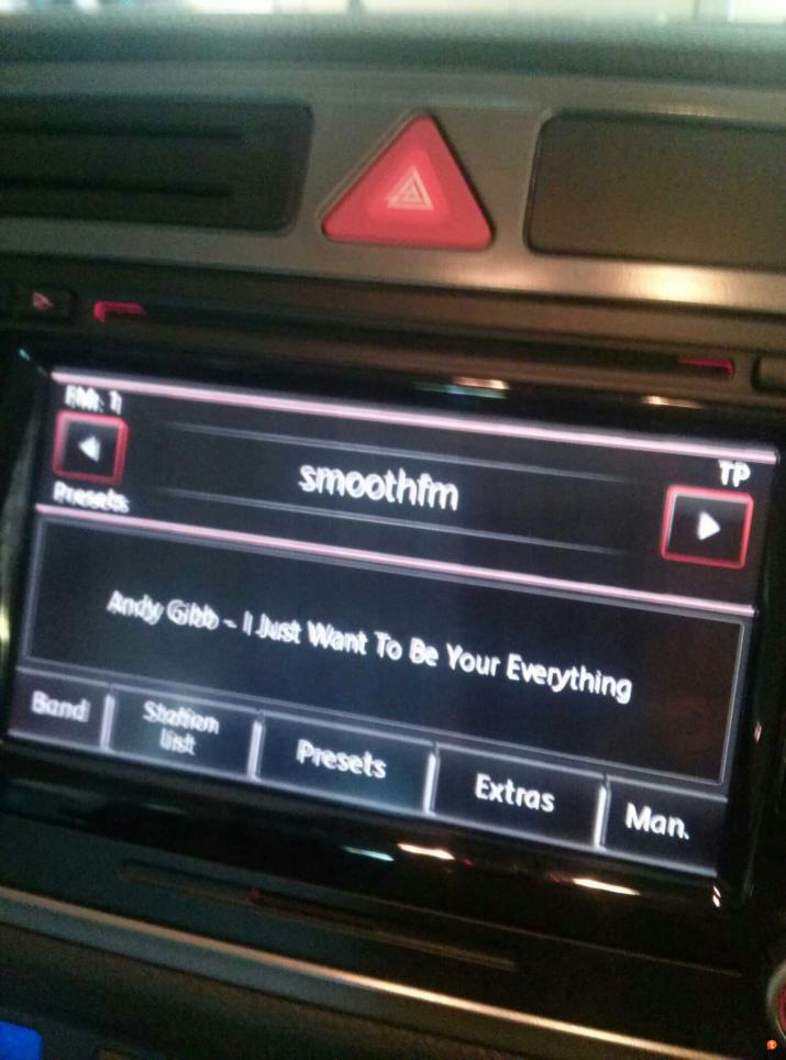

        Hey Sandy, is there a plan to have radio text from the station displayed. Ie, most radio stations send current song name/artist when it is playing.
        On the rns510, this feature is turn on under the extra button.
        Examples;
        Sent from my LG-E975K using Tapatalk
        • #79
          Examples;[IMG]
          [IMG]
          The last time I asked about this the response was that they are definitely going to implement the feature, but I think it's currently not high on the priority list. I do hope this doesn't end up falling through the cracks as I have requested it several times with Audiosources as well.
