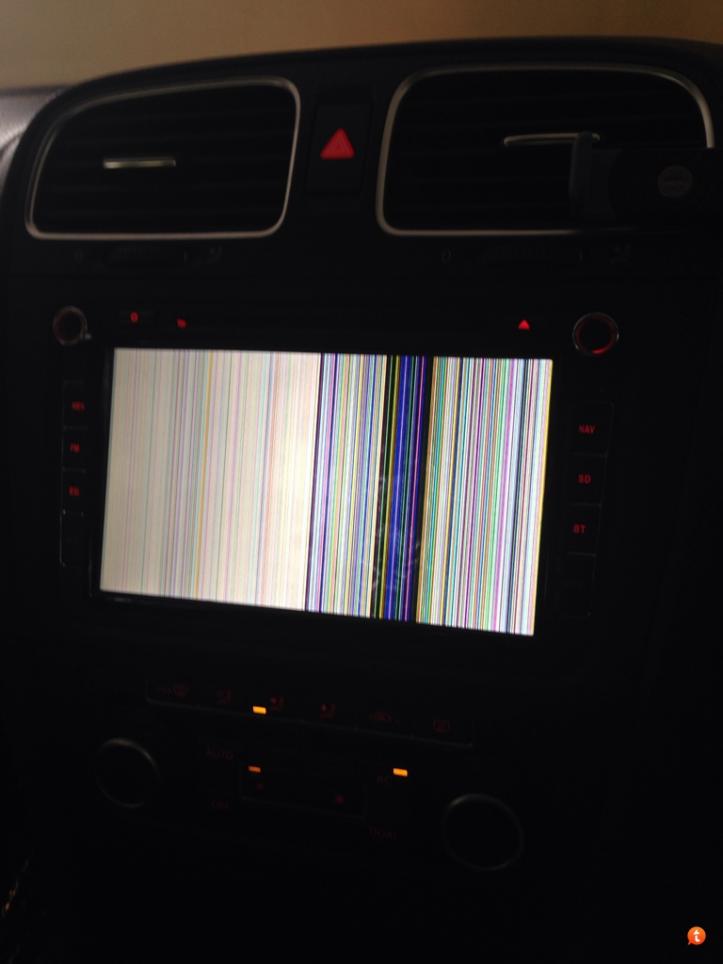

          White screen / monsun.exe error
          Some who received the pre-production unit have come across a white screen error. Others come across monsun.exe error while playing SD. It is unclear if the two are related at the moment, but the white-screen error has been tracked to a faulty resistor which will be replaced in the final production unit. Those with the pre-production unit experiencing issues will be able to exchange for a final production unit on release. International customers will need to send the unit back to Audiosources and local Australian customers will send it back to me.
          monsun.exe error is under investigation and should either be related to the resistor fault or software memory leak. In the latter scenario a firmware update would fix the issue. However the technicians have not been able to replicate this yet, so anyone who is able to replicate it please let me know and describe in as much detail as possible how the issue occurs, including if GPS is running in the background, if route guidance is on (i.e. during a trip), and what song / file type is being played, how big the file is, how long the unit has been on for etc.
          Looks like I need to keep an eye on the first post in this thread.
          I did not know if you had suffered with the white screen and monsun errors you could send the unit back and get a final production unit.
          So Sandy if I send my unit back how long would it take you to send out the final production unit after receiving it?

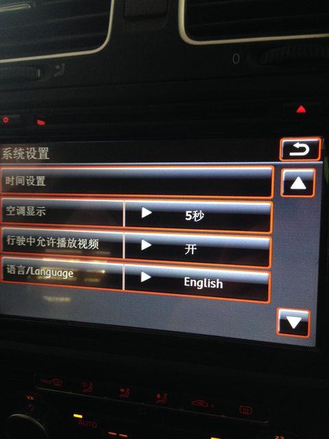

                    • So this is happening on startup using the new firmware.., takes a few reboots for it to properly boot (and when it does it's in Chinese).
                      Will have to reflash and see if that fixes it. It took ages to flash the first time (like 30mins), restarted the flash, figure that may be why it's being funny.
                      MY10 Golf Mk6 103TDI DSG Candy White | Revo Stage 1 ECU Tune | 18" Talladegas | GTI Front/Rear/Exhaust | R LED Taillights | GTI Steering Wheel | VW Discover Media | Focal IFVW Front Speakers | Mk7 Climatronic Panel |
                      • Hmmm... might have to hold off this one for now. Except for the few known faults mines working well at the moment and I don't want to break it!
                        • So reflashing fixed the white screen, but now every time I boot up it's in chinese, no matter how many times I change the language back to english.
                          This is what happens.
                          Boot up, everything is in chinese, go to change language and english is still selected. Only way to get it back to english is to change to a different language, then change back to English, and everything goes back to normal.
                          Funky bug going on :|
