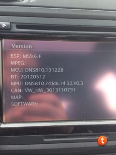

Sandy this is what I have from latest bsp and mpu. I did not update the mcu as you said. Is this right?
So far I have lost the "loudness" as I turn on and off and no difference. If I change the bass or treble you have to turn volume up or down once for that new setting to take affect. Same for eq presets.

The EQ issues could be related to the MCU not updating with the rest of the software. In short BSP contains the WinCE image, MCU contains drivers and MPU contains the software elements. Updating BSP and MPU means you updated the WinCE OS and software but have not updated drivers - which is usually not a problem unless the latest MPU update relies on an updated driver.
