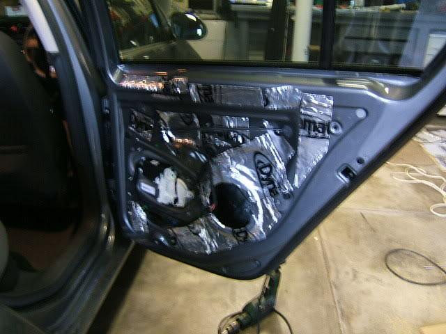

    Dynamat city, with emphasis on the fronts and sub, as these are amp driven... incidently the sound deadener sheet on the passenger rear had fallen off and was a dried crumpled heap in the bottom of the door.
    • #62
      Ha it's Boston city, good to see ha.
      With Dynamat it usually works better in large sheets. Leave it whole and cut around what you don't need.

        I hear you on the dynamat, the rears are running from the deck and will get the massive 18 watts RMS the 9887 pumps out. Add to that they'll be spared the bass via the deck, I don't expect a lot of resonance from the rear doors.
        Fronts are a different matter, and I have a lot of dynamat left just for the front doors, and the boot panels once I get it working. The front Pro's, will get 187 rms watts from the Soundstream, as they are 3 ohm. I expect a lot more resonance there! Any advice where you'd crossover the mids and sub?

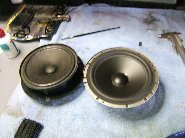

            Greg how do you find it without the mid range drivers in the front doors and the bass driver back by your thigh?
            I have a pair of Herts splits I want to chuck in but I'm wondering about this... and how much of an issue is speaker depth for the 6.5"?

                        So you put your 6.5" driver in the stocko plastic ring as well? It seems pretty decent to me with a bit of dynamat added, and it seals properly in the door card.

                          The stock plastic ring is solid enough for me, I bolted mine back in as well as silastic, and as you say a little dynamat and it's plenty good enough. That and the fact I just want to finish this install!!
