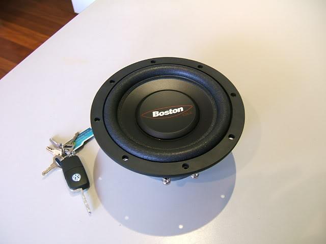

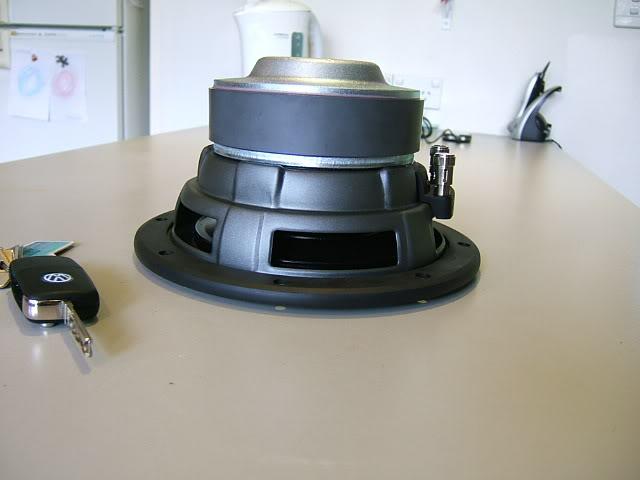

            Originally posted by glidn View Post
            dont forget to post pics of the new boston 1008.
            Speaker porn for the kiwi crew....
            • #51
              Interesting, should be good in the GT. 1.5inch excursion might rattle some trim

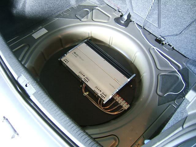

                I have swapped the spare wheel for a can of tyre repair / inflator and have cheapy 12v compressor to carry as well. I'm going to start on the spare wheel / amp caddy tonight, and see how much I can get done over the weekend. Should be all up and running in a week or so.

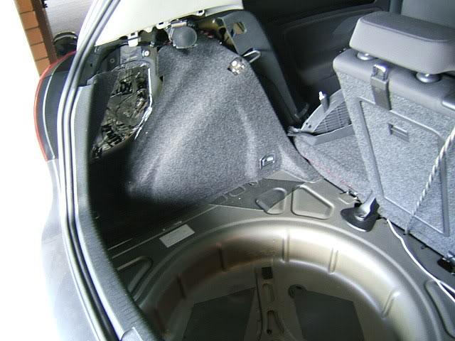

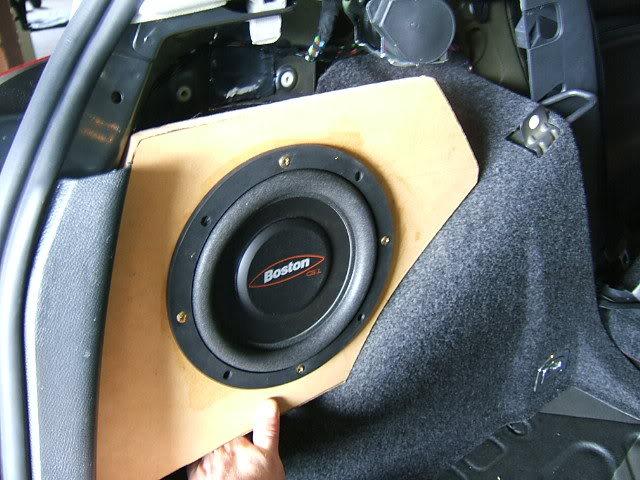

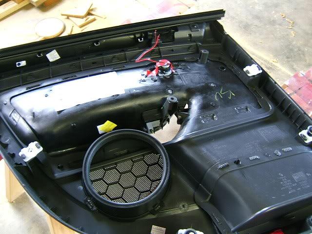

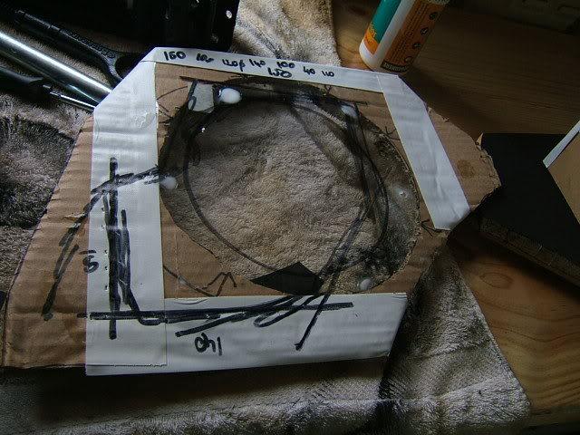

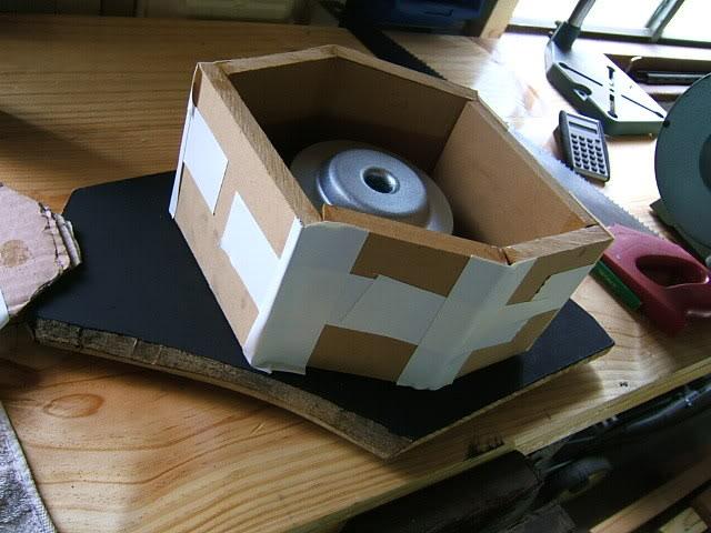

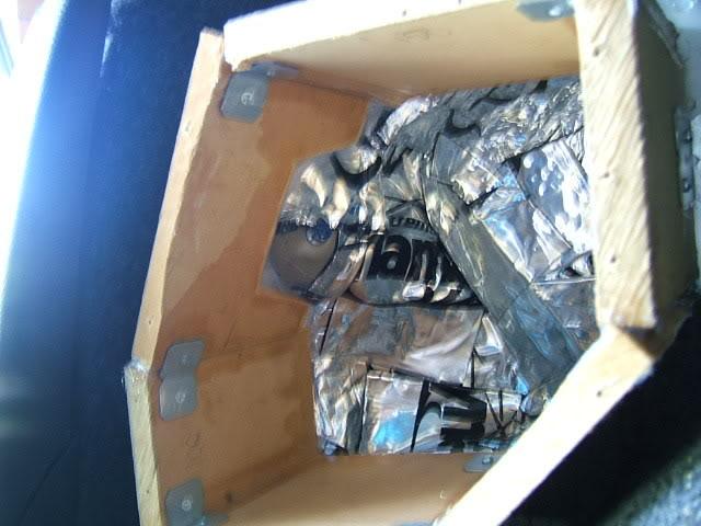

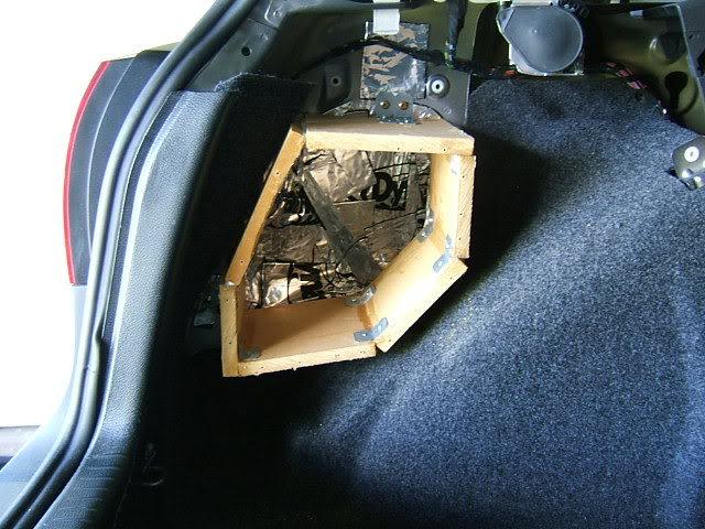

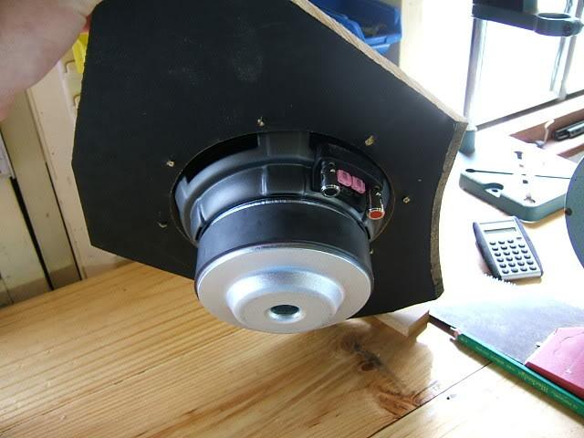

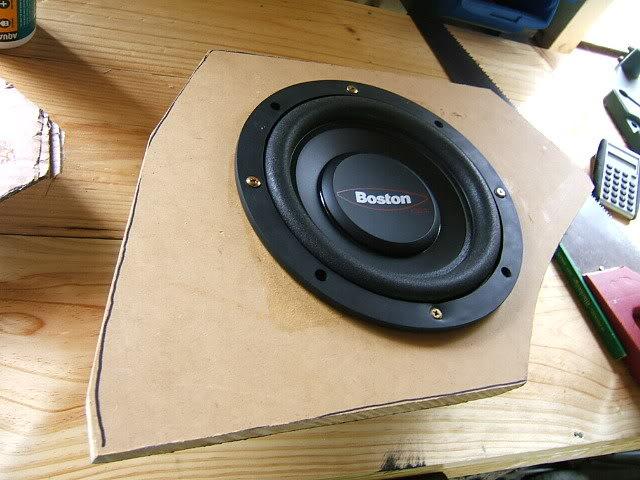

                          FINALLY, I've taken a few days off work just to finalise this. Thus far I've decided on a rear left sub mount and box idea, managed to build an approx 8L enclosure with just a little metal work, made up a amp shelf where the spare used to be, and am into the rear doors. The sub suits 8.5L so I'll look at adding a bit extra today. Despite the poor corners in my "box", once it was fully glued, siliconed and dynamatted, it's a rather sturdy setup. I had to bend it a bit from the initial nice "bench setup! I'd like to take the time to make it beautiful, but so long as it's tight and sealed, and works, well I simply don't have the time!
                          I decided to leave the lower section below the sub, as this is where the air vent from the boot to the outside is, and I've run into trouble with the flap setup before, where it flapped in time with the sub and it sounded just terrible. Hopefully by isolating the box, the effect will be minimised, plus I'd like to make a second pocket for tools etc.
                          Here's the library this far:

                            Corners look worse than they ended up...

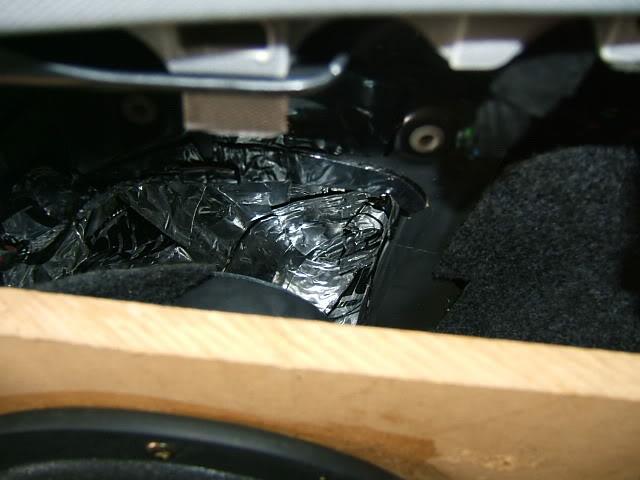

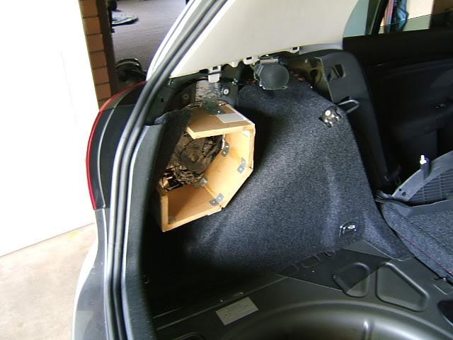

                              Had to get creative with the section around the tail light - hope the bulbs don't blow for a while!!
                              plenty of clearance behind the sub:

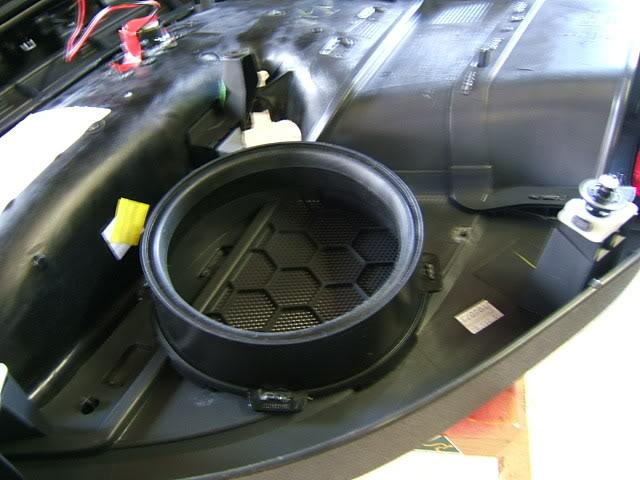

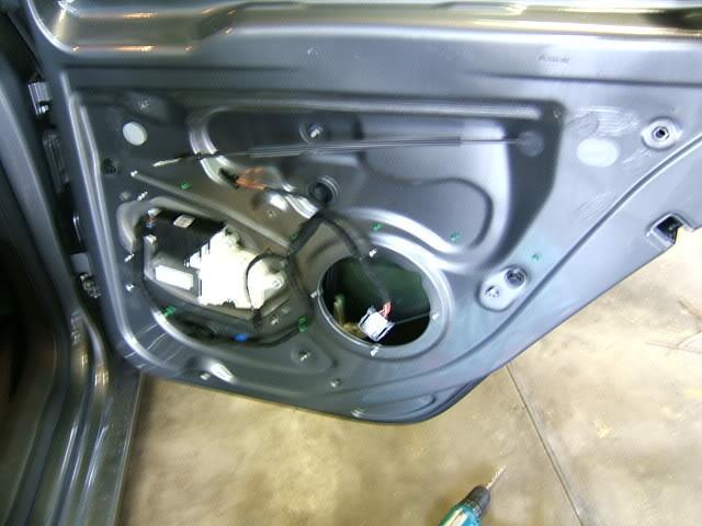

                              • #60

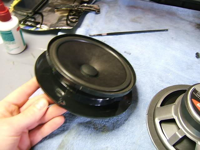

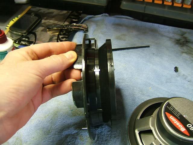

                                31mm spacer on the drivers in the rear doors:
