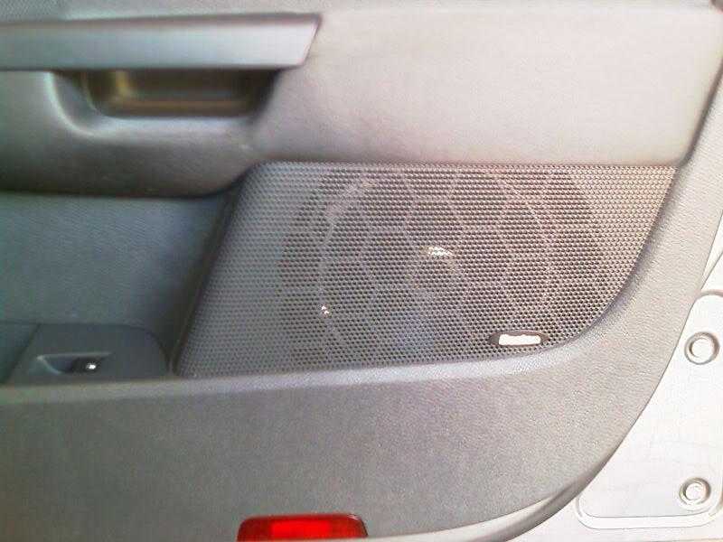

      Originally posted by cogdoc View Post
      Well it's all done, and in, and all I can say is WOW. The teewts in the A pillar, on zero db gives a nice high, slightly up front sound stage, even without time alignment. Leave em where they are Benno!
      hmm interesting. I find it kinda low... would love to get it a bit higher. I'll wait until I have them amplified before I do anything though.

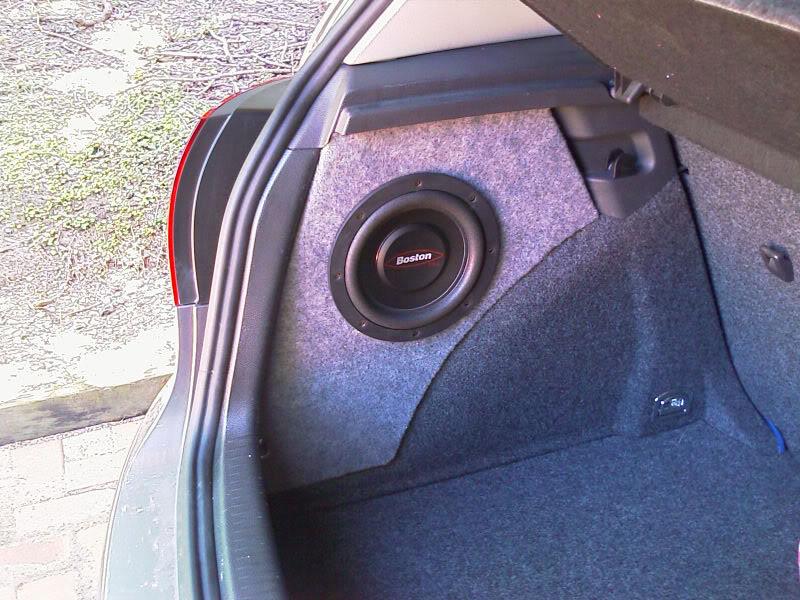

      • #78
        The problem is the volume you have to work with. I reckon you *could* get away with a 10", but I built a box as you can see earlier in this thread, and it came out to 8 litres eggsactly. The G1008 was purchased because it recommends an 8.5L enclosure, so I actually added a 500mL tupperware container and siliconed it over a hole in my box, then covered the heck out of it all with dynamat. I measured my volume with water in garbage bags, and it comes out to as close to 8.5L as I can measure. And yes I went to a lot of trouble to remove bubbles etc!!
        The bottom line is the sound is great, and I'm confident I have my sub in an optimal enclosure, at least via the specs. You need a fairly shallow sub to fit the space, forget a big magnet jobbie. I had to remove metal and it was pretty tight with what I did, a 10inch would have to be a rather precise install.
        That said Jaycar have a superb 10" woofer, last year anyway, and I put one in a 25L vented box in a Lancer I bought cheap of a girlie, and resold, and the bass response was a selling factor! Sounded great, off a basic Jaycar amp. Sure it's basic stuff, but with careful selection and a good install, it can sound bloody amazing.
        Sub was a CS2366 and was $140. Discontinued about a year back, but for the money I reckon it'd be hard to beat. Thing is I'm unsure the exact volume if you sealed the entire area where my lighter grey face is. but if I was on a budget, I'd be looking at these sort of options!

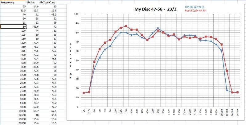

        • #79
          My first results with "my disc" and jaycars cheapie DBL meter...

              So forgive my ignorance...
              You're using a test disc and a Jaycar meter to get those figures? Cool.
              Where's your crossover point set at? Bit of a dip there at 400hz.
              "One art please!" --->http://benno.redbubble.com
              • #82
                Yep, "my disc" from Sheffield labs, and Jaycars baby $50 db meter. Works fine!
                Sub is currently 100hz down, and rears 125 and up, fronts 100hz up ( i think from memory..). I'm amazed the little 8" is performing down around 40hz, you can really see the "lump" the hawkins bass boost in my amp produces.
                The whole aim is to see where it's high and low, smooth out the curve with the crossover / Eq and then tune by ear from there. Interesting to note the much better sounding "rock" eq curve doesn't do squat for my 400 hz low point huh. All very interesting, and more late nights tweaking to come. These things let you see where the cross, bass boost and EQ really are needed.
                It's very cool to be able to really see what's going on, and I've never gone to this level of trouble before.
                DB meter and test disc available to local dubbers of course, but you'd better bring a pizza, or your hot sister.

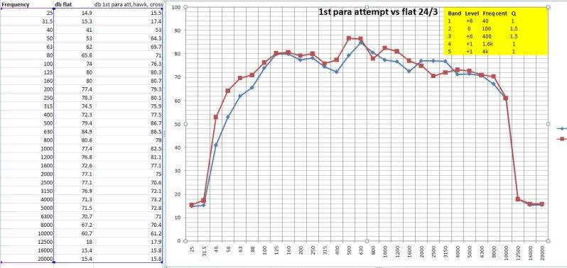

                • #83
                  Well my first parametric attempt isn't so crash hot..... and it doesn't sound that good either! Much to learn about this alpine parametric eq, and it even has adjustable centre freq, which adds to the intrigue / making me look stupid... flat in blue vs "attempt 1" in red. I also changed the crossover, and all the door mids are 125Hz and up, with the sub 100Hz and down. Too many options!!

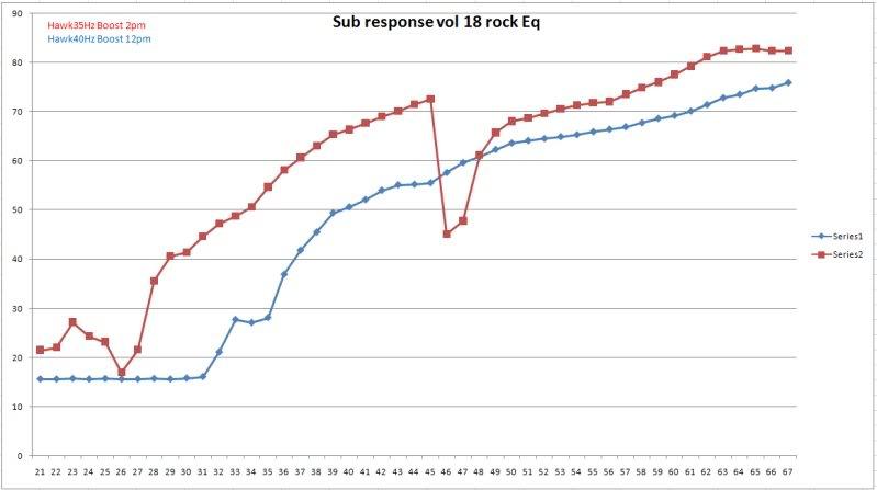

                  • #84
                    Seems I'm just as crash hot tweaking the sub below the Bostom recommended boost range at 39Hz. red is tonights attempt at approx 35 and a bit more boost, 2pm over 12pm position. Too much! What a weird valley at 45 odd! Amazingly the little sub is trying to do something now, down towards 20, probably distortion!
