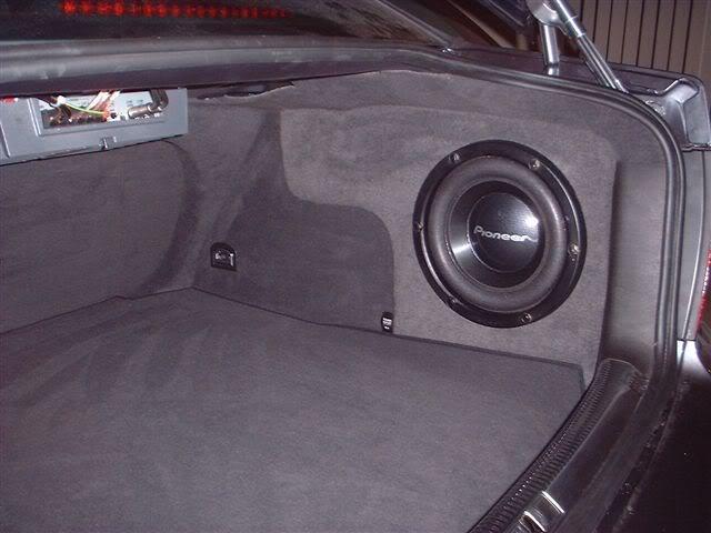

                    For what is worth, this is what i did for a guy in his Bora.

                      Awesome info guys, and Glidn that's exactly where my thoughts are going. Nice install! Just keen to get the volume correct, obviously easier in a regular box. Have to somehow try to tie in the radiator if i go G5, just cause you can!
                      I agree overkill with dynamat is unecessary ( for my needs anyway... ), and other parts are coming out, so the weight gain won't be too great. I have a large box full of "extra" bits out of the car already. As for "sporty", I'm planning on tweaking more than just the stereo. Visited my friendly APR guy today to get some ideas.... : )

                        Won't rule it out, as it would certainly be light, and that is always a plus for the twisty stuff. I'd guess it'd be a lot shallower too, easier to fit in glidn's pic example above. Cheaper too, let me get other goodies quicker!

                            Haha, yeah i like the RE8 more for the Fact that it not only goes insanely loud without all that much power. And secondly it requires the least space for a sealed enclosure that i came across against anything else.
                            I'm currently running 2xRE8 at around 500 - 700WRMS. And they are doing a remarkable job.
                            I use to run a single RE12, only at a mere 300wrms, and i actually took it out of the car about 3 days later. IT was way to much, it just had way to much kick but it too blended nicely, was not sloppy and all that. But LOUD SQ or stupidly LOUD SPL, it did a great job. But again i need the space in my car.
                            Hence the RE8 fit the bill in all catagories. Small Sub, Small box, does not need massive power, loud output and it does not cost all that much.

                              Ahh, so THAT's what that strap thing is in the boot, a first aid holder. Couldn't work it out! That'd be the side, for it's opposite me for weight distribution as well.
                              Great ideas, and Glidn, you're right about the depth of the bigger speakers. I'll do some measuring and cardboard mockups, and get serious about the space I can afford, THEN find the sub to suit. Otherwise it's just piss!ng in the wind...
                              • #30
                                OK, I've played with the tape measure and putting in even a shallow 10" would be a mission to keep it nice and level with the wheel arch. I'm even wondering where the heck to put the amp I have! Space is the major factor for me, I may dream of a 12" in a box, but I know it will spend a lot of time out of the car, which defeats the purpose.
                                Seems the left side would give a "box" volume around 10-13 litres if I do a bit of metal work for the magnet.That RE8 is starting to look pretty good.
