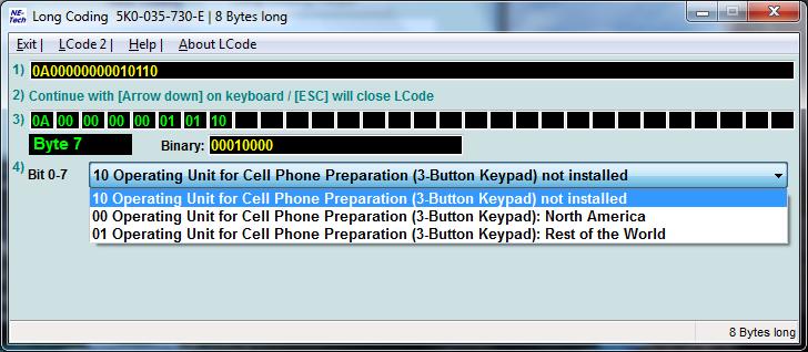

What s the go with the all the VCDS error messages the module throws. Is there some coding I can do to stop them or do I just live with them.
Address 77: Telephone Labels: 7P6-035-730.clb
4 Faults Found:
9458195 - Control Module for Cellular Telephone
B1052 13 [009] - Open Circuit
Confirmed - Tested Since Memory Clear
13636352 - Control Module Not Coded
U1013 00 [009] - -
9457937 - Telephone baseplate
B1051 11 [009] - Short to Ground
9458449 - Cellular Antenna
B1053 11 [009] - Short to Ground
Confirmed - Tested Since Memory ClearGolf Mk6 118 TSI DSG |APR Stage I ECU Upgrade | HEX-USB+CAN

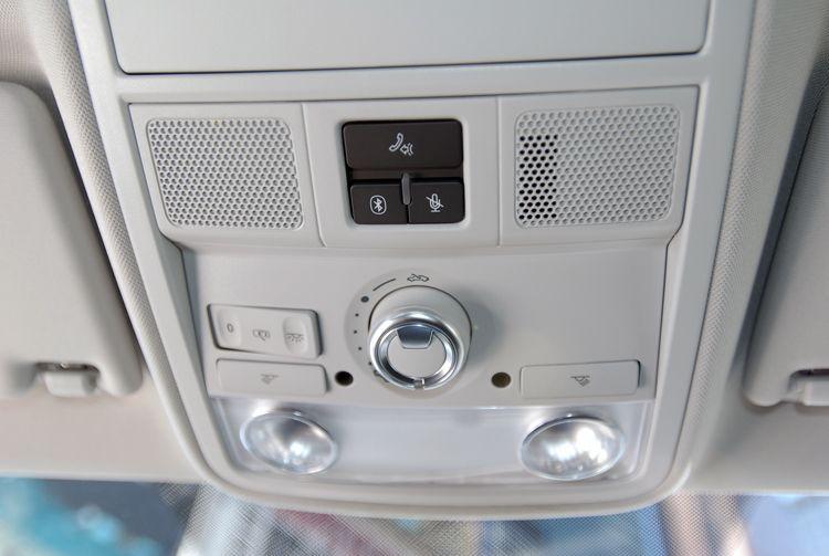

Try setting this to 'Not Installed' - refers to the phone shortcut buttons on the roof that you wouldn't have:
Thanks that fixed it. Even though practically the unit was working fine - in the coding screen VCDS recognised the module had not been initialised and offered to do so with default coding. so I let it do that.
Then I recoded Byte 7 as you suggested as not buttons fitted. Then Byte 6 as no baseplate fitted so no diagnostics for it required. Finally Byte 5 to make Antenna diagnostic inactive as not fitted either. All good now, with no faults. Thanks heaps.Golf Mk6 118 TSI DSG |APR Stage I ECU Upgrade | HEX-USB+CAN
