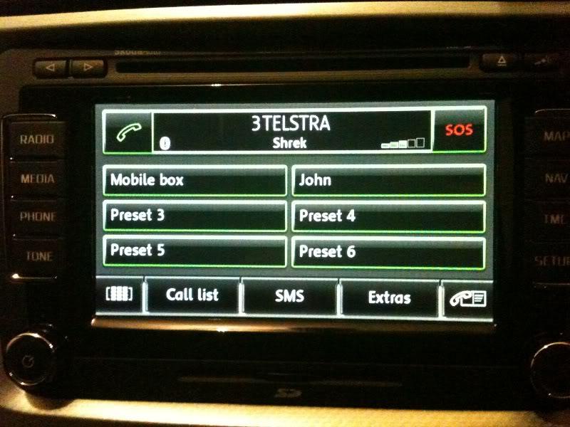

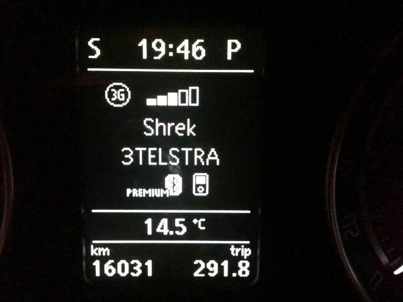

Yes they are trivial and it is hardly worth the effort. But I like a challenge and I a know there are others who keenly want a fix. You don't have a copy of your pre upgrade phone module coding in an old scan do you?Golf Mk6 118 TSI DSG |APR Stage I ECU Upgrade | HEX-USB+CAN
The car never came with bluetooth -I retrofitted 9W3 (which didn't have the icons), then swapped with a 9W7, then swapped again for a newer 9W7 when diagnosing issues with my new phone. At no point have I had those icons.
Stock bluetooth in MY12 Golf R with RNS510:
Address 77: Telephone (J412) Labels: 7P6-035-730.clb
Part No SW: 7P6 035 730 E HW: 7P6 035 730 E
Component: TELEFON H09 2730
Revision: 1B001001 Serial number: 0000766064xxxx
Coding: 0A01000000010101
Shop #: WSC 01357 011 00200
ASAM Dataset: EV_UHVNA A01015
ROD: EV_UHVNA_VW36.rod---
Manual MY12 RB Golf R | Bluefin Stg2 | Milltek turbo-back
Thanks for that tonymy01. I checked the differences between our coding and there is nothing untoward in it. Your language is North American mine is English. You have voice operation inacative, so I set mine the same. You have the three button keypad, I do not. That's about it.Originally posted by tonymy01 View PostStock bluetooth in MY12 Golf R with RNS510:
I did notice measuring block "009 status of phone" on mine is perennially Unknown.
Next time you hook up your VCDS could you PLS take a peek and see if that block is populated in yours? I thought perhaps this block might display a % on yours like the telephone field strength is correctly doing. OTOH it may just be offhook/onhook indication.Golf Mk6 118 TSI DSG |APR Stage I ECU Upgrade | HEX-USB+CAN
