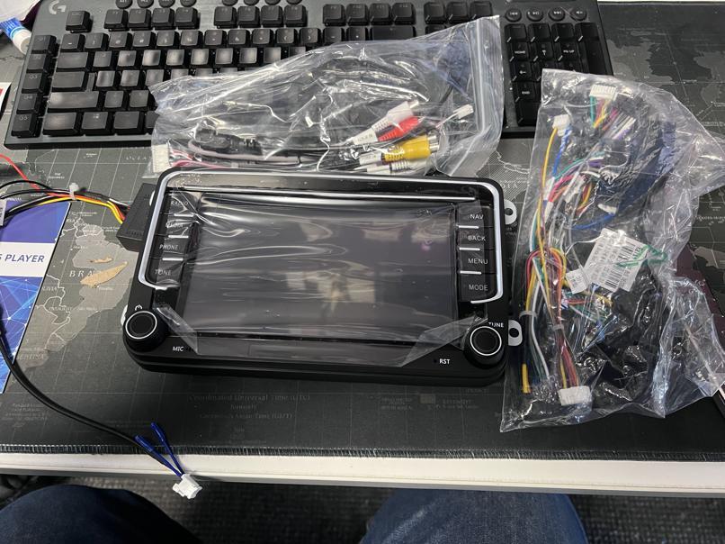

    It's here!
    The box is surprisingly small:
    But nicely packed:

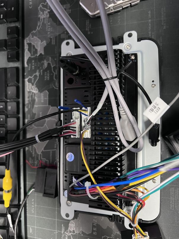

    A collection of wires:
    Note that there is two sets of wiring, one for other cars and the quad lock set. You only need the quad lock wires.
    Everything just plugs into the hole it fits into:
    The instructions leave a little to be desired, but the guys from Maxca have been very very awesome and responsive in answering questions. In fact they proactively followed up with me asking if I needed any help. It really is 100% plug and play for the headunit itself including the steering wheel controls.
    I'd say installation is 30 - 60 minutes, possibly much less if you've ever done a head unit before. It really is an awesome piece of kit and a very easy install. Did I mention you need to splice zero wires for the head unit?! The RVC adaptor requires three splices, but these are into the new wiring harness so are very easy to do on the bench before you approach the car. *** I'll have to post photos of this part later ***
    The installation itself is very very simple. Carefully pop the frame around the old headunit, unscrew the four T20 screws being careful not to drop them down inside the dash.

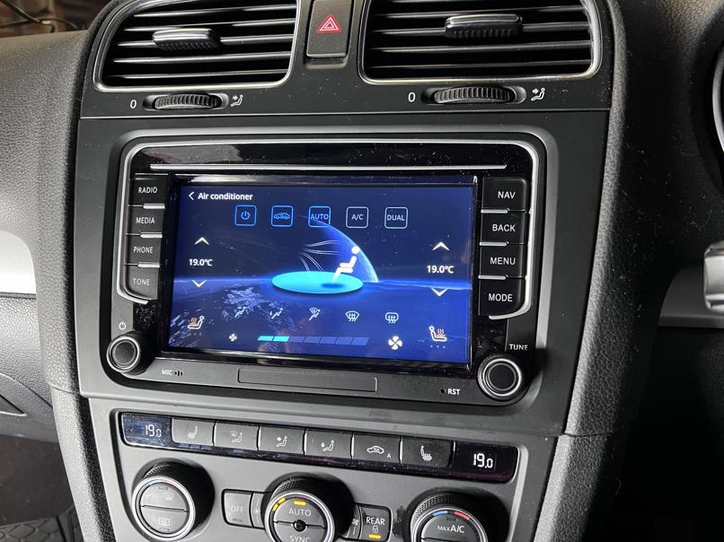

    This is it in place and showing what happens when you use the AC controls. A really nifty screen (and much faster than the RNS510 was at showing this info. It looks like you should be able to touch these to do stuff (because we are all conditioned that way now), but a reminder it's just a courtesy display so don't be disappointed when it doesn't turn the heated seats on when you try to touch the screen

    As I said above, it connects to the CANBUS and shows AC controls on things on screen too! It's actually very cool.

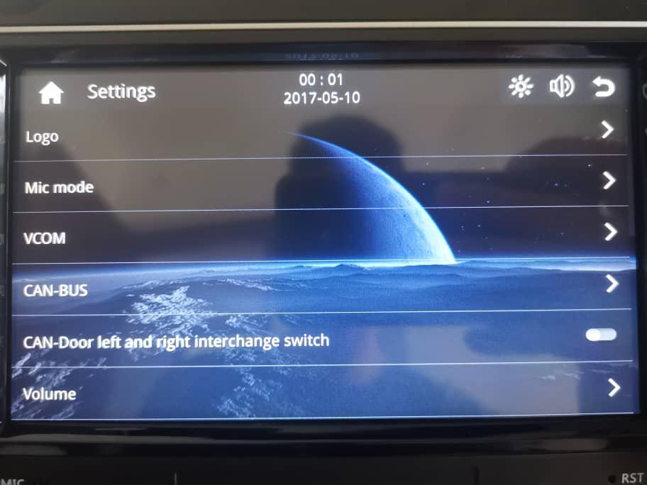

    You go into settings--factory--123456--settings--touch calibration
    It's a bit fiddly and took a few attempts before it was happy with my fat fingers poking at the spots, but it appears to be much better now.
    While you're in the factory section you also want to switch the "CAN-Door Left and Right interchange switch" so the graphic shows the left and right open door warnings correctly.

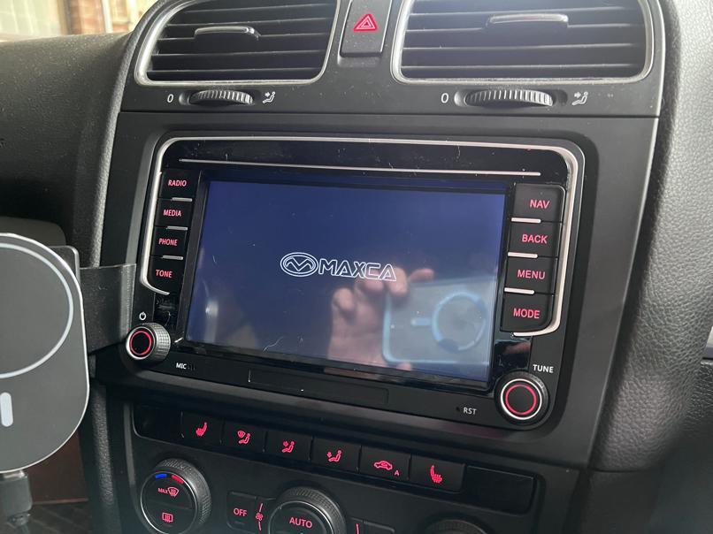

    There is another section in here called Logo where you can change the stock logo from this:
    To a whole range of things including Skoda (two versions), Audi and VW:
    Which ends up like this:

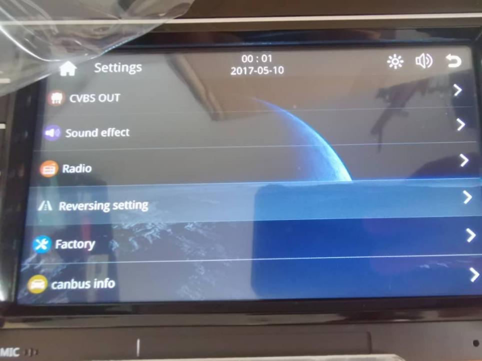

                  In Reversing:
                  While you are there you might as well turn off 'Reversing Mute" too unless you want all sound to cut out when you enter reverse (I don't).
