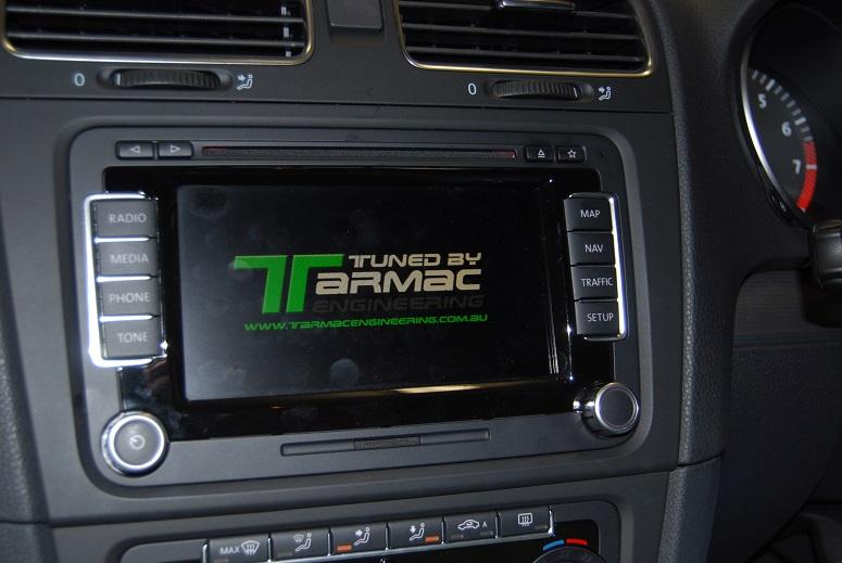

          Water/Meth Injection Setup for Golf
          Lol that is cool did you get into the head unit and put your own image in?
          YAY I got my R!!!! White, recaro seats, 19" wheels, bluetooth, reverse camera
                He has the CD so be careful he doesn't put it in your car when your not looking,
                        Haha go for it wouldn't worry me

                          Tarmac boot screen FTW
