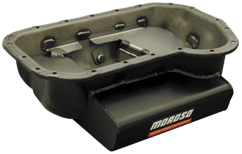

Got the sump painted today..
And I also cut out a template to make a couple of sump baffles.
I'm going to attach them to the windage tray. They will have about 10mm clearance to the bottom of the sump and will help trap the oil around the pickup, to stop it sloshing around.
More to come..
