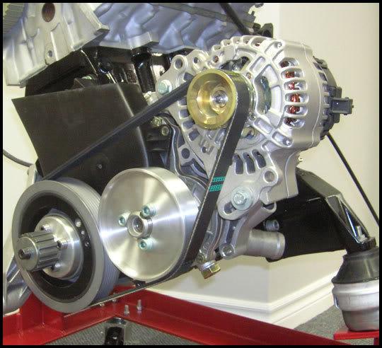

Looking good bro, who's is doing your diff for you?? (gotta get mine sorted)Are you running the factory serpentine alternator mount self adjusting one how's clearance to you carbs/trumpets
Cool, you headed down the INA path? He's got all sorts of useful bits.
That mounting position gets close to the front cross member, you might need to do some clearancing of the panel.

Where did you get the pulleys from preen, I am about to start making some but if they can be bought rather cheaply then i'm in

I've been in contact with Issam from INA about his ABF alt. kit. Mechanical adjustment, nice and low, neat etc. Price is good too. As soon as he tells me when he can ship i'll be paying him and it will be on it's way.
The pic isn't my engine, it's off this thread, where you will find all the details on this setup..
VWVortex.com - *** ABF Adjustable alternator set -up - CHEAPER THAN EVER - $319US SHIPPED! ***
