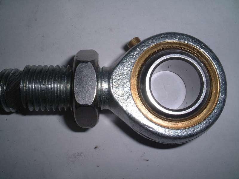

 Also going to look at making a rose joint linkage kit.

 You replace the pins and bushes with rose joints and bolts. Gets rid of the clearance.. And removes play in the shifter.
