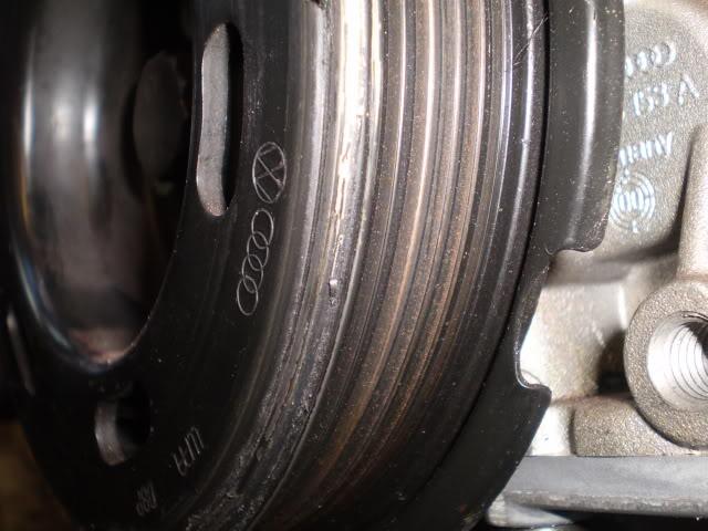

News on the engine: Well, the bloody crank pulley for the ribbed belt is buggered. Its just the outer lip which has kinda folded in from where the chassis leg bent against it slightly. Was only light contact, but enough to ruin it that the belt wont sit in it properly.
It's a pulley unique to AMK/BAM engines so not easy to source
As a last resort I called Vince at Audi Centre Perth who quoted over $300 ex Germany!!!
NO THANKS!
I'll pick it up in person while i'm there in a few weeks
Wade, just use the complete Belt setup from a Mk3, simple and easy to come by.sigpic Camden GTI Performance. VW / AUDI Specialists
Ha cool tip, but the pulley on the AMK has a rubber harmonic balancer in it, so I dont think i'll take the risk with the incorrect pulley setup.Originally posted by Golf Loon View PostWade, just use the complete Belt setup from a Mk3, simple and easy to come by.
This engine has already been thru the ringer and i'll be squeezing an extra 60bhp out of it too!
You can see the outer edge folded in here...
