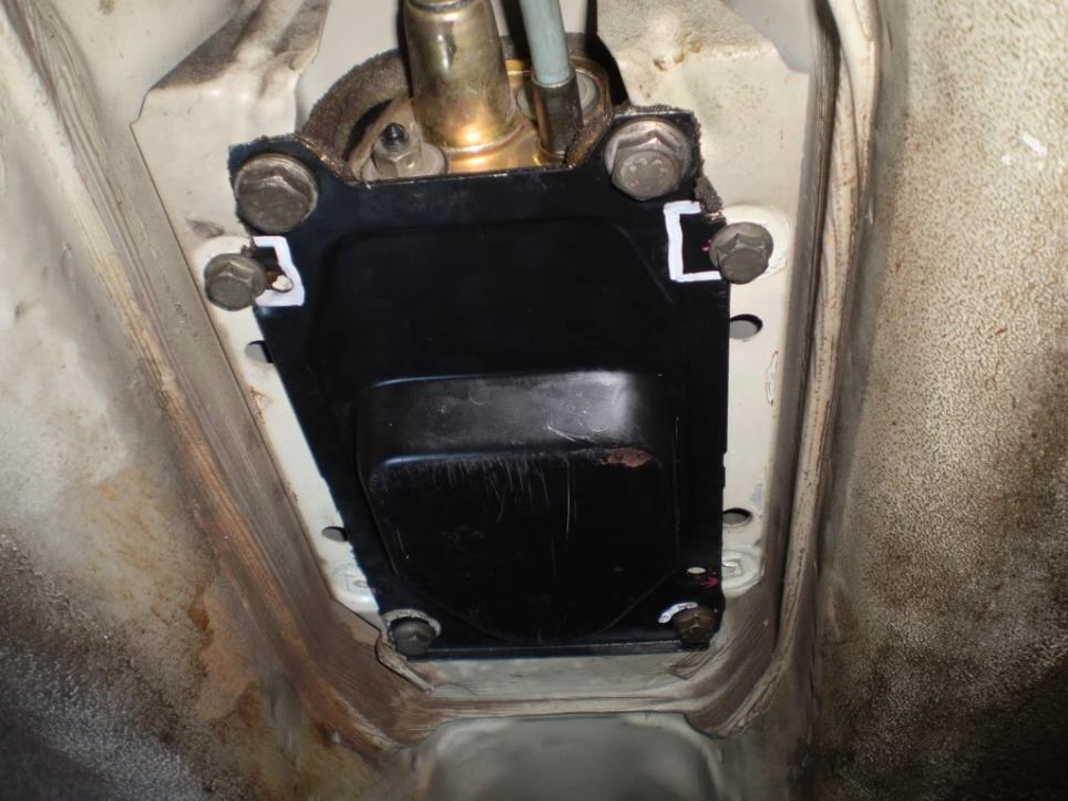

Got the shifter in. The cable shifts base is narrower and longer than the original, so I drilled some holes, used those threaded rivet things for the two rear bolt holes, and I could get a spanner in the top for the fronts so just used a locking nut on the top. Also used the existing bolt holes too as the bolt shoulder covers the edge for extra support.

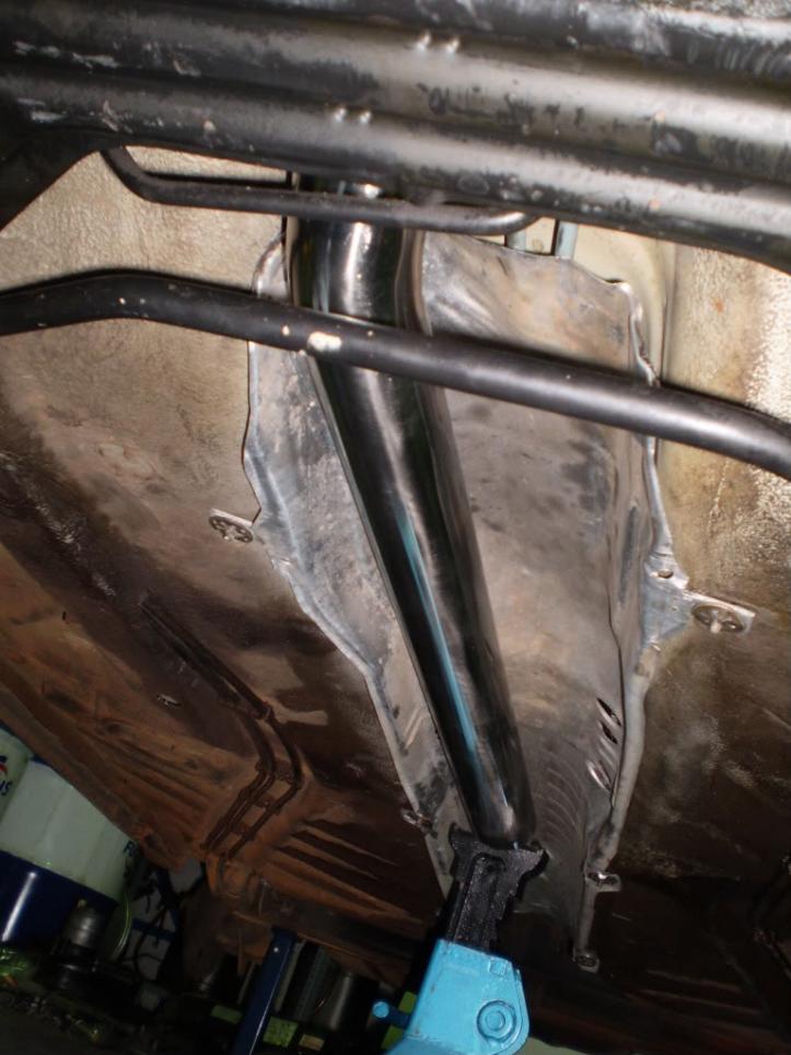

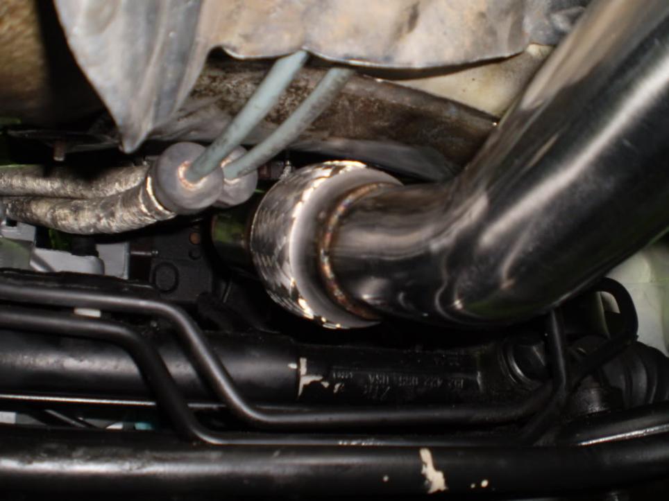

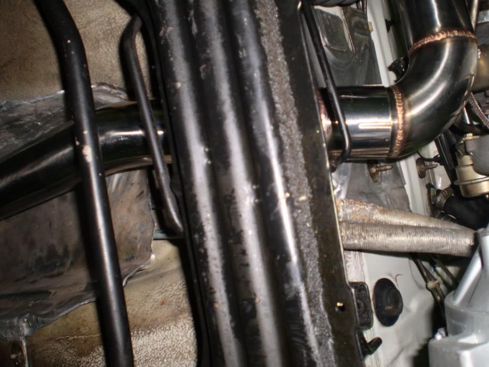

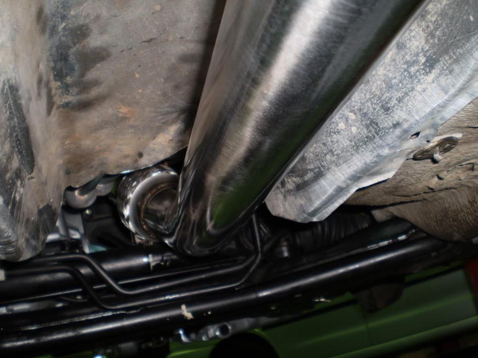

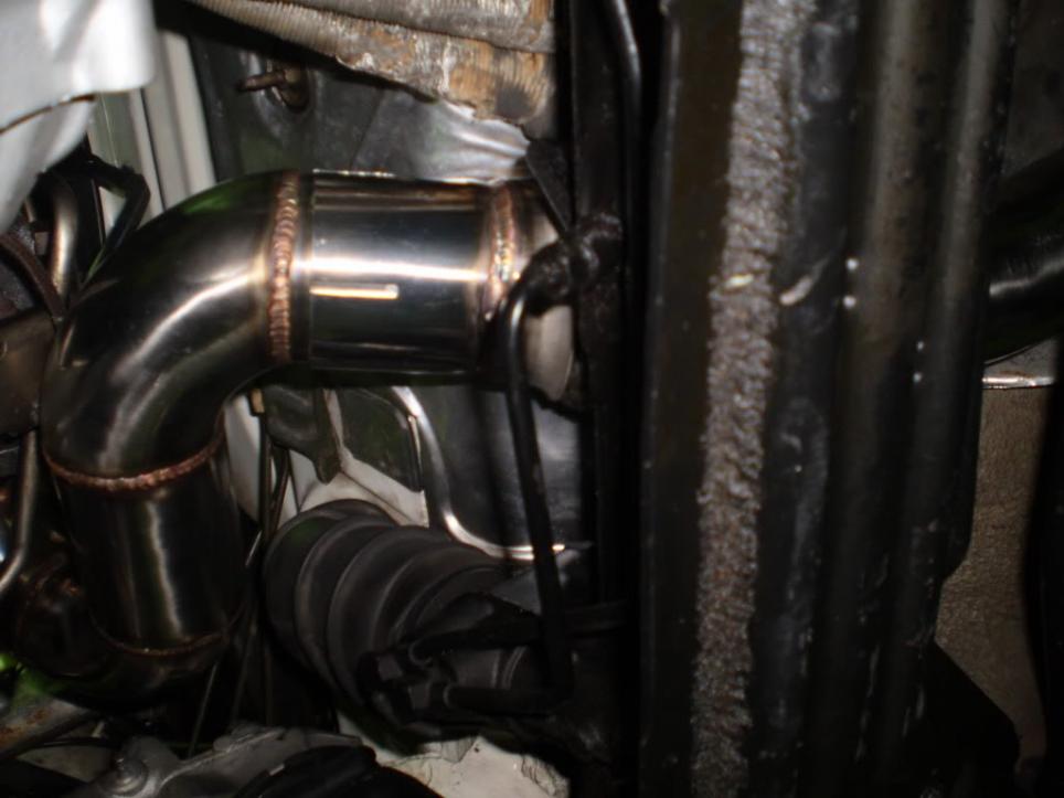

Here's a few shots test fitting the QPeng downpipe. Sexy
good work wade!
tha'ts anice looknig DP too!

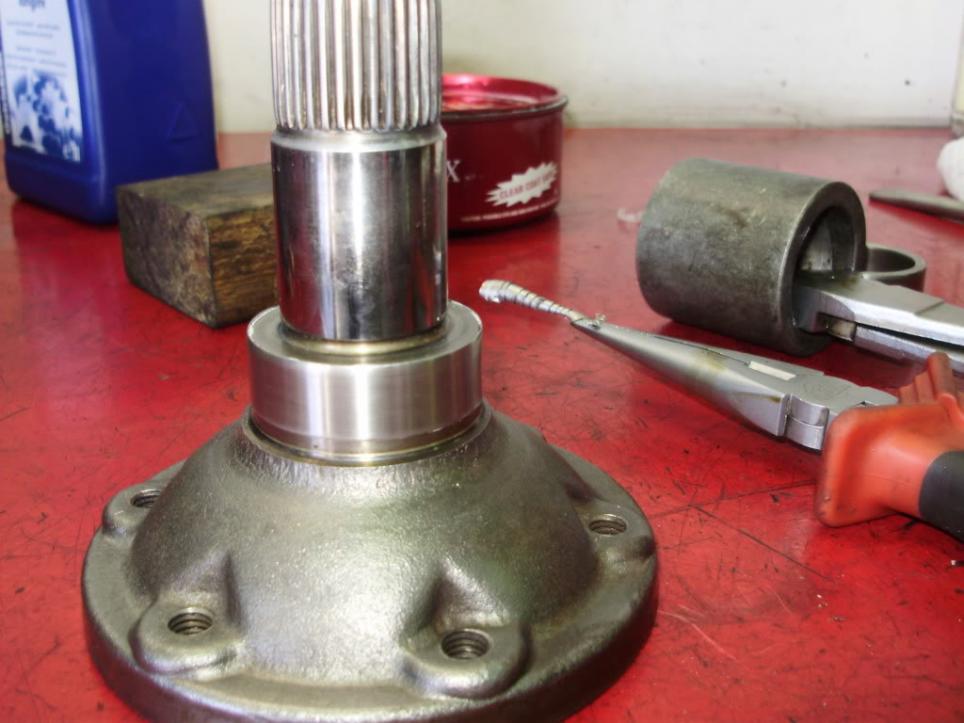

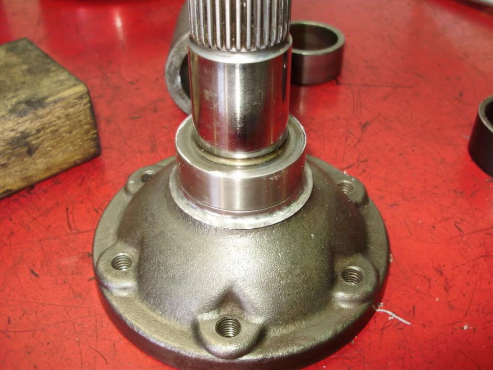

On the mk2 front, it's been a few days since I've been at the shop, but today I put a Redi-Sleeve over the corroded surface on that drive shaft flange. Cost me about $30 and is far better than $300+ for a new shaft from VW (via Germany).

Ok so here's the redi-sleeve on the drive flange.
