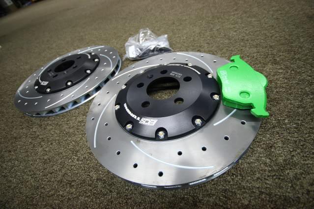

                          • 330mm ecs kit and some green stuff.
                            super pretty kit.
                            Originally posted by Preen59
