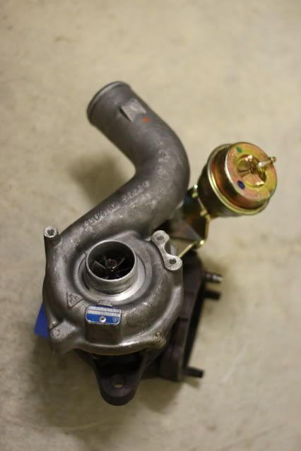

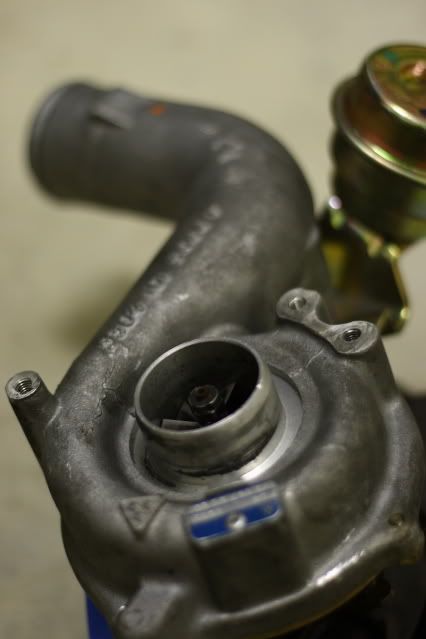

            • couldnt help myself, picked up a little bit of tuning royalty

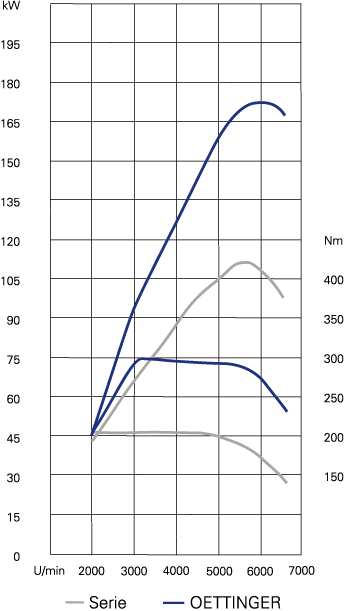

              scooped a bargain,Oettinger 230bhp k04 conversion cost $7k retail.(cant really understand how)
              230bhp kit with 360nm , have a high flow manifold on route.

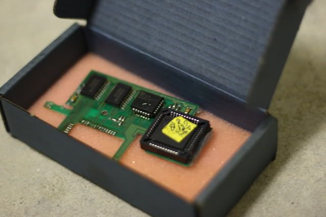

              any imput on the chip instal??soldering??
              chips

              • I'd be off to see Matt and part-ex or borrow a STD ECU until you get it all running right.
                Any instructions on the soldering? I'd be looking at getting Mark(parso-rex) on the case if I were you.
                You could shake down the turbo with the C-C ECU. Don't be driving like a fool everywhere at full throttle. 10PSI off a K04 is a great deal different to 10PSI from a K03.

                  • That encryption board looks like is meant for a different ECU from that pic. Normally they replace the PSOP 44 pin IC with a pin header and then put the appropriate board in there. I'll drag up a pic. Maybe your board attaches with a different method though
                    The chip that has to come out
                    The Chip removed
                    GIAC encryption board

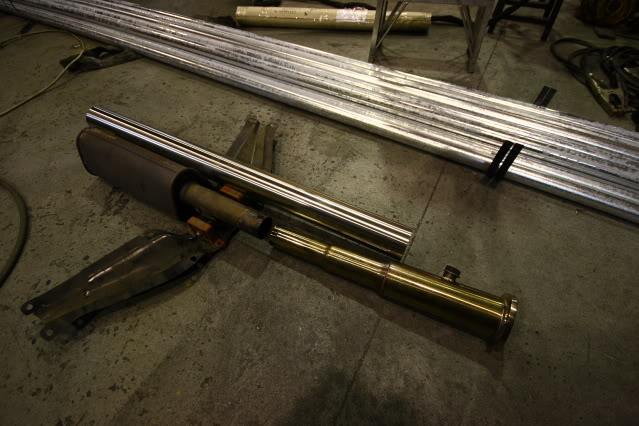

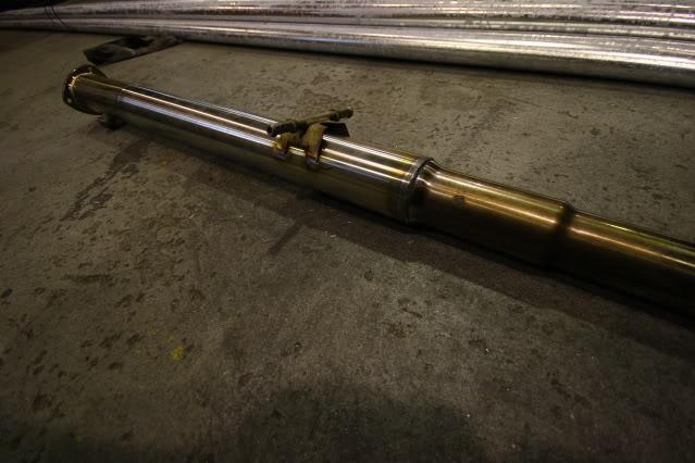

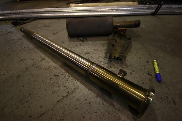

                        all this building of exhaust got me thinking,cant afford to do the hole lot at the moment but a section of 3" tube doesnt cost very much.
                        this plus that
                        hangers on
                        what res
