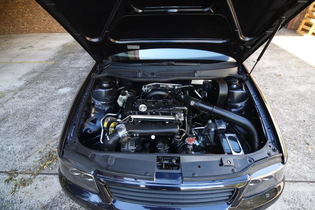

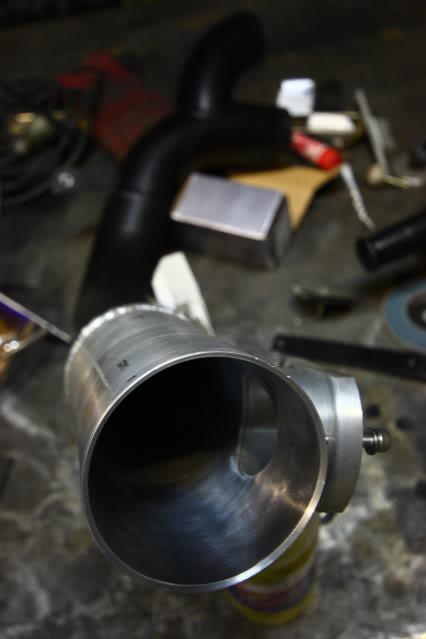

            • did a tad flaring and got some time to mount up the maf delete/conversion

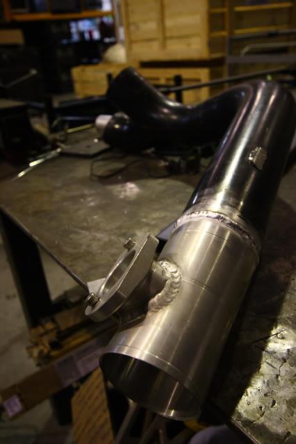

                    • One day.. I want to be able to TIG weld half that good.
                      ... One day.
                      • Was a pain welding that as the paint I use is an etch so it makes the alloy super dirty even after extensive cleaning. But turned out alright. There's just nothing like working with virgin alloy.
                        Originally posted by Preen59
                        • I'm hearing that..
                          A tip my mate told me is to go over the area you want to weld with the oxy, set on a Carburising flame. It removes impurities and deoxidizes the surface, apparently. I've never tried it. I need to get some technique downpat before i worry about extensive surface preparation!
                          • This is very true, and is a good technique, just didn't wanna risk heating the thin wall tube too much, and I was being lazy.

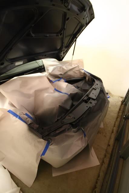

                            • gave the slam panel a birthday
