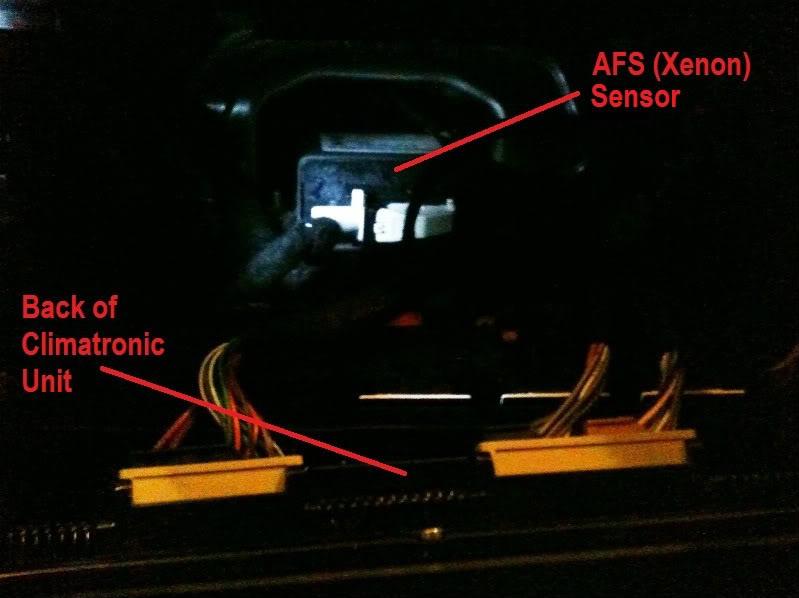

    in the octavia, the afs controller is behind the climatronic controller.
    i'm assuming the same for the superb.

      Thx Darkshadow -did you have to remove the headlight - or can it be done while on the car
        depends what the issue is. unlikely the need to remove the headlight with your issue.
        the lighting system is made up of:-
        1. head lamp with ballast (for xenon)
        2. head lamp motor/actuator (for self leveling)
        3. head lamp shutter (for bi-xenon)
        4. front self-leveling sensor (on the front passenger side suspension arm)
        5. rear self-leveling sensor (on the rear passenger side suspension arm)
        6. afs controller (located behind the climatronic controller)
        i'm assuming if anything from 2 to 5 above fails/malfunctions, then the afs controller would complain.
        then again, the afs controller could be kapput itself.
