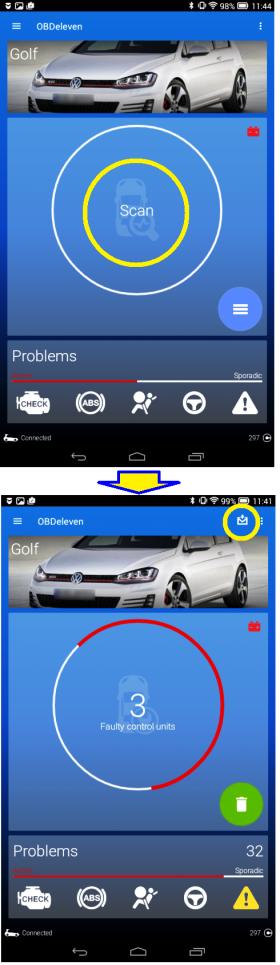

              In regard to your previous response, it is not necessary for you to take a picture of any future trouble codes. OBD11 has an inbuilt facility that allows the user to send himself/herself an electronic version of the scan report
              So, I respectfully suggest that you do the following when next scanning your car:
              1. Open the OBD11 software and press Connect
              2. Press Scan and wait for the process to complete
              3. On the "Faults" screen press the Envelope symbol (upper RHS) which should open the email app on your tablet/mobile phone
              4. Send yourself a copy of the scan results
              I've enclosed below a "visual" version of these instructions which was taken from my test-bench, which contains multiple trouble codes across nearly all the modules -hence the errors. The test-bench is an artificial environment that I use to learn about OBD networks -it is a small group of control modules wired together and running off a 12 volt regulated supply - my "virtual" Golf mk7. However, because it's not a complete car - there are numerous trouble codes (which is perfectly OK and a positive advantage for my purposes)
              Don
